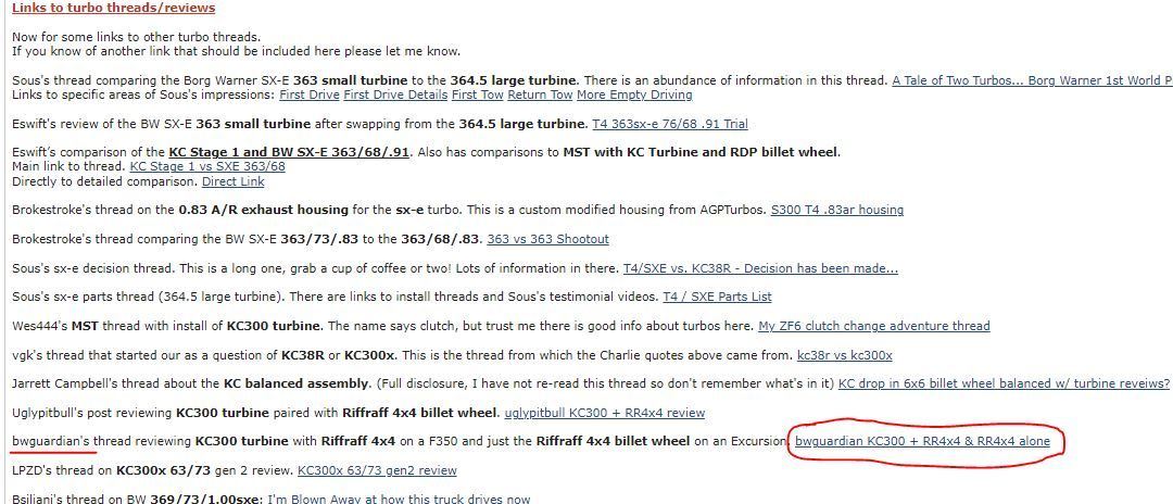

A link to your thread has been added to the Turbo Matrix post #5. See here. Turbo Matrix Links
I'll gather what I can about your rigs based on your signature and then send a PM about the remaining items for your turbo matrix entries.
Be thinking about the few sentence summary you would like to submit for each truck. There's some examples on the submission form.
To get it to fit within the matrix it has to be just cliff notes of the high points. That's why I also like to have links to these threads with the full details.
