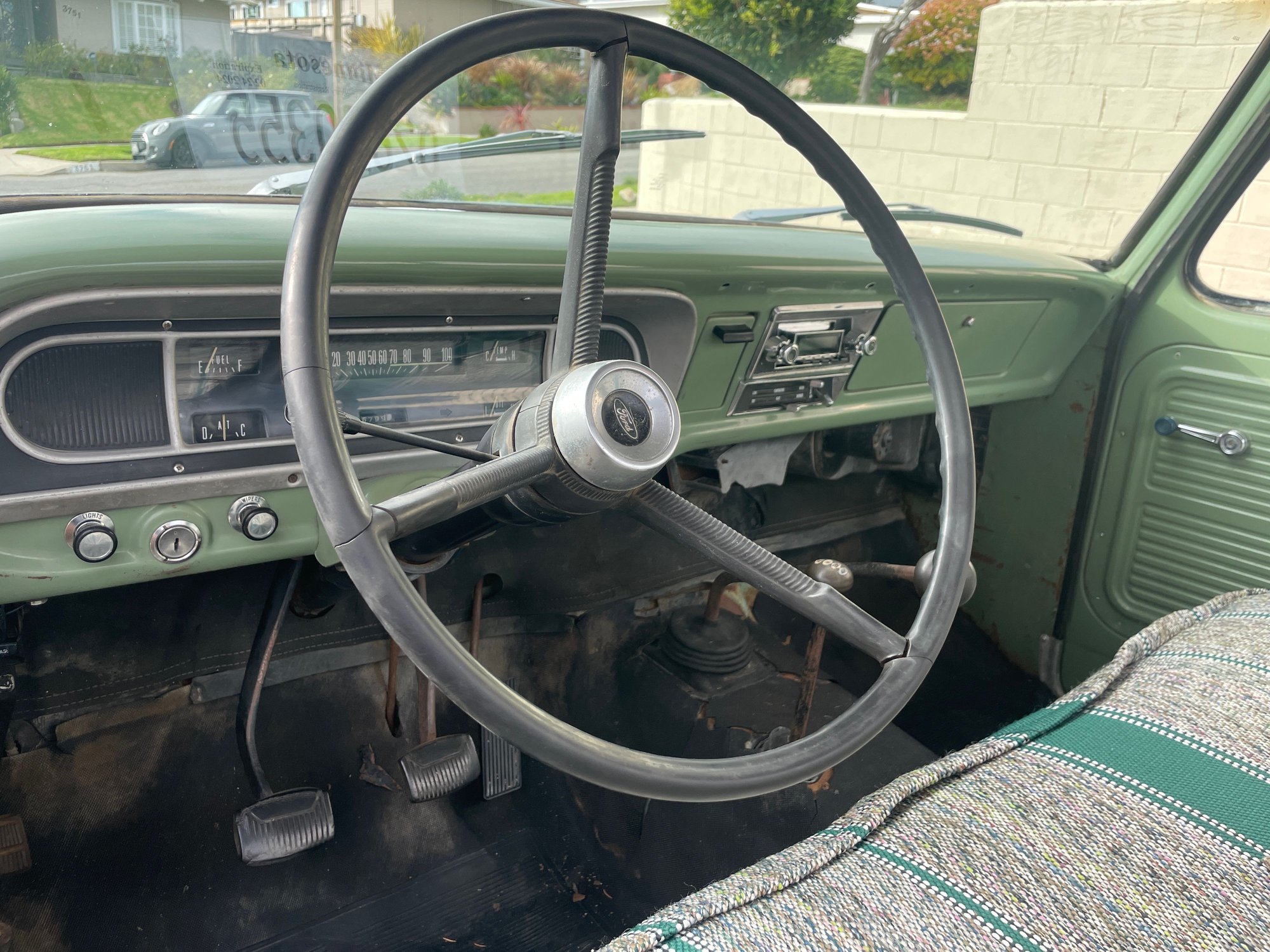

Here she is. Been just chasing all the little gremlins at this point and fixing the nuisances like the windows not rolling down, adding retro sound, remove destroyed dash pad, change windshield seals, etc.

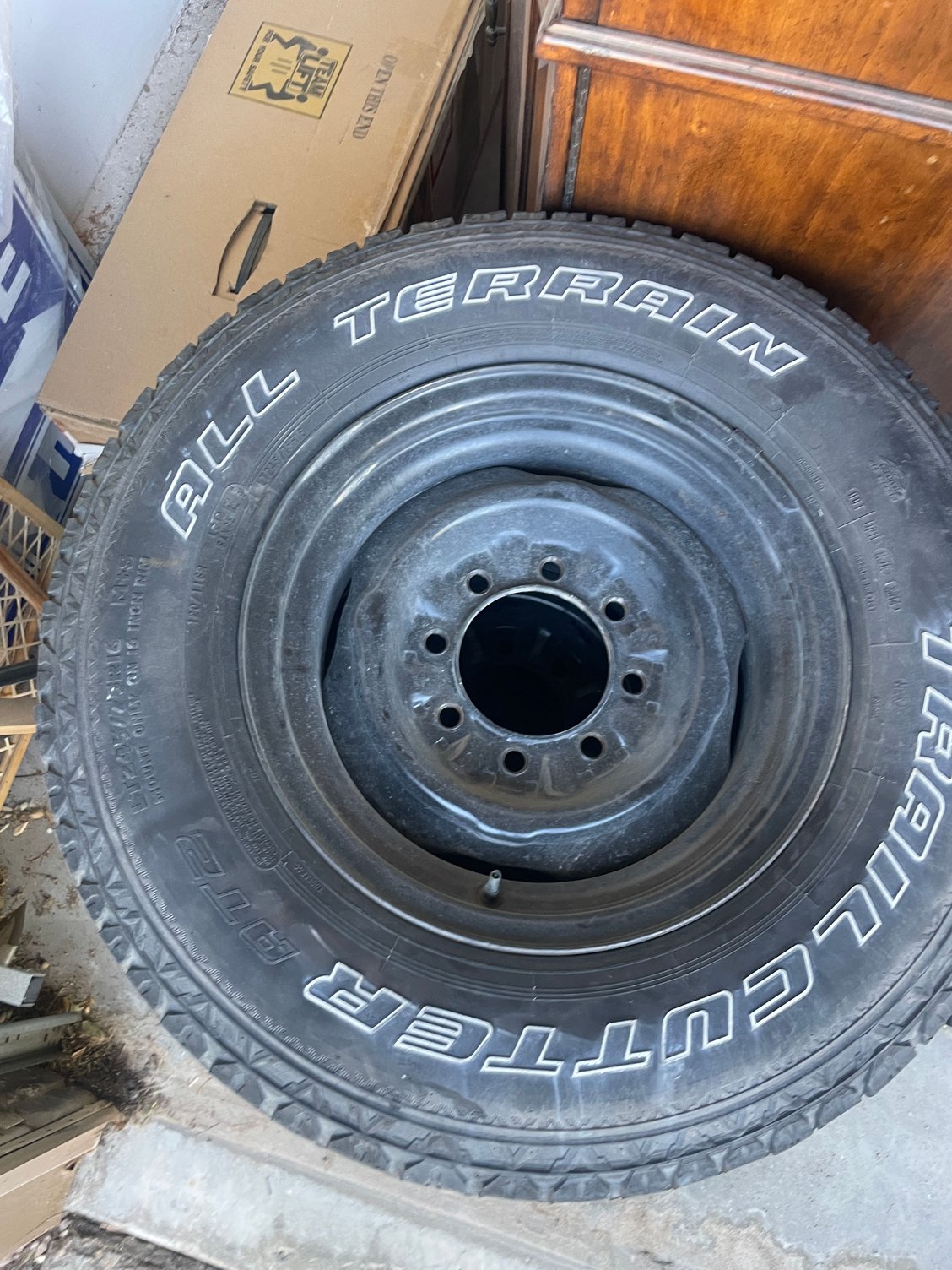

Success I found three great 16X7 wheels off a 1996 E-350 van. $30 each. Someone had already taken the last one unfortunately. They had some older vans but they had the 16X6 wheels. There is a 1999 E-350 van with 16X7s on it. Would those fit, it looked like it was still the 8X6.5 found on these wheels I got. Wound up finding a mint drivers side door latch off an 1970 f-250 tow truck they had too so overall a great day. Excited to have a door I can open from the inside, and getting these powdercoated in Wimbledon White.

obs steelies
16 x 7 OBS early (90's) 4 rims with rubber $100 8x6.5 they clear my dana 60 up front,,,,,but on a side note they are making them in 17 inches now,,,a little more clearance if your running that 60 up front. Period Hubcaps will fit on OBS rims
