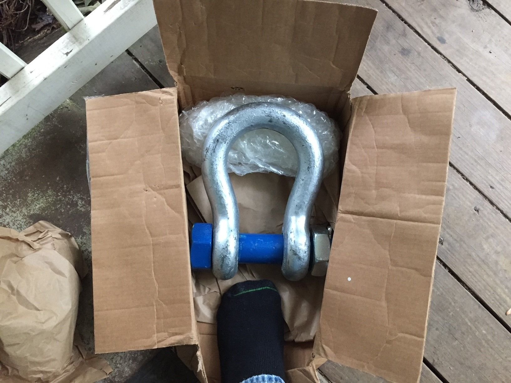

But WOW.. Lots of bad advice here. If you decide on a shackle you MUST use a "bolt" type shackle. Every other type of shackle show here on this thread is a "pin" type. Pin shackles will generally shear the threads of the pin with much lower amounts of side load compared to the bolt types. You also want a capture spring or cotter pin to protect against losing the bolt and having a POUND of metal vibrating off YOUR truck and killing somebody's kid because it's bouncing down the road at 70mph. A pin-type shackle can (and will) come loose and fall off. I went with 2 USA made CM 5/8" 4.5Ton (minimum 54,000lb breaking limit) shackles. This is what you want:

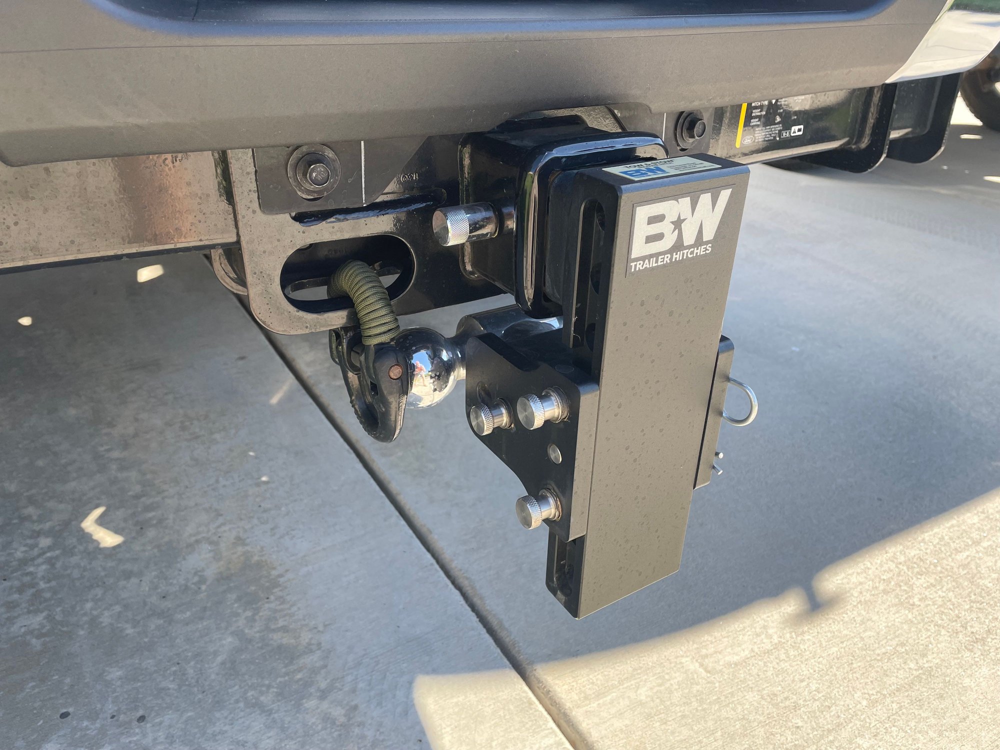

They won’t move around if you run them like this.

Originally Posted by Lockie
I prefer shackles only because I like to take them off when I know I won't be using them for an extended amount of time.
Interesting.
So a pin type is the kind that screws in; has one pin that screws to the aft side?
I run mine just like in that pic in my last post I quoted. Always figured it was rated for whatever kind of load it takes but I kinda see what you mean.
I tightened mine with pliers so A) they wouldn't come loose, and B) theft protection. Someone would have to have a set of pliers to steal them.
My other ones wouldn't fit....
