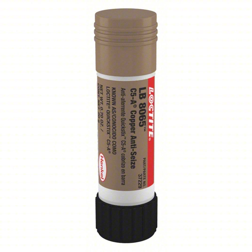

Nice and convenient, keep a stick handy with my impact sockets so it's there anytime I take off any wheels.

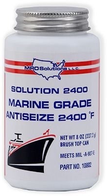

real world this works a LITTLE better marine water proof
