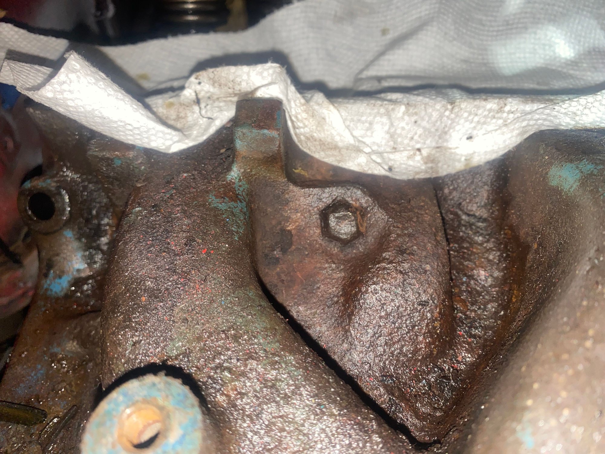

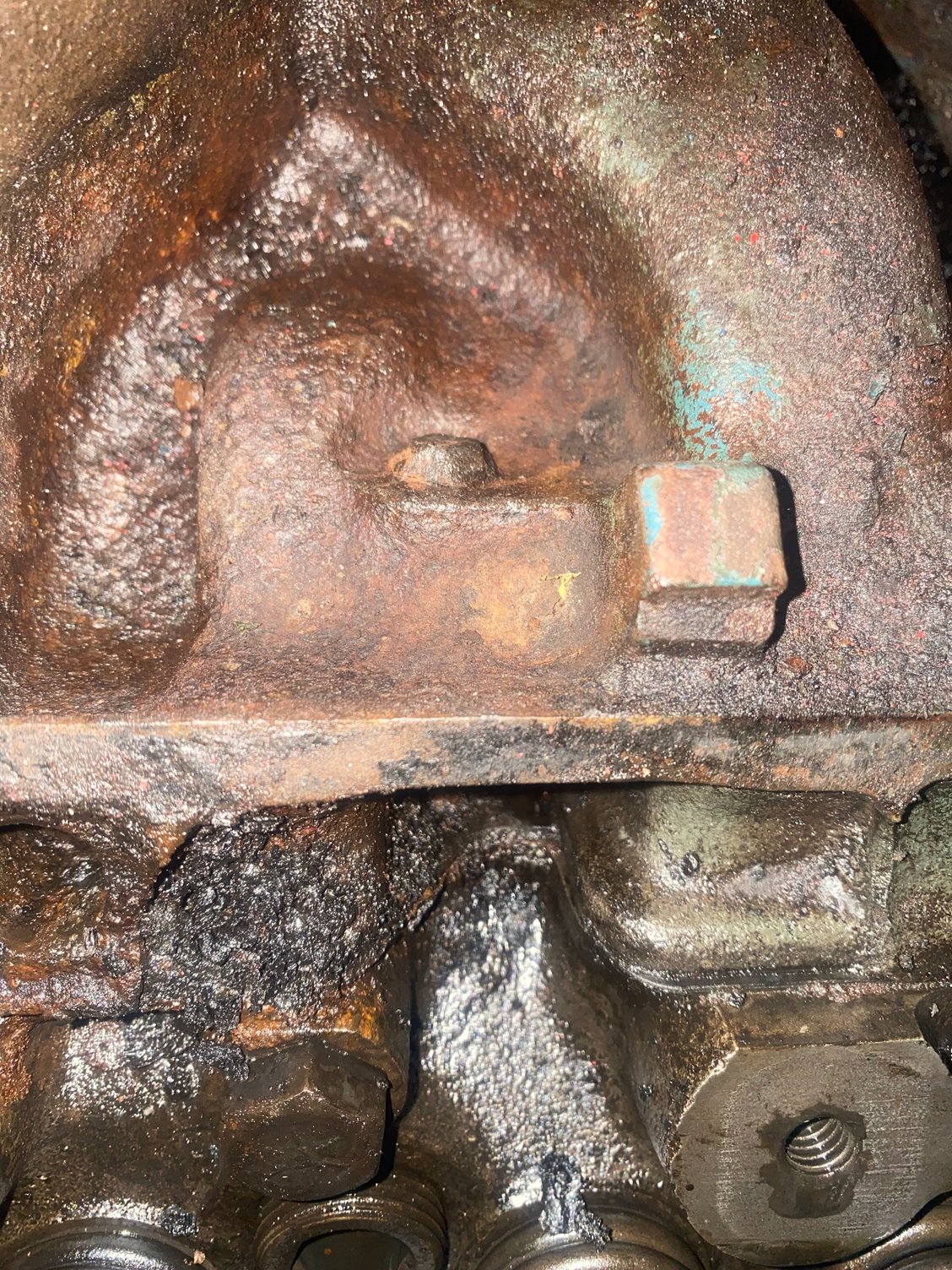

Is this badly corroded or some weird stud?
it’s on the left aft intake side . Underneath it’s threaded.
I may just drill it through about 1/2” then extract the remnants going into the head once the intake is off.
thoughts?

Badly corroded. I had some like that and instead of drilling I welded 3/8 nuts to the heads of them and took them out. I think I had 4 I had to weld out.
