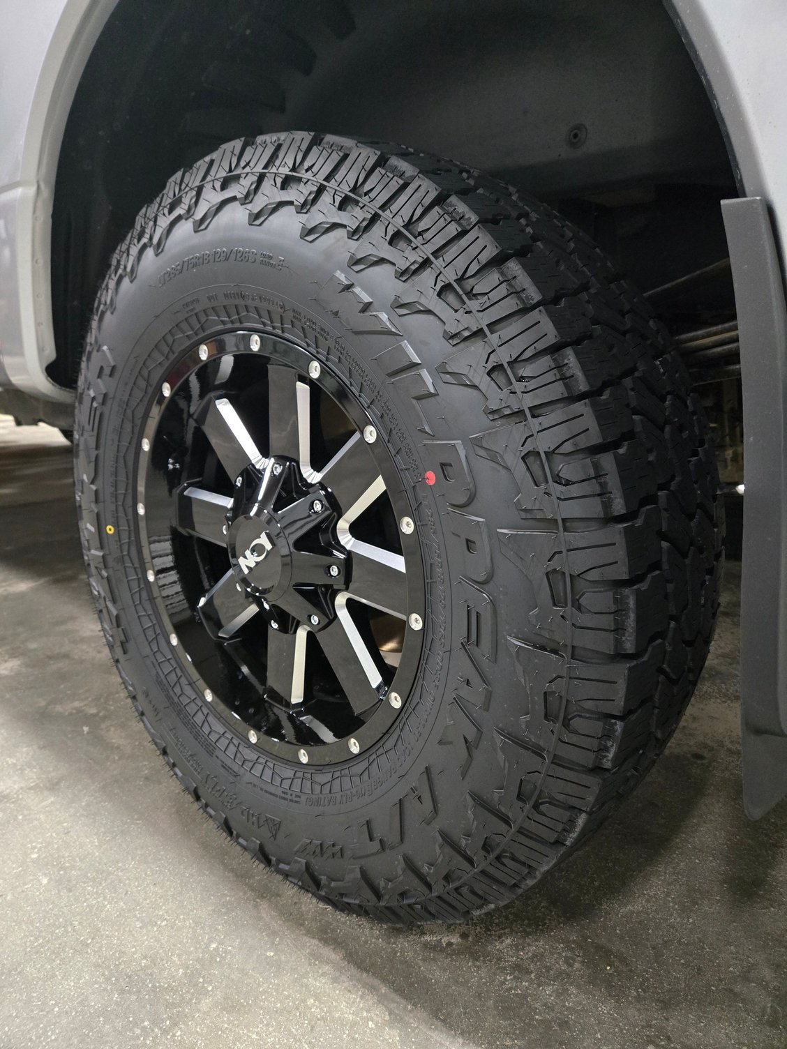

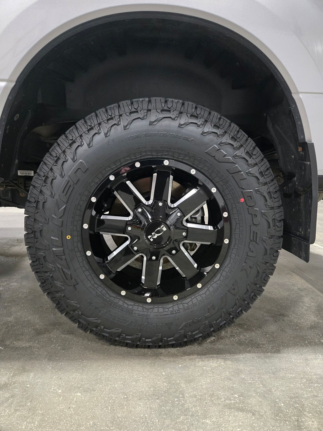

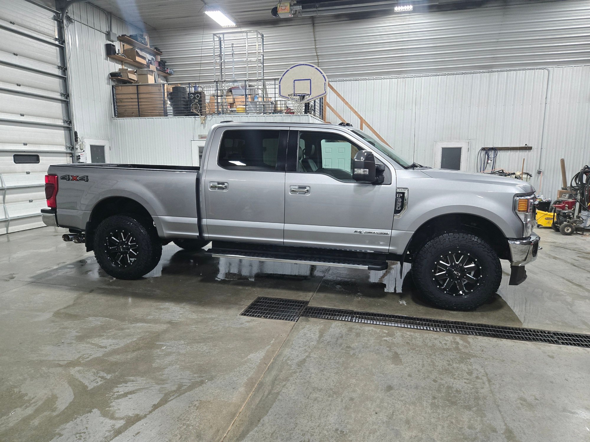

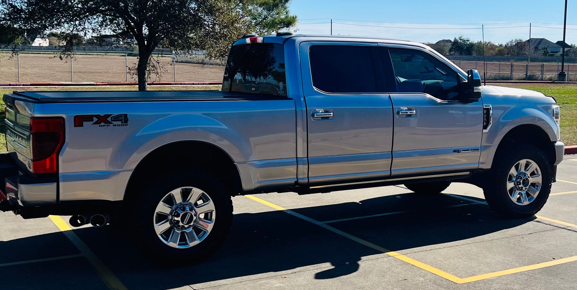

"Was clean" ...... That was shortly aft I got it last August and spent 3 days doing a full detail in my driveway. Now, it's covered in ice, mud, salt, sand, etc as we thaw from negative temps that hit just after having 11" of snow. But I feel the 295/70 is perfect . I average 15.1 mpg on my daily 44 mile commute with an average of 55 mph.
I'm running 35 x 12.5 x 18 on Method wheels on mine. Hopefully by the time I'm ready in 10K miles that size will be widely available.

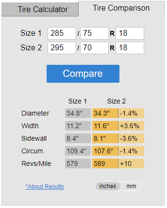

Also, just for kicks, here's a screenshot of the tire comparisons between the 2 sizes...
Here is the chart too. You won't have an issue with either of these sizes. 285 is alittle wider and 295 is alittle taller. I would personally go with a true 35 x 12.50 R18 if it were me. In this case, I would choose the 285/75 because I prefer more sidewall if possible.
And I would stick with the factory spare. Pull it down and inspect it - if it's good / not cracked or dry rotted and holding air, save your money.

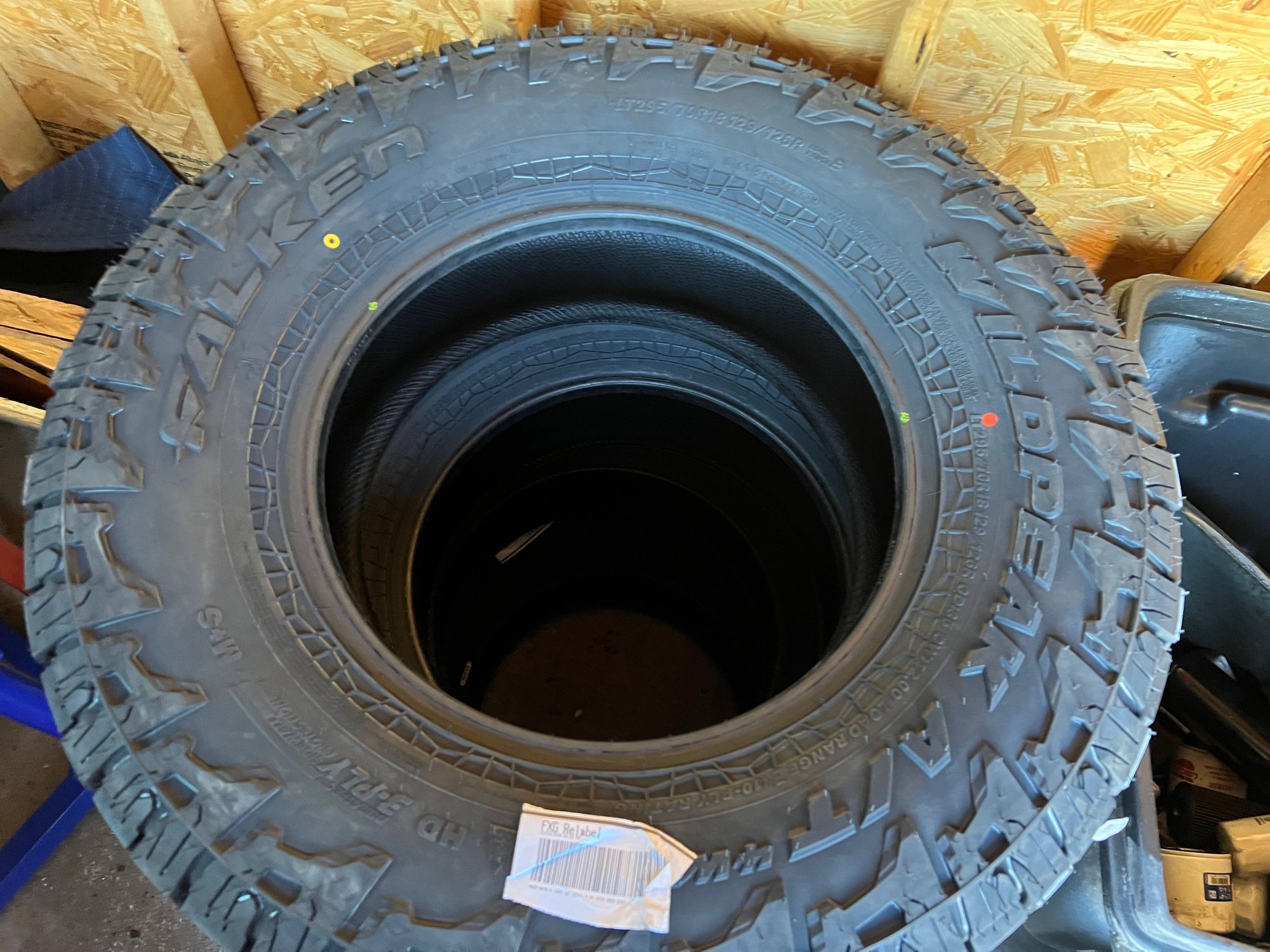

So just to update this thread to, I ended up scoring 4 WP A/T4's in a 295/70/18 from Simple Tire. Truth be told, it was an odd process... my order was placed, then canceled, then reactivated (without me even knowing...) I can't say I was super happy with the way the transaction went, but I did end up with 4 tires. I am having them installed Wednesday morning! I went by and checked out the tires yesterday and they do look really good in person, and I can't wait to see what they look like on the truck! Also, I am planning to change the tire size via Forscan so everything is still accurate. I am also trying to figure out how to reset the TPMS low tire warning because I will likely run these a little lower. I am currently running the Wranglers at 55, and figure I would start at 55 with the WP's, but I am thinking I may end up around 50 or maybe even just a tad lower... Anyway, if you haven't already seen them in another current WP A/T4 thread, here's a pic of the tires for now... they were piled up in a storage room at the auto shop that's going to install them.

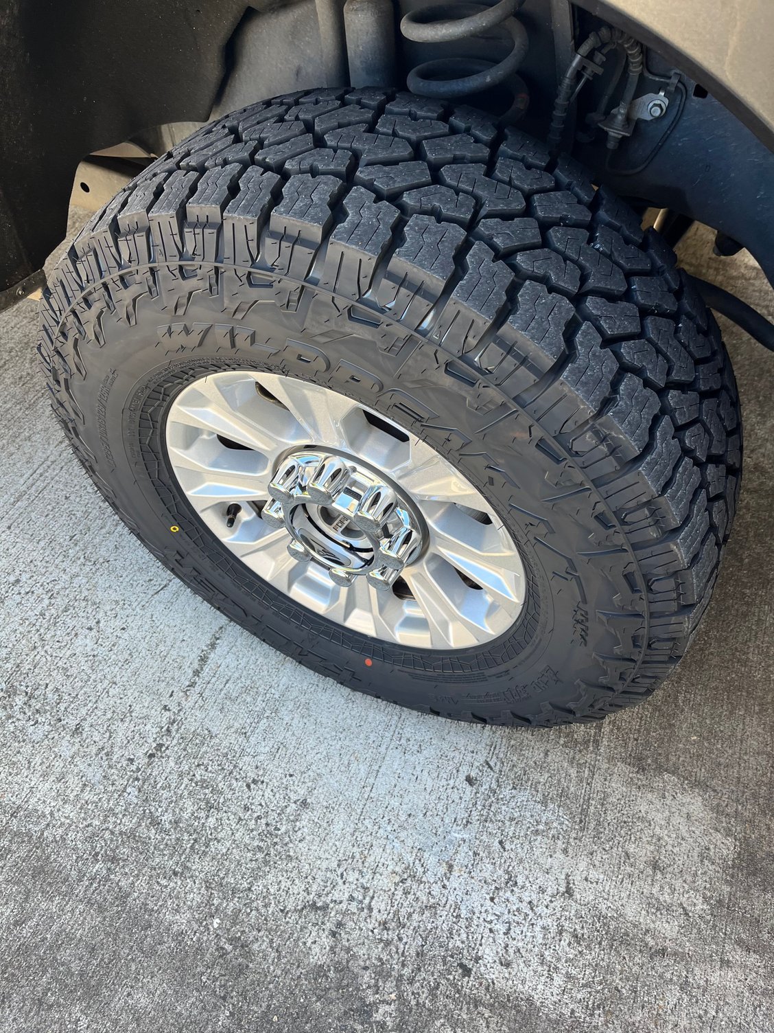

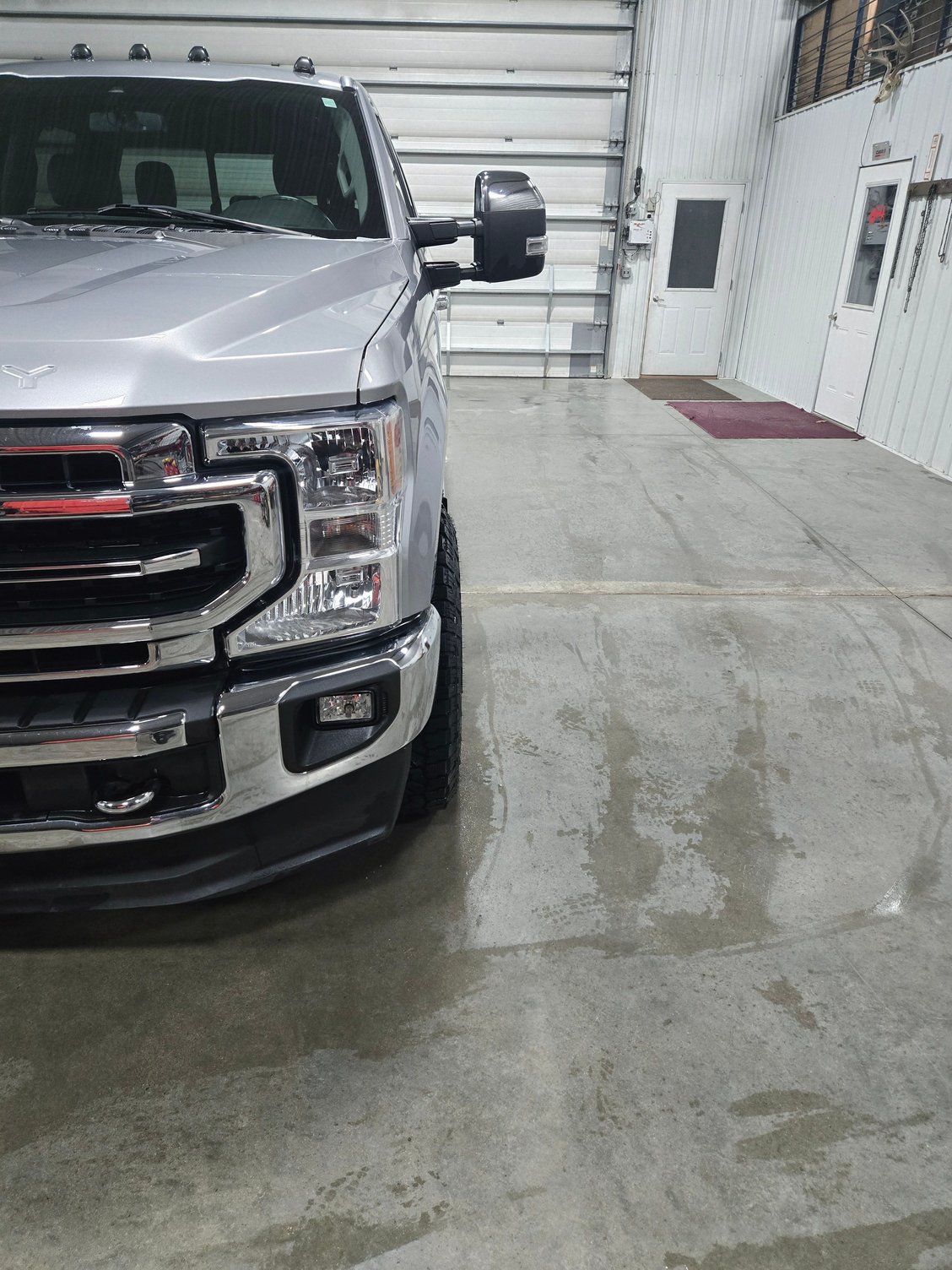

Thought I would share as I spent quite a bit of time searching threads here for new tires and rims and was on the fence between 295/70/18 and 285/75/18. Just installed 285/75/18 Falken At4w today on Alloy Ion 141 +18. All stock. Fills the wheel wheels and still just within the wells I feel. Real happy with my decision.
285/75/18 Falken At4w ; Alloy Ion 141 +18
