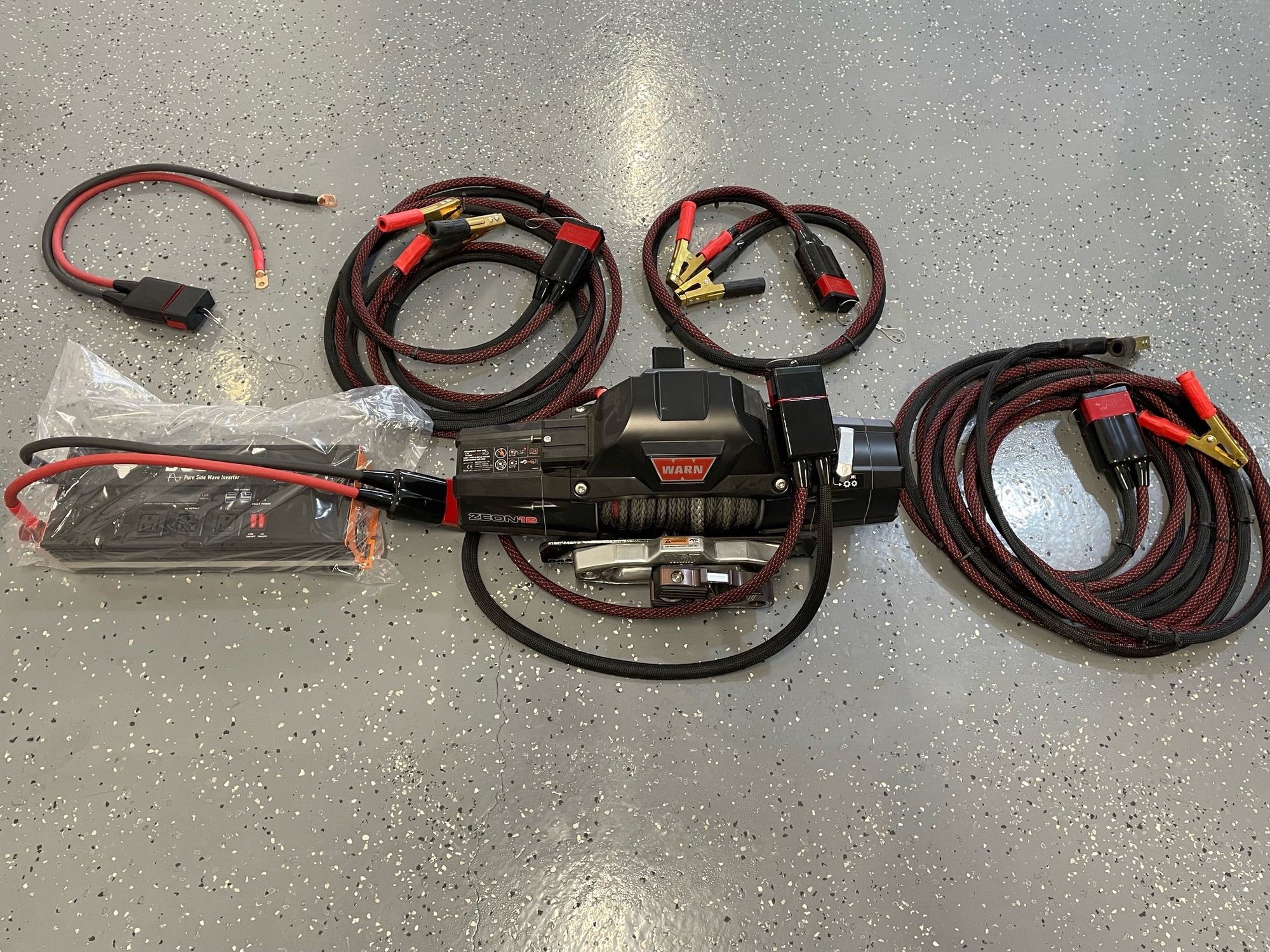

Here is my crazy *** setup. OP, the easiest way is to just drill those out and run a bolt up through with a wing nut. Mine is not installed full-time so I just grab what I need. I have an Anderson that connects directly to the battery if needed. A set of jumper cables, a short set of cables that I can clamp to the posts for a quick connection. And lastly, a set I can clamp to the post and run it to the back of the truck. I had a permanent setup on my last truck but this works better for me as I can throw all this in the 150 if needed or use it on another vehicle.

Wow, a lot going on there!! I also have the setup with the "jumper" cables like you do, as an option to use on anyone's rig, if they have a 2" receiver.

Once you start building cables, it’s easy to get carried away My front hitch is 2” while the rear is 3” so I have a two reducers (3 to 2 and 2.5 to 2) for the winch at the rear. The 150 has a 2” at the rear. I took my Zena welder off of my 02 truck so now I need to figure out a portable option for that.
