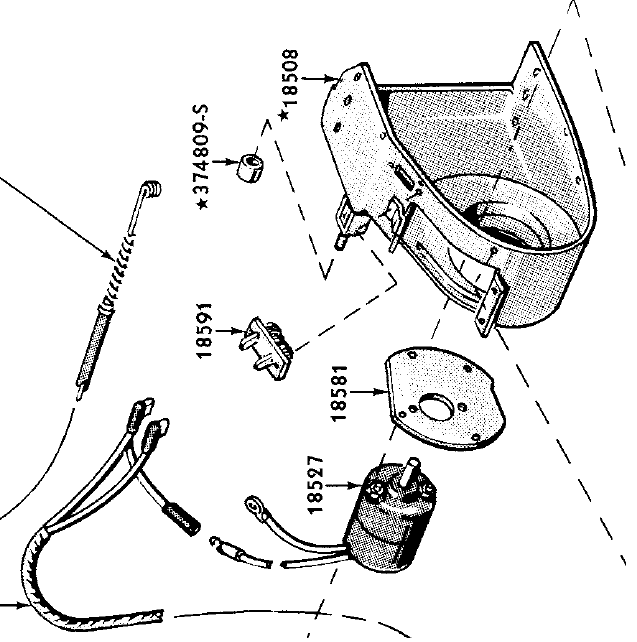

Hopefully this helps. There is a resistor attached to the heater case which is shown in this diagram.

On the other hand, what is symbolized between the orange wire and the red wire before the black red wire? A resistance ?

Yes. Lowers the voltage for low speed. Hence the ‘L’ terminal on the switch diagram.

And do you know if this resistance is on the heating unit or if it is independent ? because I don't have that in my spare parts and I don't see what it could look like.

Read my post #2 again.
Here's a picture of a resistor like what was used. This is the one for 1965-66 trucks (C5TZ), but it is visually very similar to the one for 1961-64 trucks (C1TF). When they are installed on the heater box all that can be seen is the two prongs sticking out not the wire wound resistor.
Held in place with a couple of these screws.

OK, so it may have stayed on my heating block, I have to look at that
