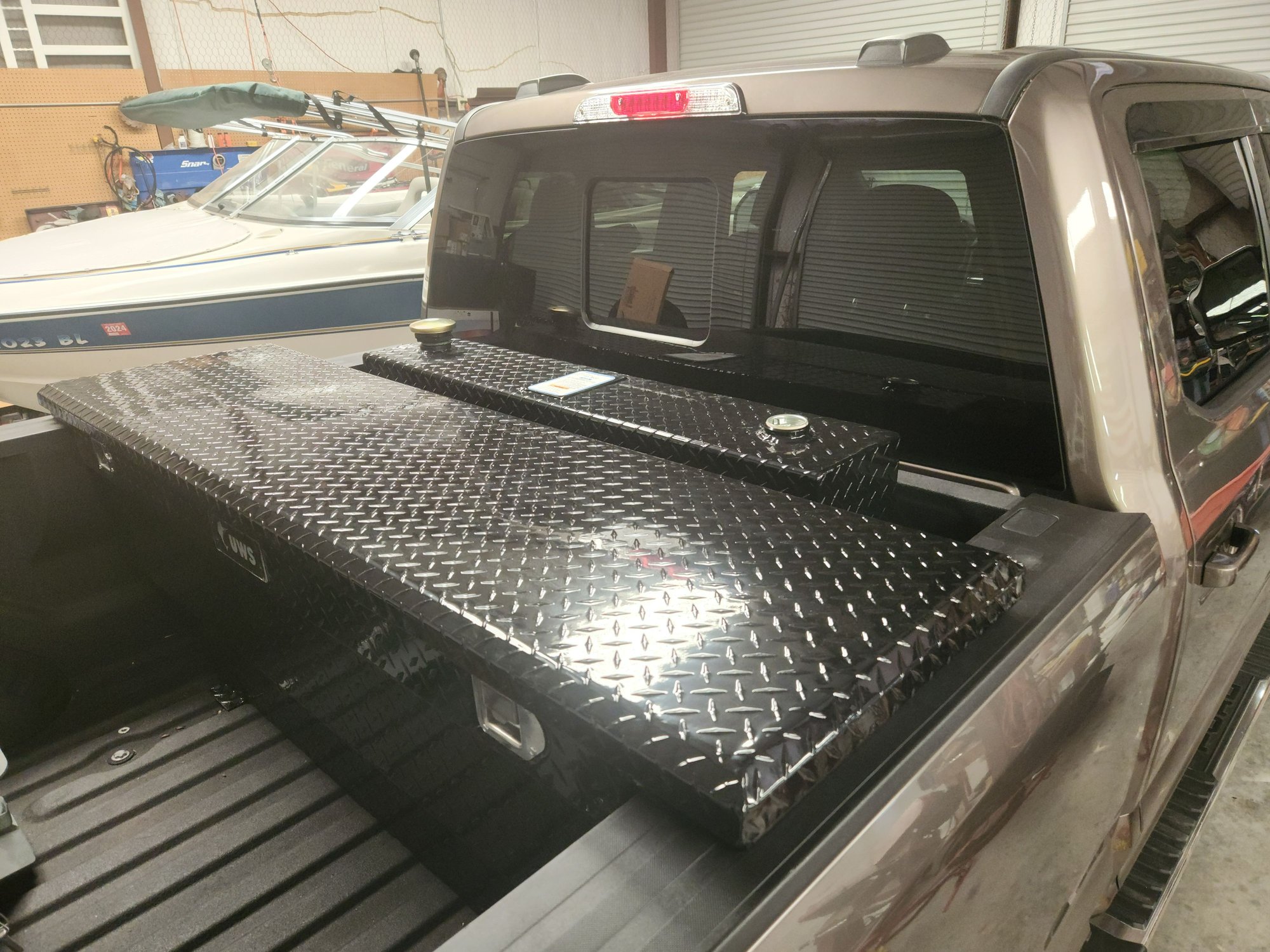

75 gallon transfer tank gravity flow into the 2022 F350, took getting used to, it is slow, I wait until I'm at 1/2 tank and open the valve to refuel while traveling I had a 90 gallon with a pump in my 2015 and it had pluses, faster refueling and I could draw fuel for my shop heater.
