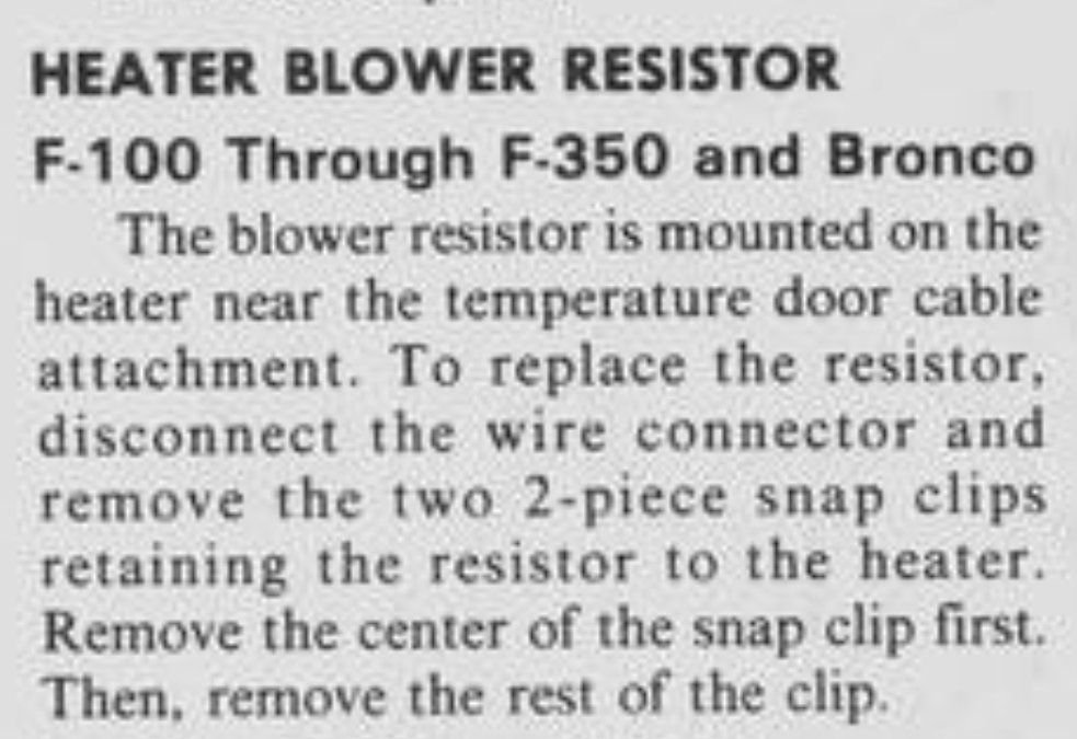

None a/c truck, resistor is a drop in plate on front R/H side of the box. Blue, orange, red wires.

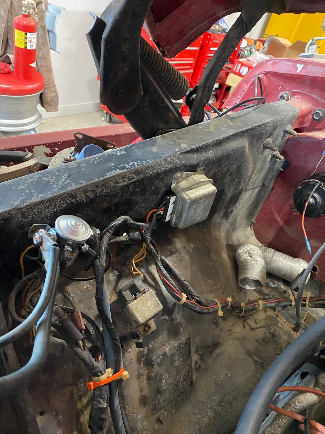

Wow thank you very much. I did not test the blower motor prior to installing, yes all of the master cylinder lines are on the opposite side. Spent a lot of time looking for F100, then switched to 1-ton, this will be the 4th one, hopefully it arrives this morning. I'm thinking I may use adapters for the line fittings to work, only issue is the reservoir is a little smaller, not sure if that makes a difference though. I don't know why they use two different line size coming in when the actual brake line is the same size, I guess maybe to determine front and rear. still need to locate the relay, I'll try to post a pic of one I found on the fender well, just don't know what its for.

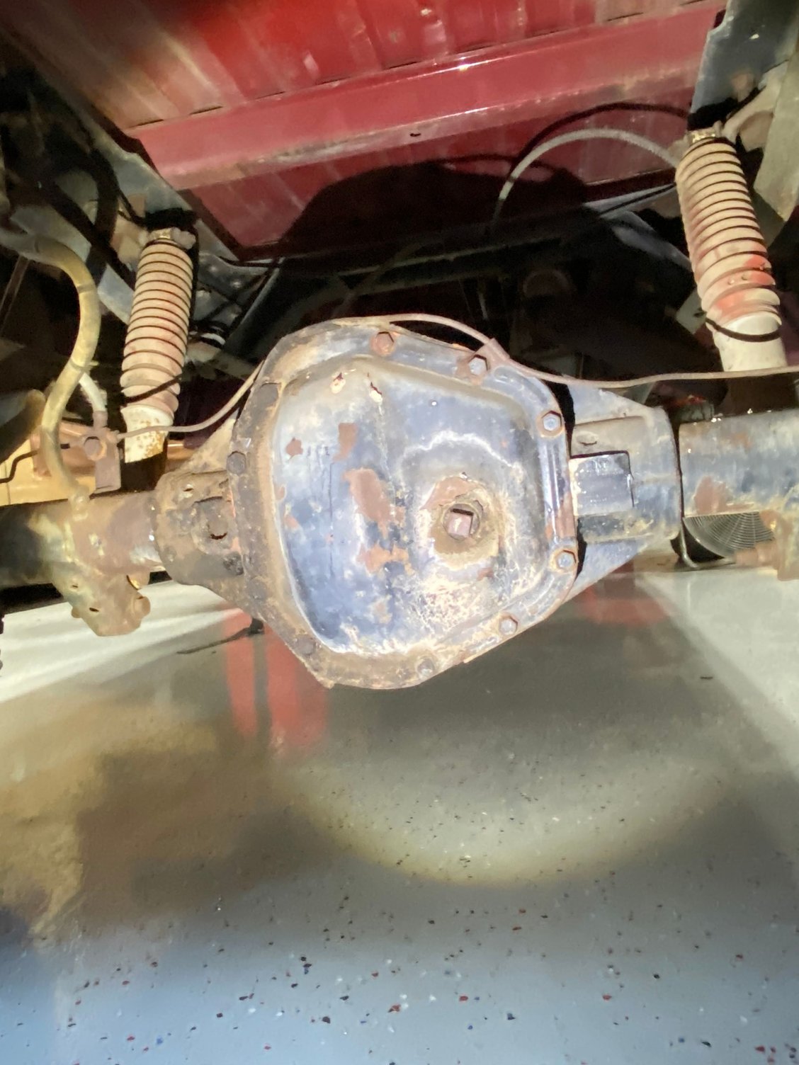

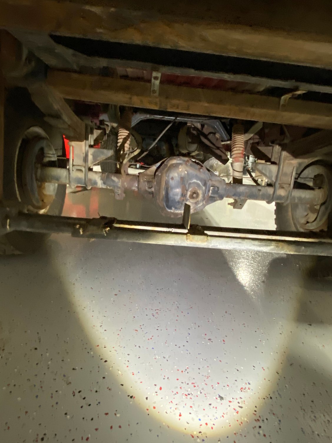

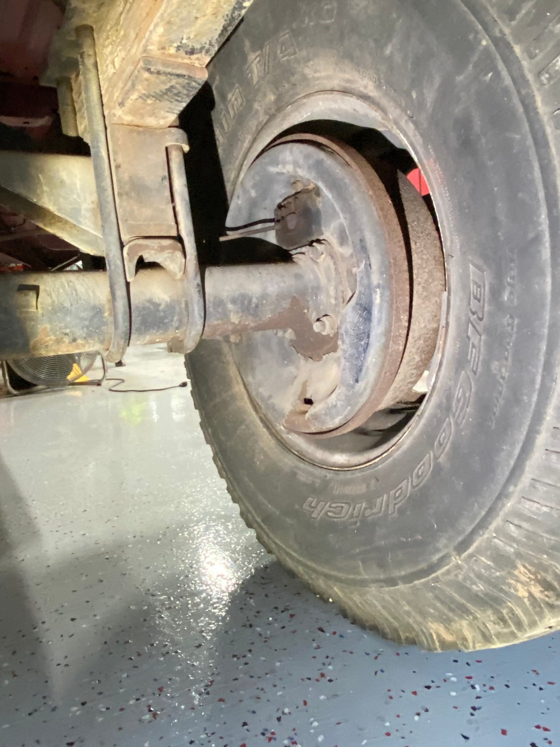

Rear diff.

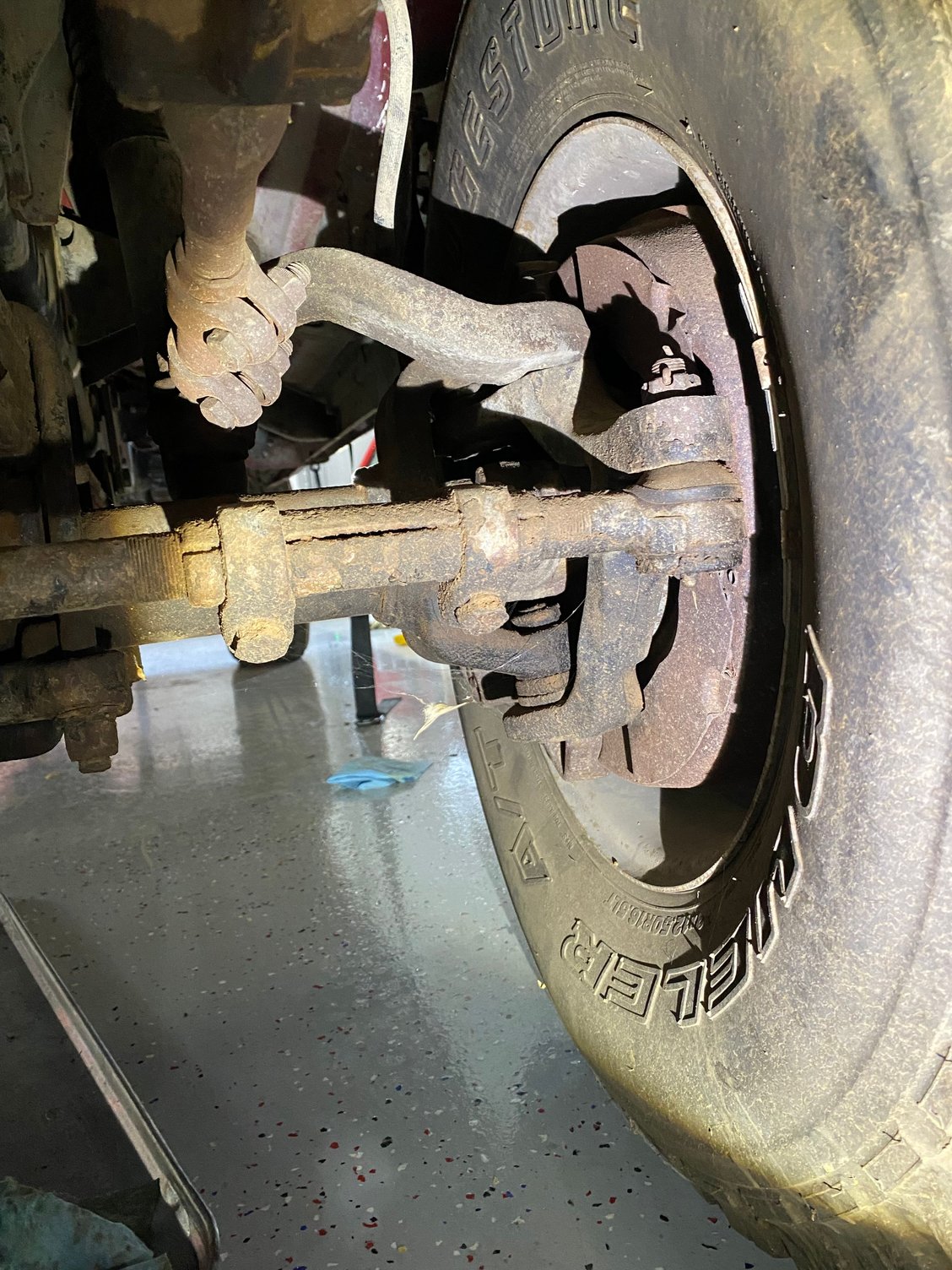

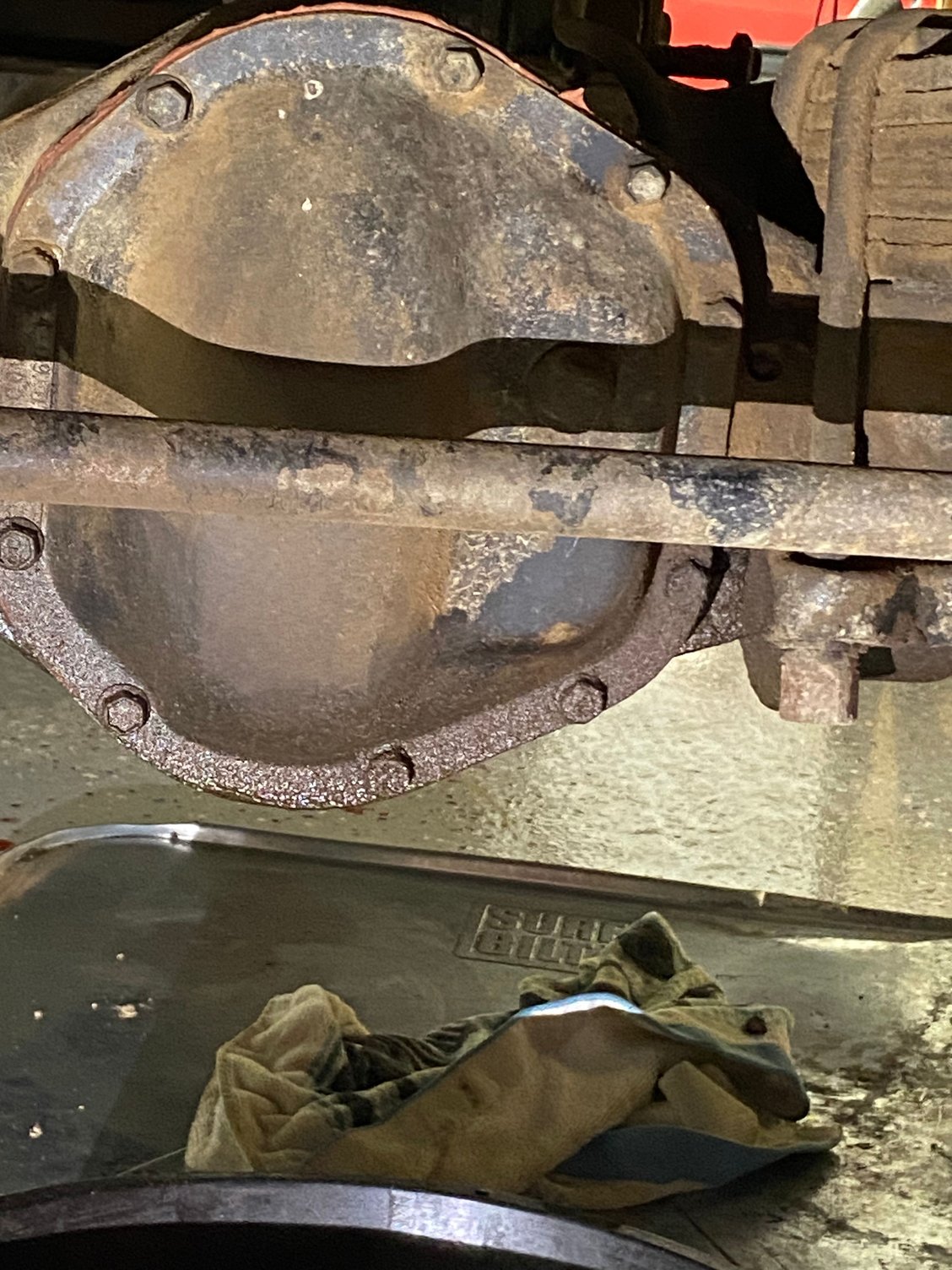

Front diff.

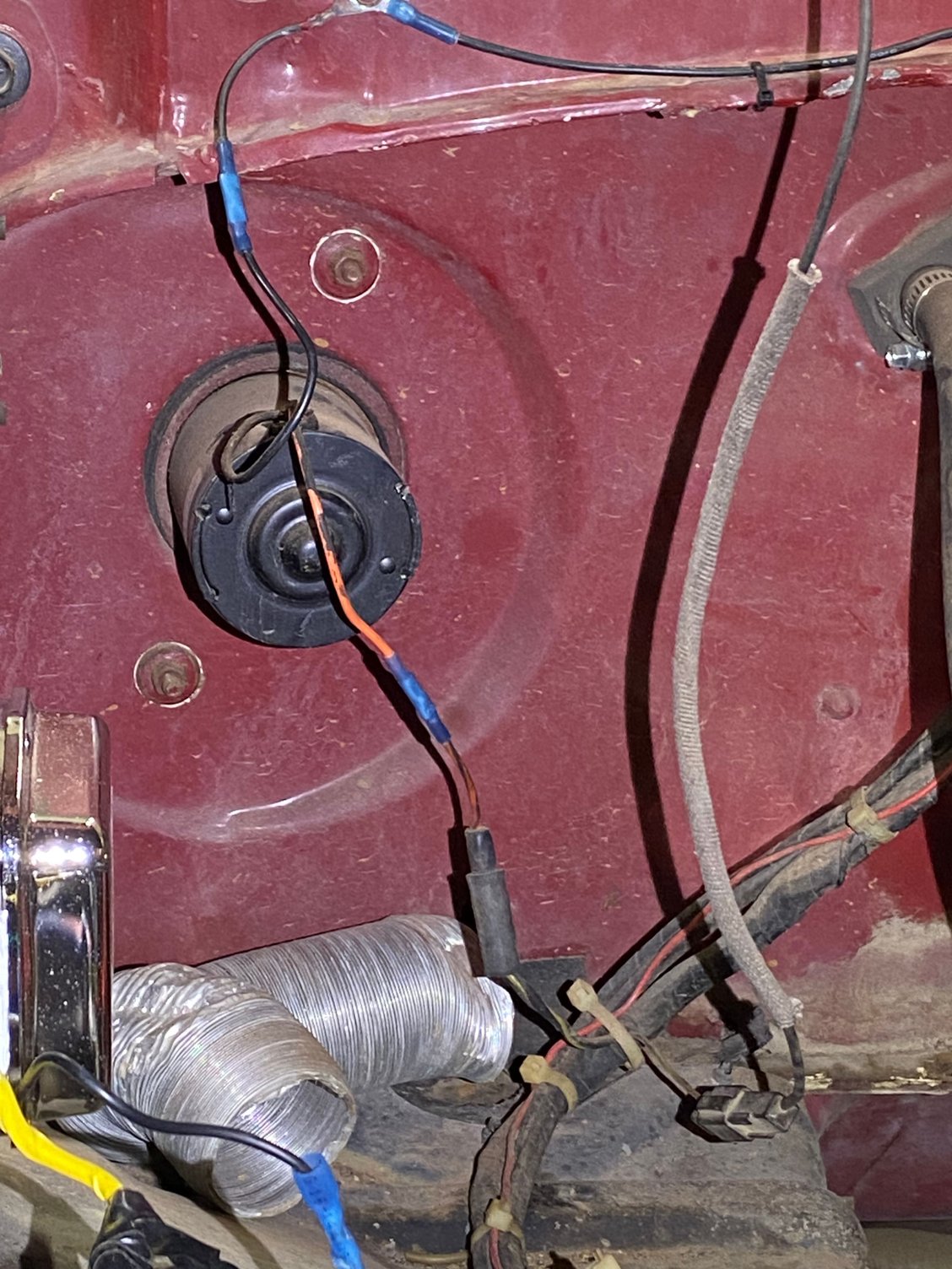

Blower motor. Only wires going to it
Relay below regulator. Don’t know what it is for

Relay on the innerfenderwell I believe is just for the horn.
You can not have a FRONT axle that is a 9", because that is a common Ford truck REAR axle that is 1/2 ton 5 lug F100/F150.
If you have a 8 lug rear and I see a bolt on rear diff cover, so I bet Dana 60, which is a common 3/4 ton rear axle. Or you could have a Dana 61.
3/4 ton 8 lug front axle is the common Dana 44. Scrap off the grease dirt on the front pumpkin lower cast webbing (angles and look for a 44, 6CF 44, 44 6CF.

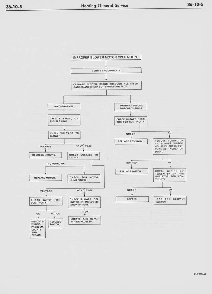

In cases where a blower resistor pack is bad, on high the resistor is bypassed anyway and the blower will usually still operate on high. If it won't blow at any speed, likely a switch, fuse, etc.

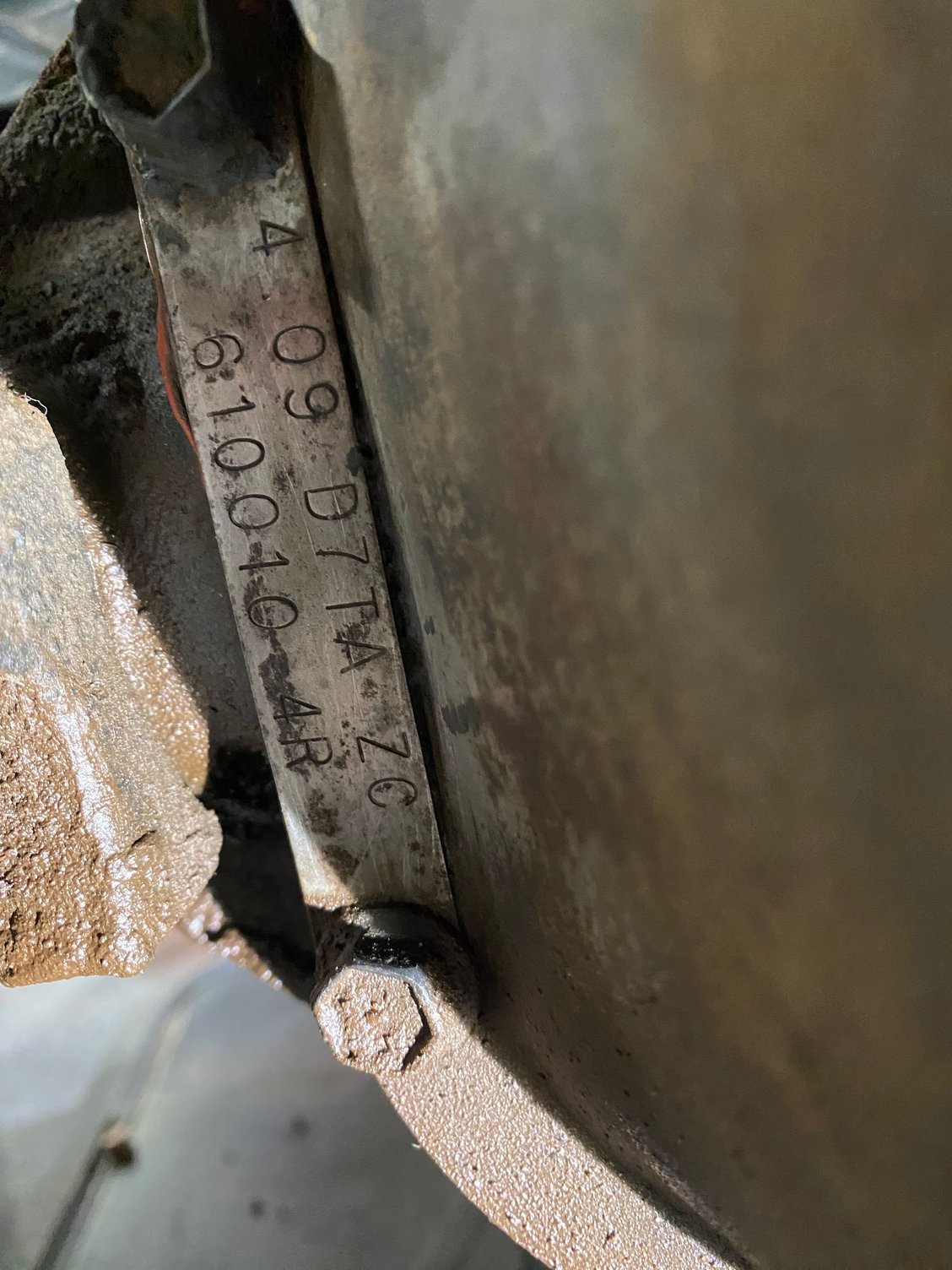

Thank you everyone, I will try to address each answer. The front pumpkin has these numbers.
4 09 D7TA ZC. And below that number is 610010 4R.
Regarding the rear diff, there is a tag with a company name and half the numbers ground off, I called the company but they couldn’t help much without all the numbers. Is there a way to determine a Dana 60 or 61? Or does it really matter.
regarding the fan switch , I removed n put it back on. It works on high n low, not medium. I cannot
find a relay, or do you think it’s the switch?

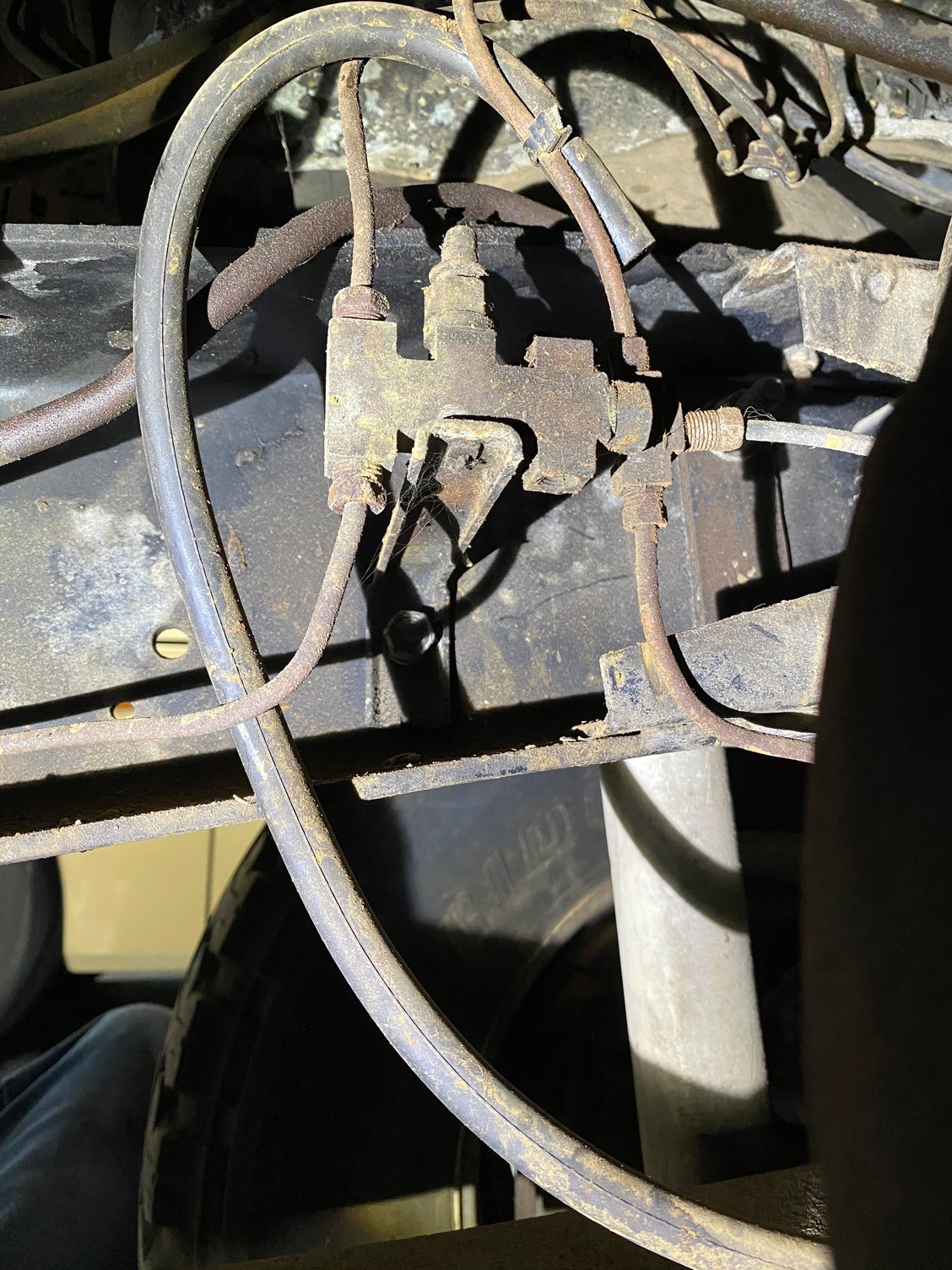

regarding the master cylinder, the rear large reservoir feeds the front brakes. It also looks like he bypassed the proportioning valve So my question is, if the system is bled and is full, does it matter which reservoir feeds front or back. It doesn’t empty correct.
you say the front uses more, is that when the pads wear and more fluid is used to fill the space?
I think I’ll replace the fan switch anyhow. Sometimes works on low n sometimes not. If I wiggle it it works. Just gotta find the relay
I’ll attach some pics. Thnx
