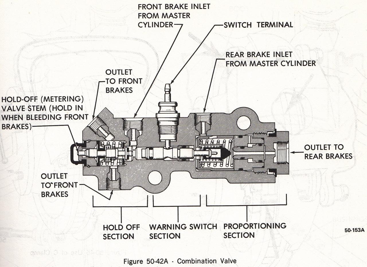

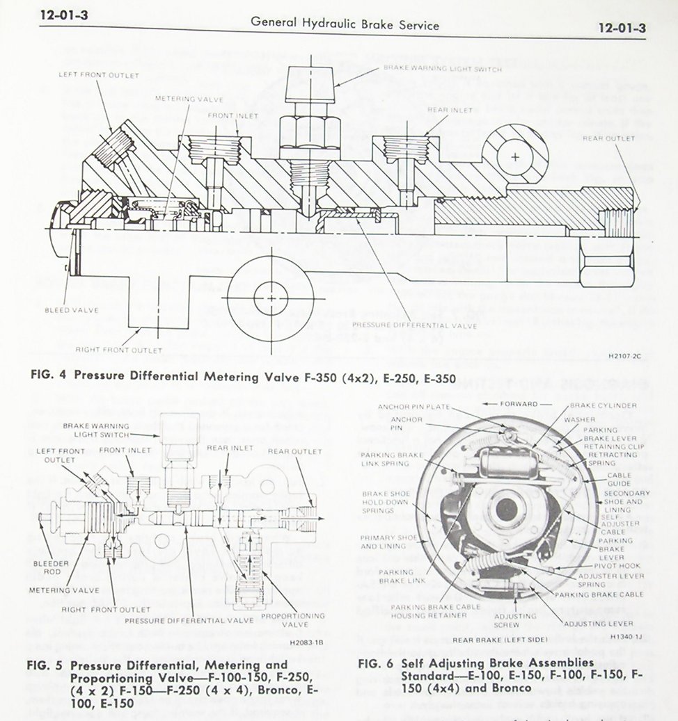

T bear...I said "or" as far as the reservoir size and where the fluid goes. Large reservoir is normally for front brakes, no matter if it is front or rear positioned in the master cylinder layout. Correct?
Ah yea looks like you have some sketchyness going on with that pro valve bypass. You might want to get that figured out. NO the MS does not empty out when you push the brake pedal. And yes as the brake pads/shoes get worn (way worn, near worn out) your fluid level can be real low. The more worn out the brakes, the lower the fluid level. That is due to the pistons having to come out (and stay out) further out of the calipers or the rear wheel cylinder.

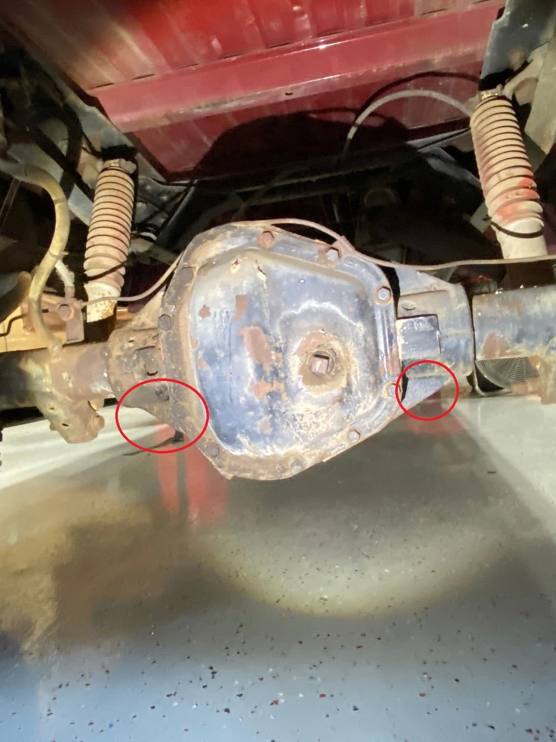

Looks like you have 4.09's for your axle gear ratio.
Check the red circles for a D60 or D61. I think the dvrs side has it. What axle only matters when you order parts like brakes, bearings and seals.
Check the red circles for a D60 or D61. I think the dvrs side has it. What axle you have will only matter if you chose a different gear ratio for the differential and when you order parts like axle shafts, brakes, bearings and seals. What axle ratio you have will be always important for a number of reasons from tire size to motor's HP as well as transmission choice.

Thnx, I'll check the rear end for those numbers. what about the front diff, what do you think that is? I'll be doing all brakes, lines etc. it will all be replaced front and rear.

I’ll look tomorrow. I’m hoping the 1/4 brake line will seal on the smaller opening. I’m gonna have to get a new proportioning valve, the PO bypassed the front n installed a tee. But first I need to be sure it stops. This MC has been a pain. I’m think I should return it n buy the booster MC combination. See what happens tomorrow. Thnx again for the info. Hope to get the switch by weeks end🙏
