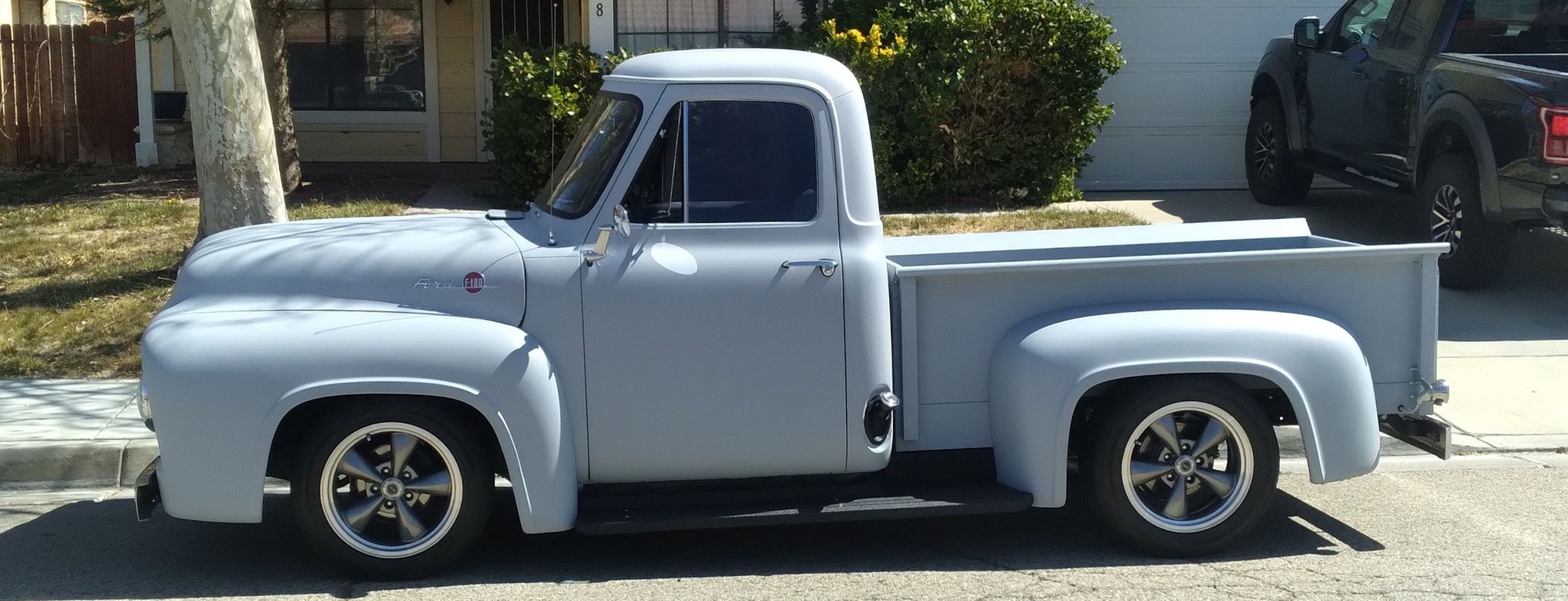

17x7 front with 225/55 tires 17x8 rear with 235/55 tires

great look - what have you done to your suspension?

the front had a chevy chevelle frame clip installed and the rear is leaf springs with posies springs and lowering shackles and brackets from mid fifty.
