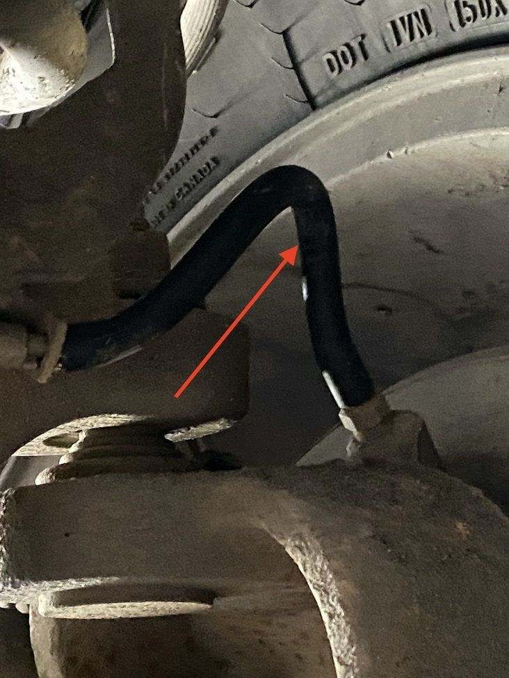

Another thing to check is the vacuum lines going to the hubs themselves, these can dry out and crack reducing the vacuum going to the hubs, I recently had to replace mine for the same issue. Here’s some photos from my 2012 showing the vacuum lines I was referring to.

madsonp is correct, those vacuum lines could also be the culprit, you'll need to inspect everything. Just make sure you're inspecting the vacuum lines and not the brake lines - some people get them confused because they do look similar.

Let us know what you find out. Do more than just a visual on them, visually mine looked fine, but when I flexed them a little I could clearly see that they were cracked.
