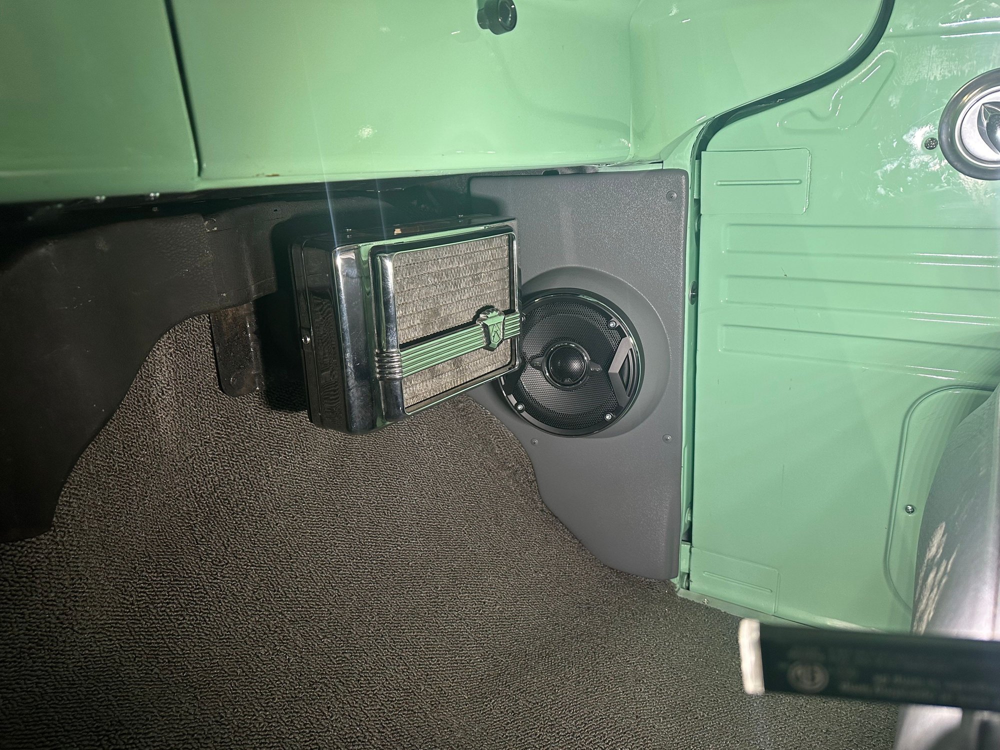

I ordered my headliner panel behind seat and kick panels back in November for my ‘56, they sent me kick panels for a 67 bronco, tool another 2–3 weeks to get correct ones, im
sti waiting for the rest, spoke to Blane and he told me they moved from California to Wisconsin and he’s finally set up, that was 2. Weeks ago and still waiting, kick panels are definitely nice, hopefully they will show up soon
