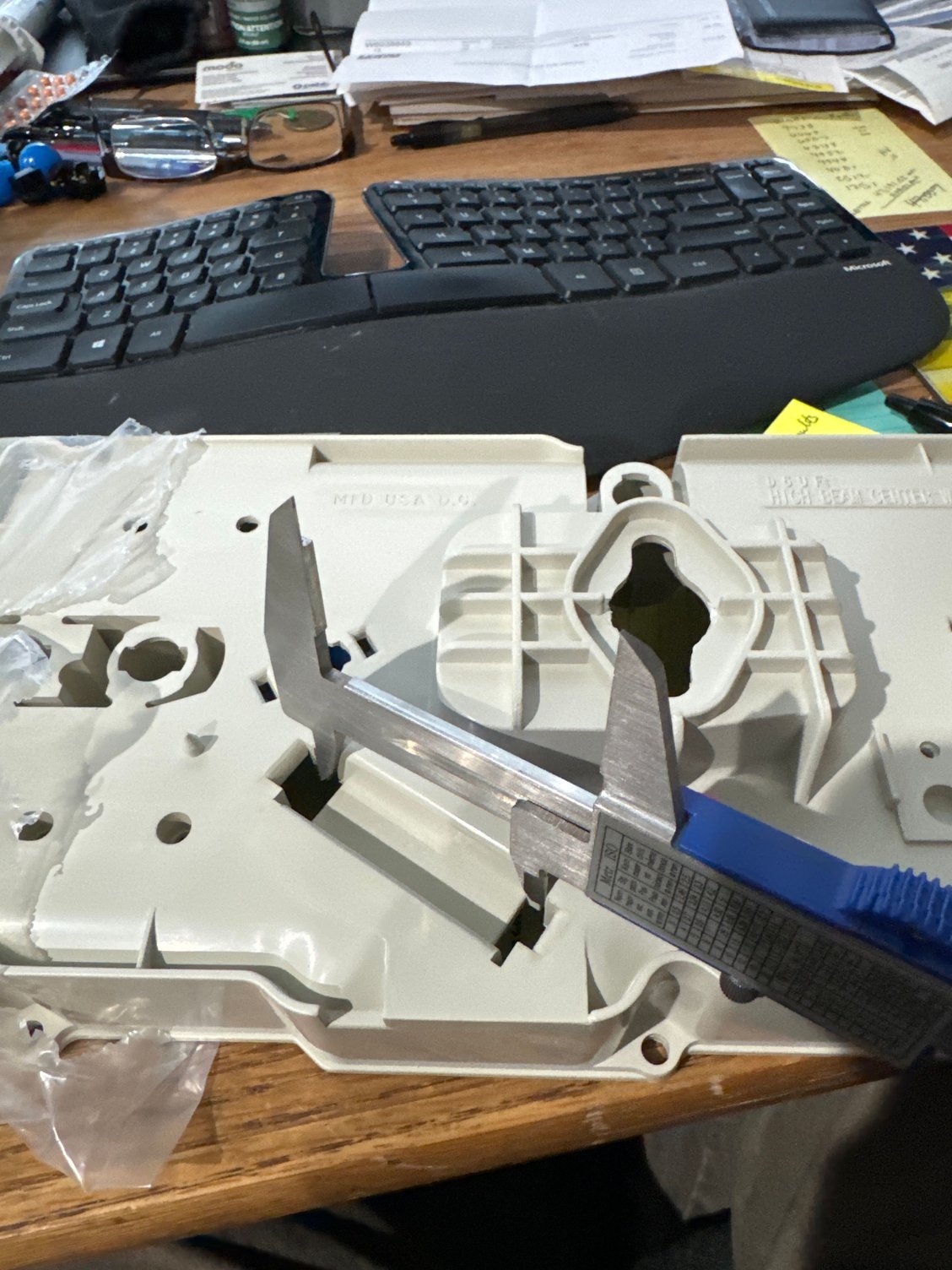

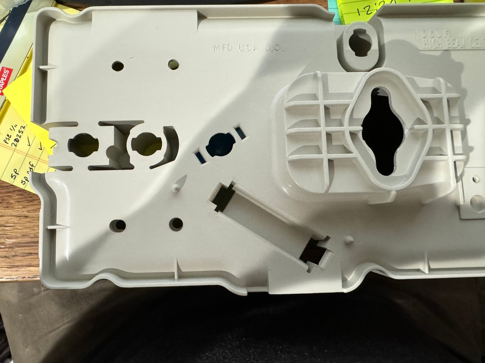

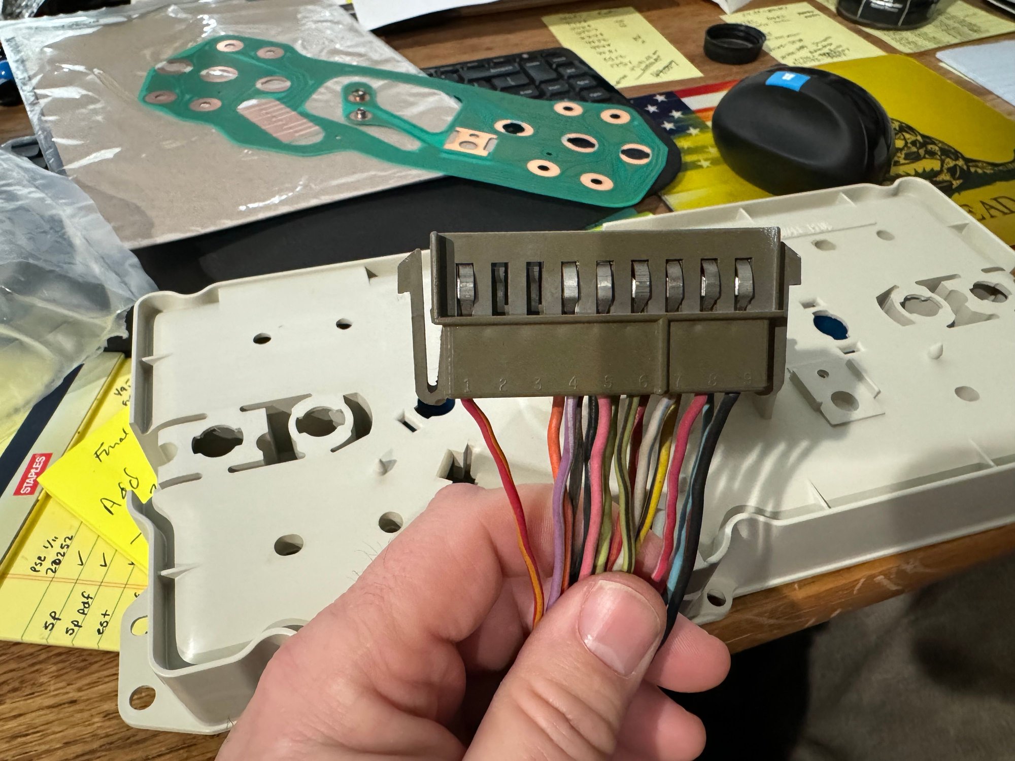

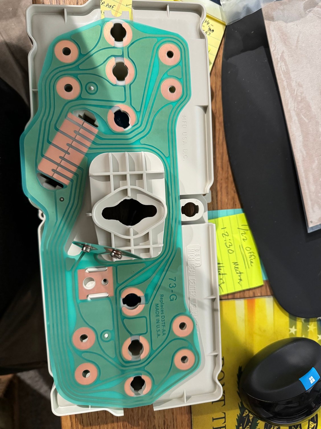

New printed circuit for 74
New gauge plate for 74

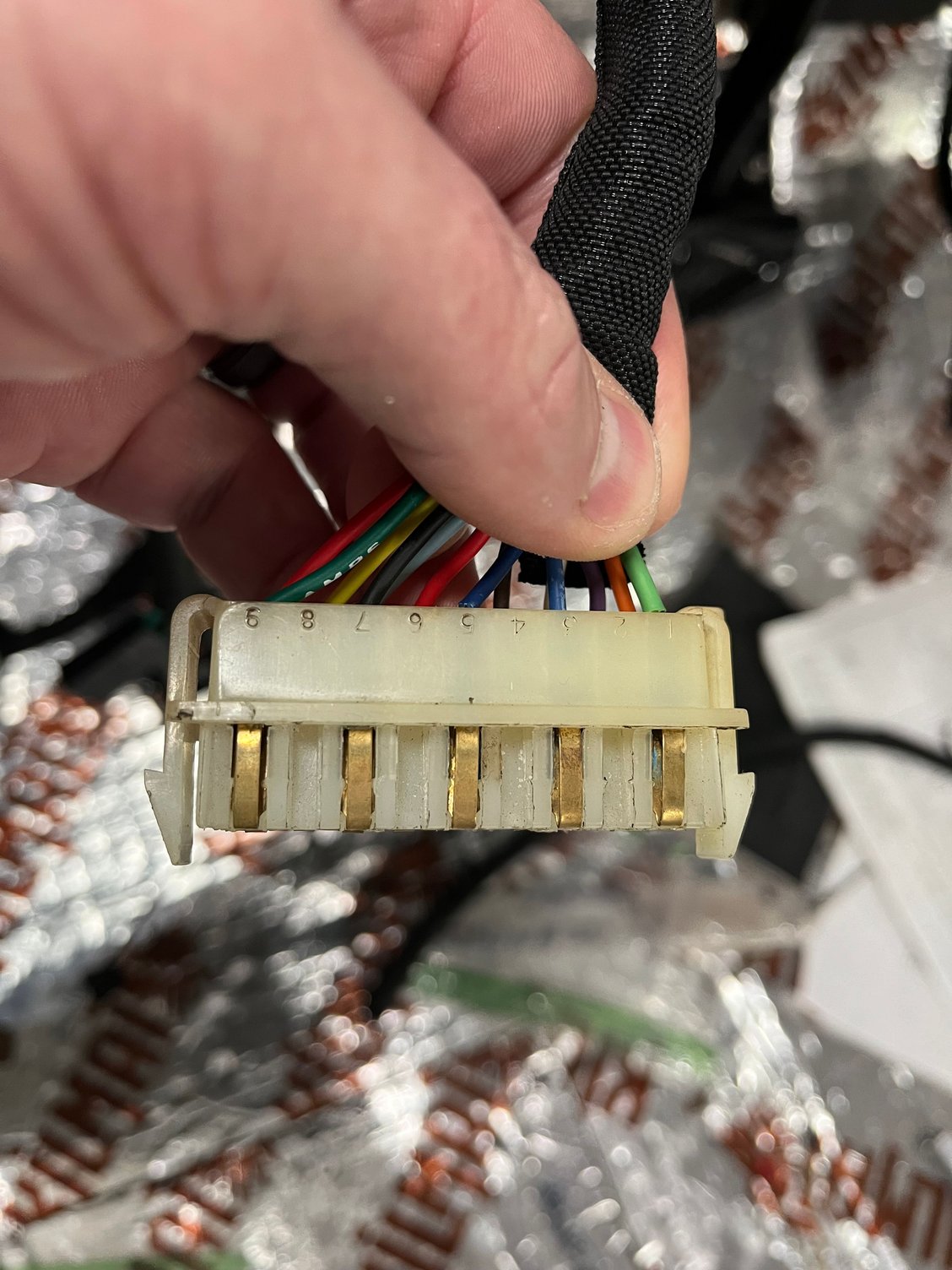

Old plug from truck too wide to fit
Old Jan 11, 2024 | 03:52 PM
scottscott's Avatar
scottscott
Joined: Dec 2007
Posts: 1,512
Likes: 340
From: Wildwood Pa
Did you try flipping the plug 180 degrees? One end is wide, the other is narrow. gotta match them up. There is only one width of plug, but there are different lengths. Yours looks like the correct length.

I get the width is different at each end of the plug but my plug is too long for the slot.

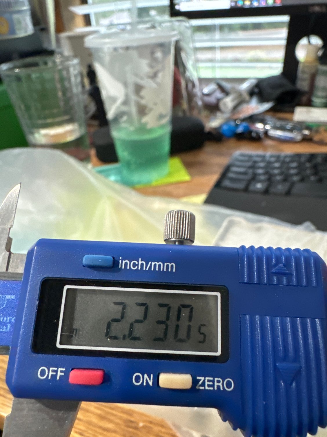

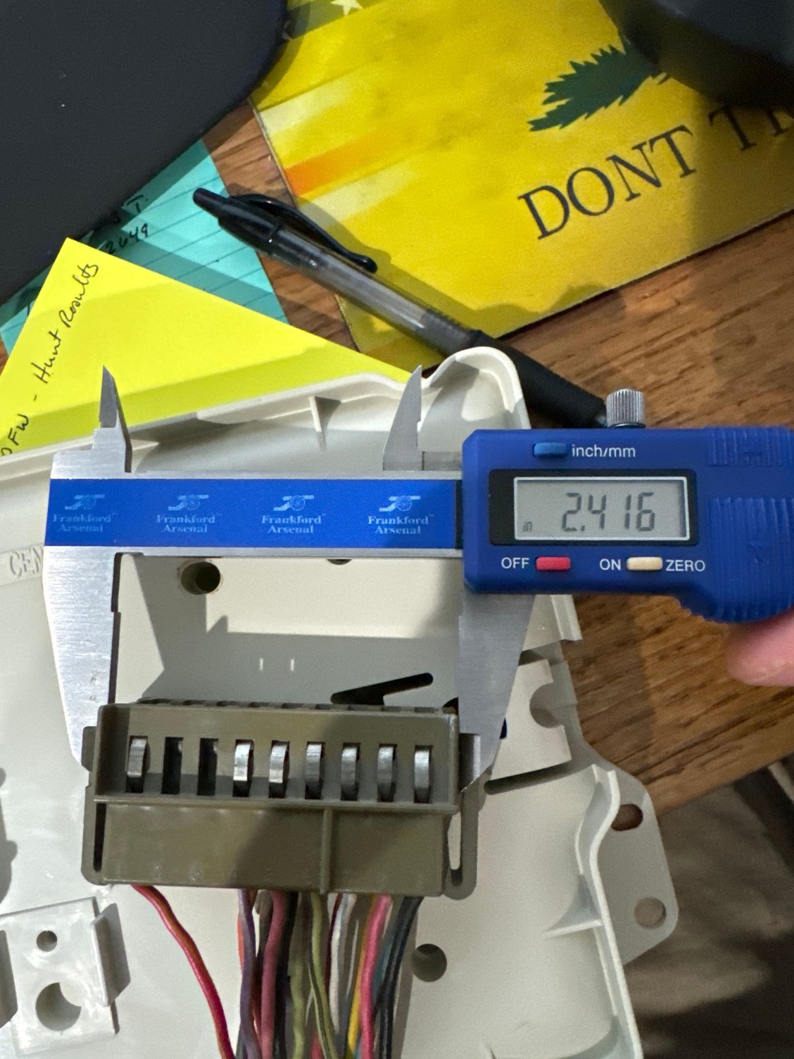

Here’s the connector from my ‘73. I was told by the guy at Centech wiring that it is a “GM style” connector. Not sure if that’s accurate or when they were used in our trucks but that’s the info I have. The connector body measures just over 2 1/4 inches in width.

Yes 2 1/4” would be right to fit the cluster I have. Where do I get one of those?

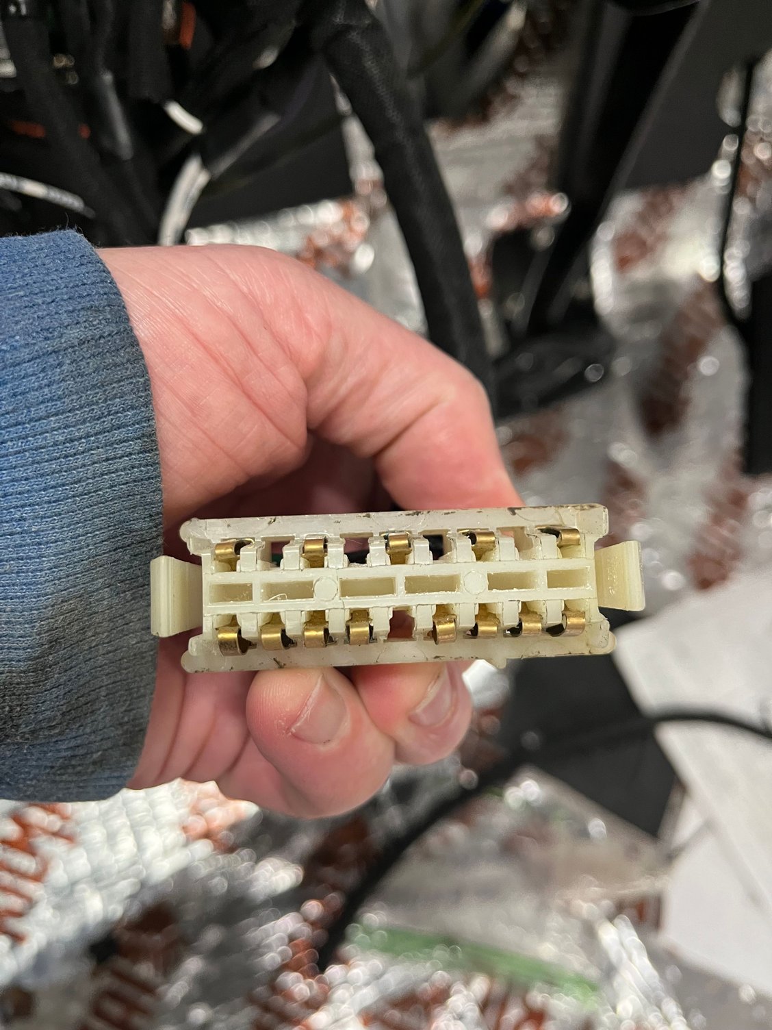

Have a look here starting on page 109. The plug your looking for should be listed.
Old Jan 11, 2024 | 05:07 PM
redroad's Avatar
redroad
Posts: 5,217
Likes: 506
From: Pa.
Is this it?
