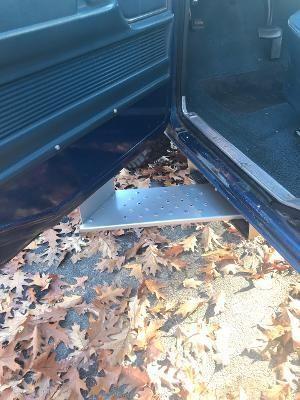

Cab Step

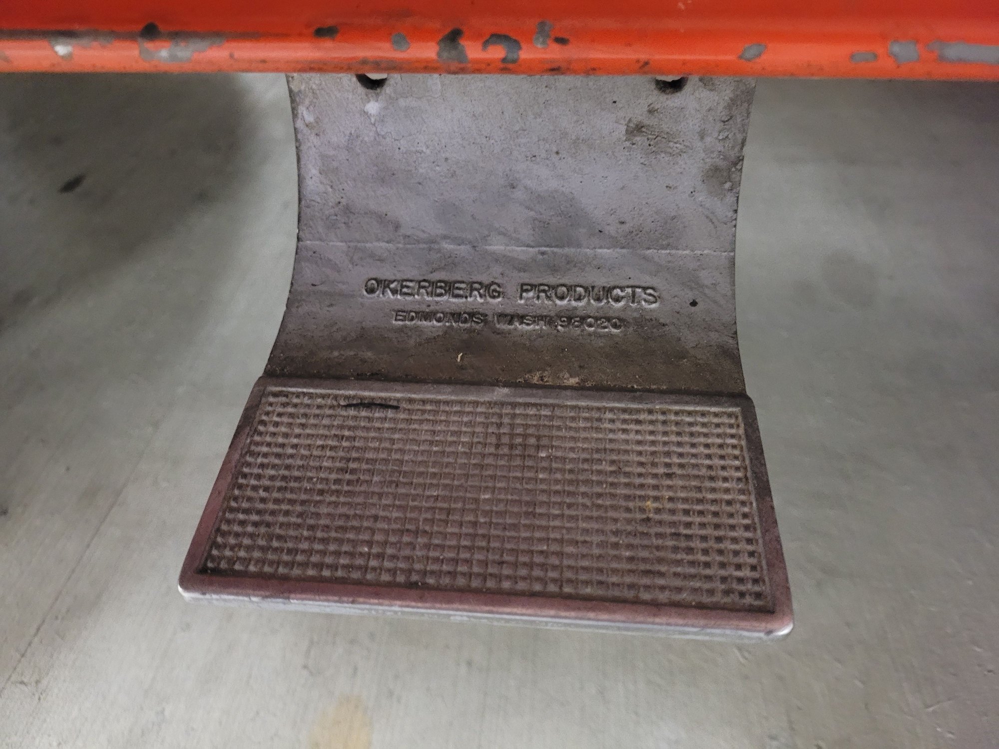

Has anyone ever come across a step like this before? Looks like it was made by a local company that doesn't seem to be in business anymore. I actually enjoy this step but the problem is there isn't one on the passenger side and I need to assist the lady getting in.
I wouldn't mind putting something similar on if I could find a pair but the closest I can find are they small bars of similar width and they just look like ankle breakers in this rainy state to me.

Looks similar to the Carr brand as well. They were out of the Los Angeles area, but I’m not sure if they are still around either.

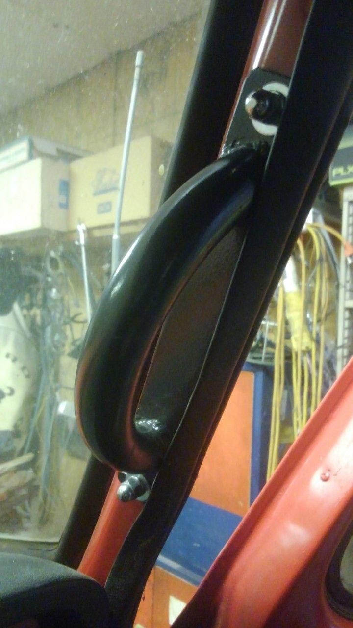

Oh, I understand the concern. I was not sure how we'ld like these, but we both love them. They go well with some hand holds on the windshield posts. These are some aluminum ones found on Amazon, they are black, but I sanded and polished the top. I used 1/4-20 bolts from under the rubber through holes into the truck, and nuts inside the recesses, I did put a larger ss washer under them after bending a lip on the edge. Very solid and not in the way. It was too easy for Wife to have her grasp of the windshield pillar slip. I use it too instead of the steering wheel, or with the steering wheel.
And I was not throwing off on the ones you want, just offering alternative ideas.
Too easy to have a big clot after an injury. Take care ....

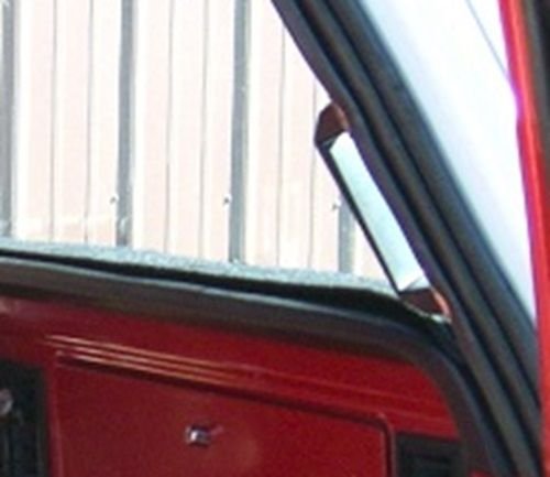

https://www.ford-trucks.com/forums/1...b+grab+handles

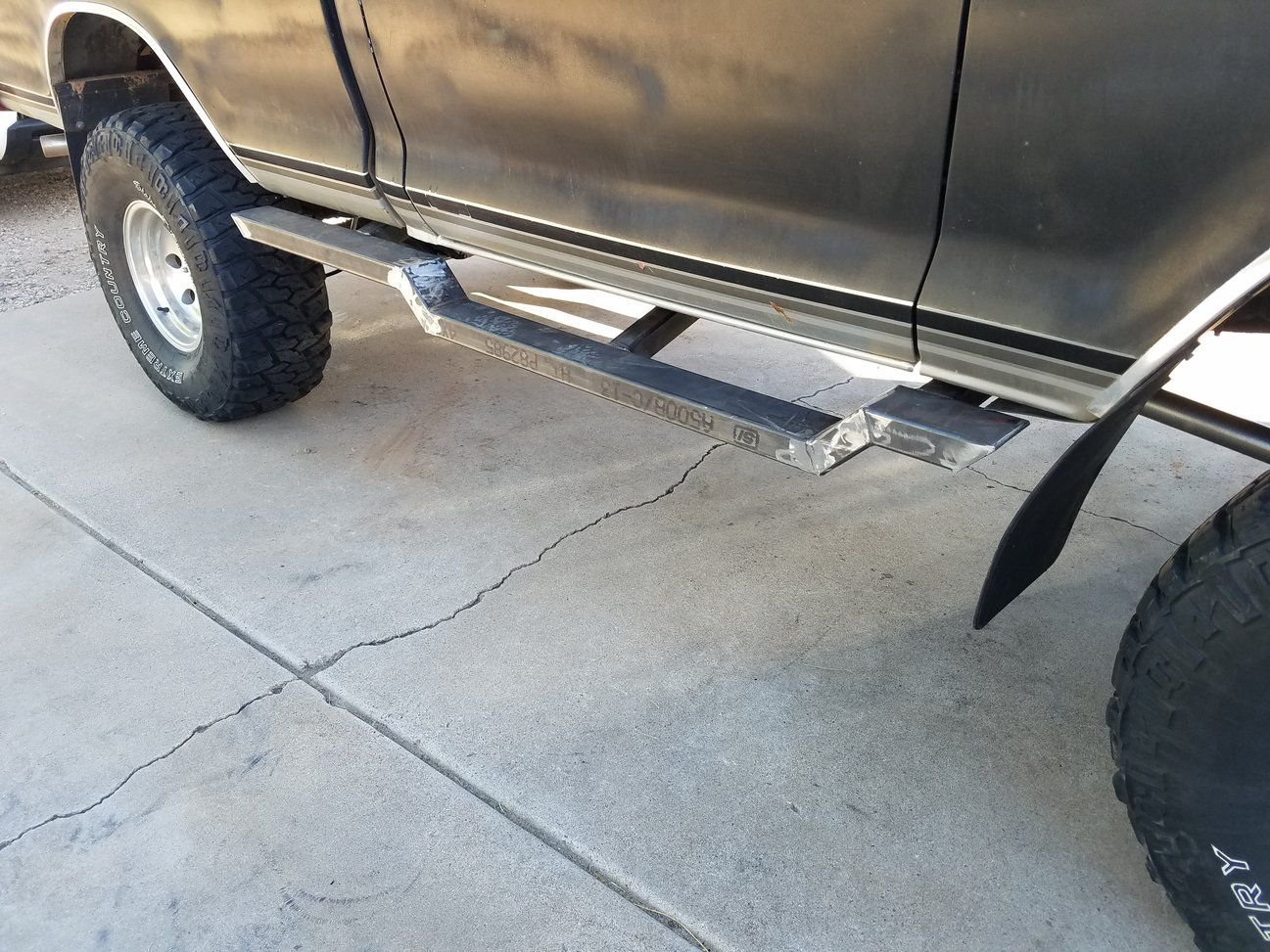

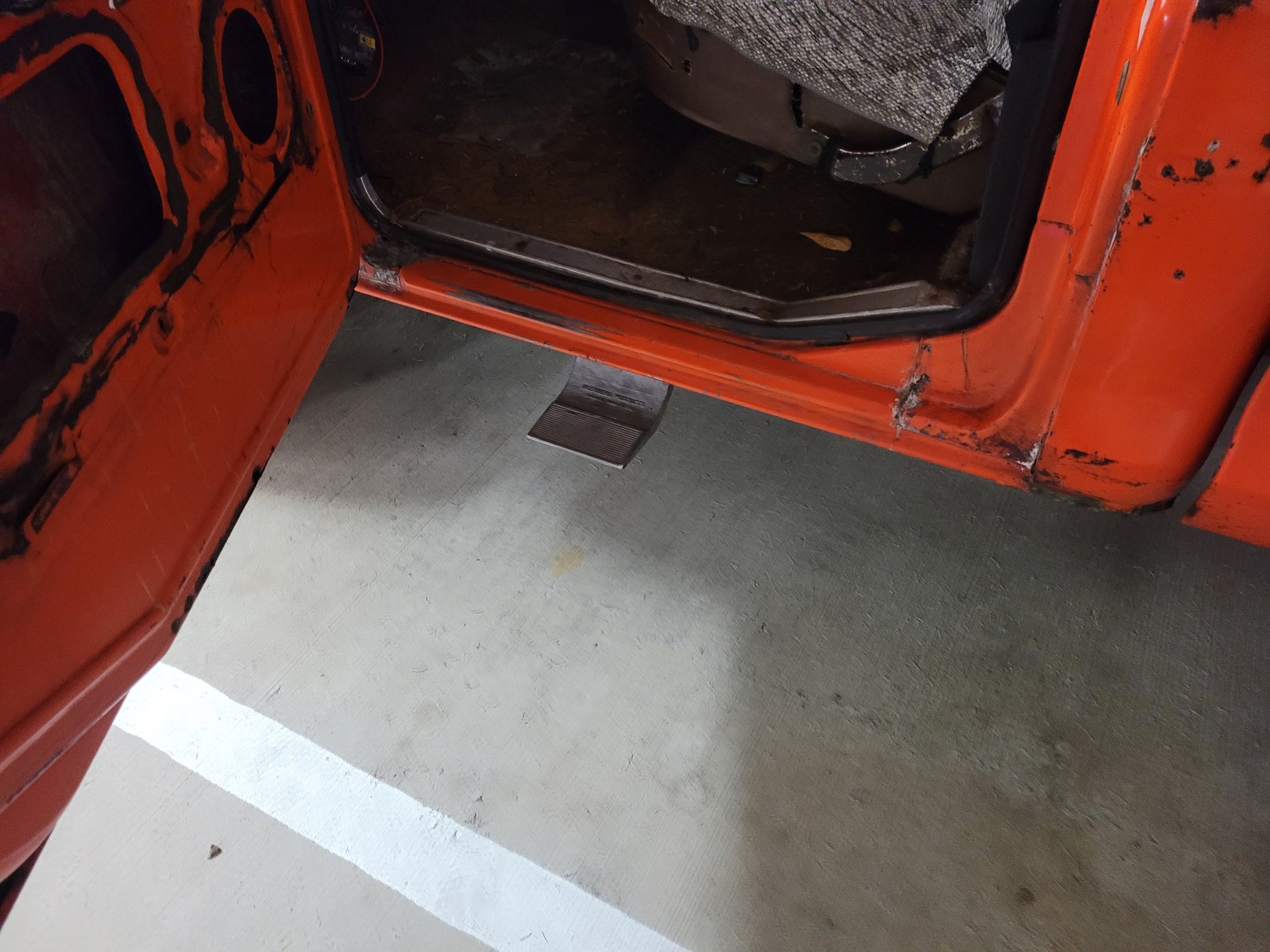

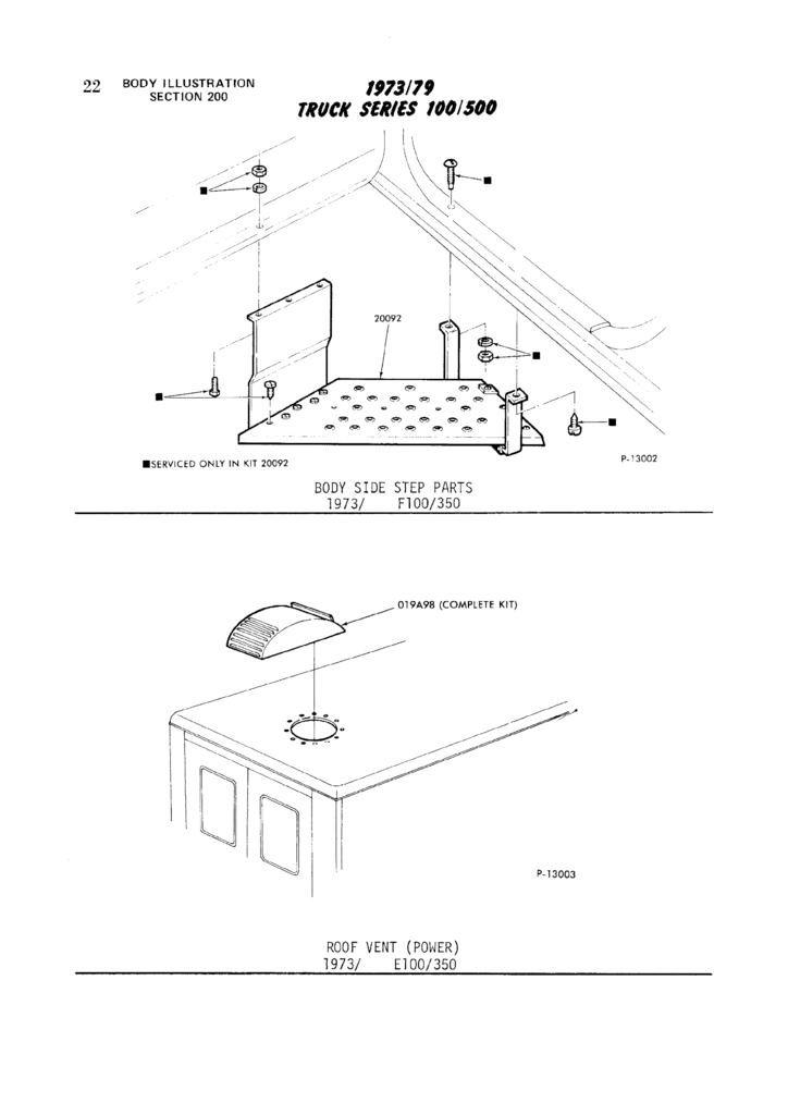

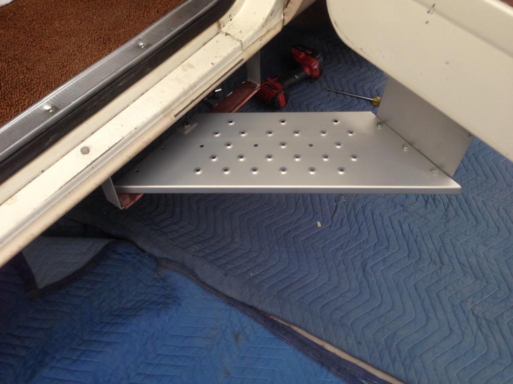

Get a little bit heavier version of this one and washer or plate reinforce the back side of the dash.

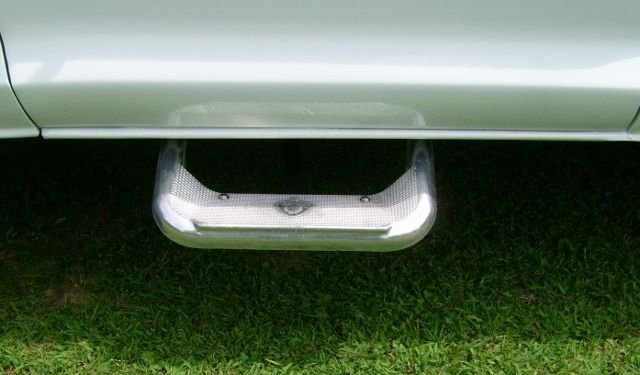

OEM steps
Make/design your own and make them or get them made.
A little shorter version.

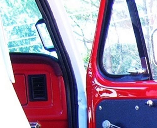

Grab handle idea.
What ever you do for the step if attached to the rocker panel. Stainless steel hdwr, a reinforcement bracket or extra brace. A step attached to frame is better IMO.

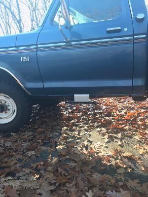

This truck is the only reference I could find online so I know I'm not the only one.
