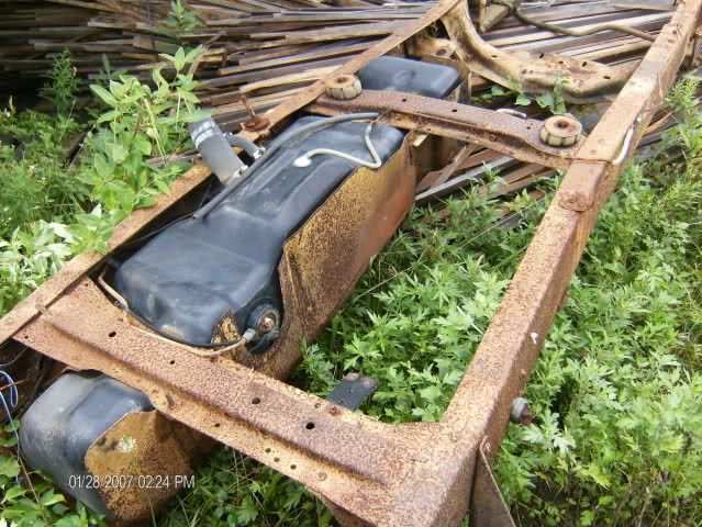

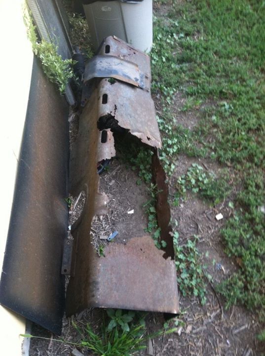

So you are talking about the metal support/skid plate, on the front tank, on a 4wd yes? It should be a plastic tank, but there are also metal tank set up's I think on Super Cabs? A 2wd front tank is metal and suspended with straps. Water soak it and see if you can use a sawzall to cut the bolt heads off. Run it on low speed with a hack saw blade to help keep the sparks to a minimum. A cut off wheel will be a spark maker. Does your tank support look like this?

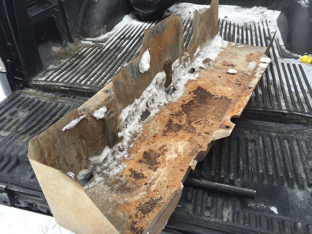

Or like this 4wd w/ metal tank and support straps?

If you have the all metal OEM skid plate you do NOT have any straps. The OEM skid plate is what holds the plastic tank in place.
