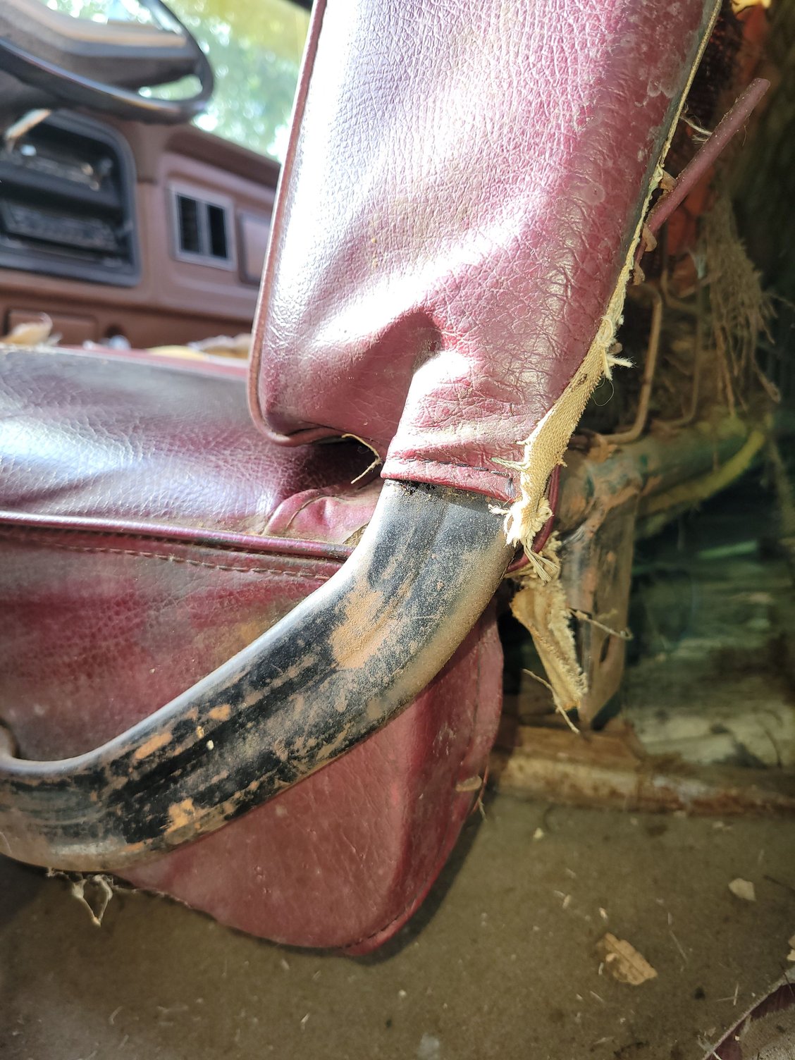

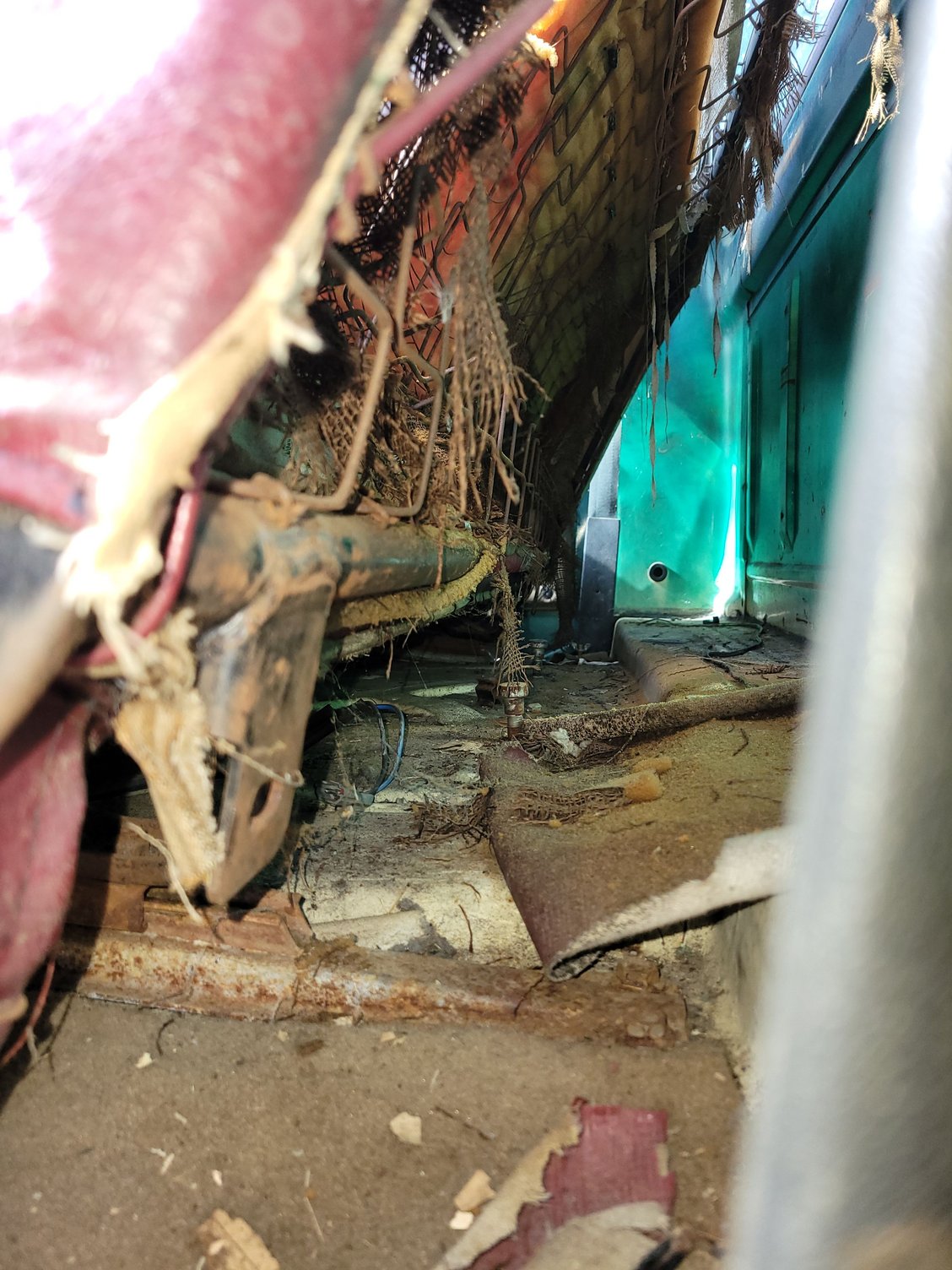

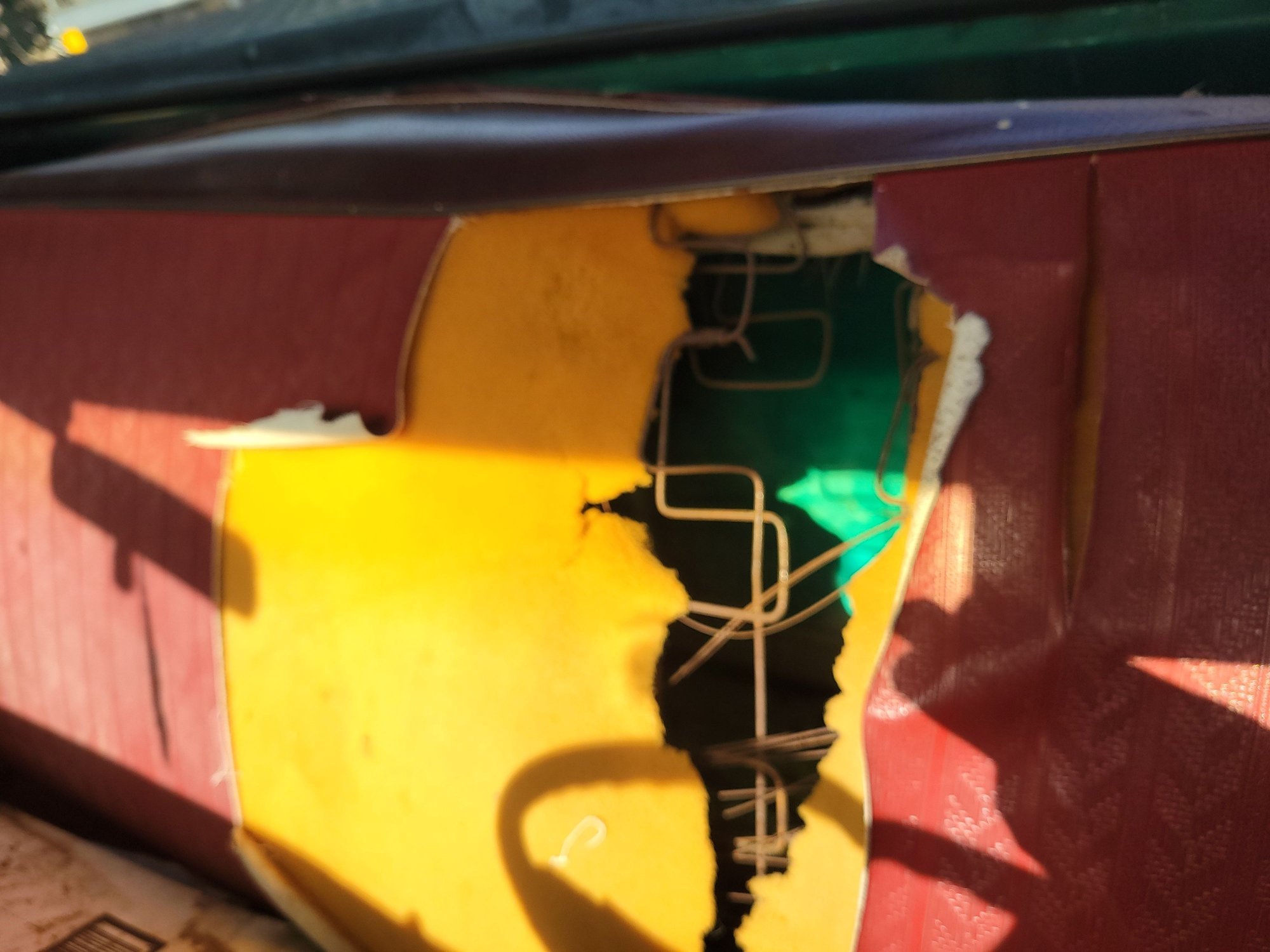

This first pic shows the lack of cardboard panel... but the springs appear fine.
Tried getting a decent close-up behind the seat.
Then more of an overview to compare the back support/hinge.
