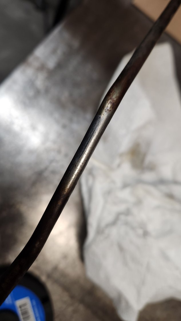

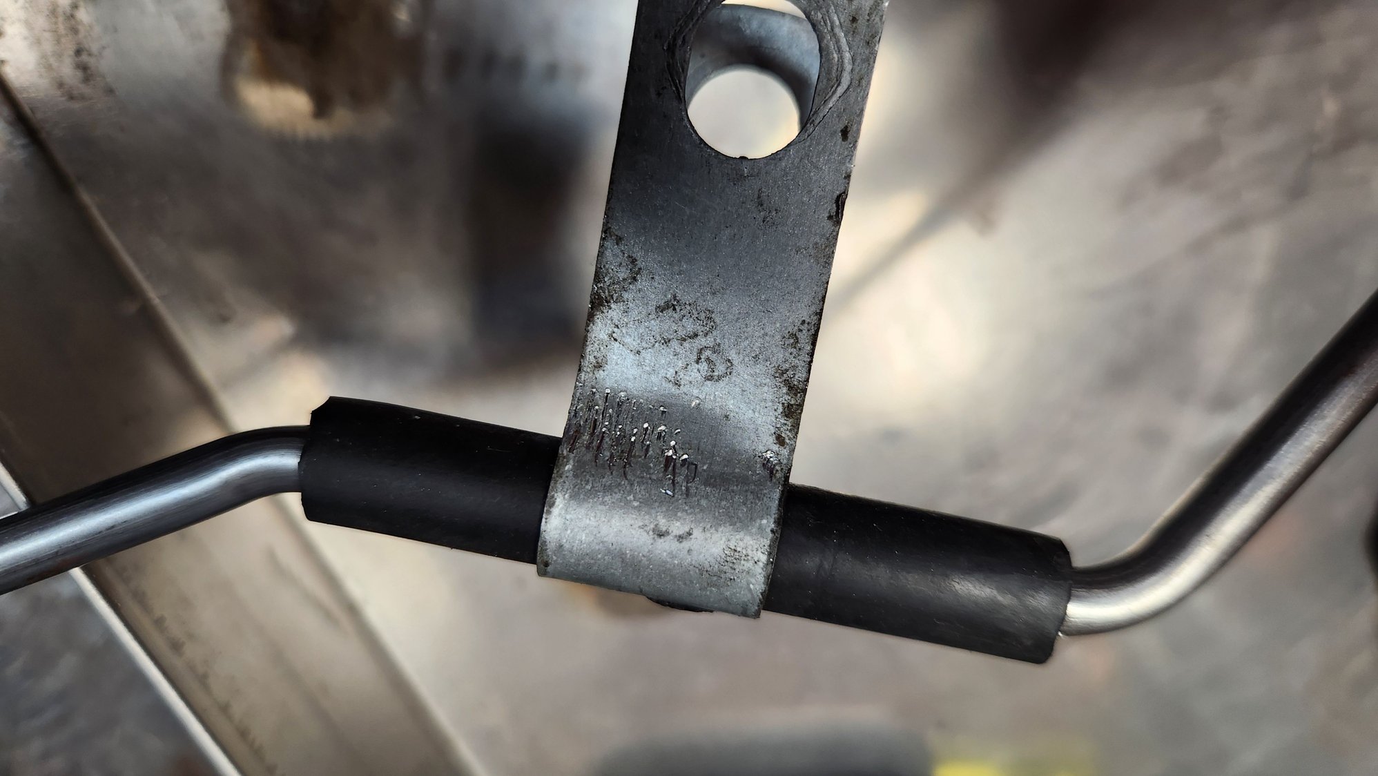

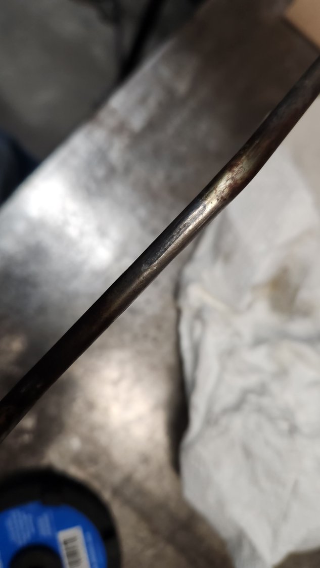

Well I got everything buttoned up today and no leaks. I am glad I decided to do the fuel bowl reseal, my Parker seals were seeping and I didn't know it, plus it gave me a chance to clean some 20 years of crud from the bottom of the bowl, not to mention getting the valley cleaned. I am also glad I did the passenger side fuel line, but I will tell you there are no shortcuts on that one. Yes you can thread the line thru but there is no way to get a wrench on the fitting on the back of the head without removing the intake, you have to reach thru there to get leverage on your wrench. From any other direction it's pretty much impossible plus the down pipe is right in the way. I even thought I could get to it from underneath by removing the wheel liner but no dice so don't waste your time trying that. With the intake out of the way though it is an easy job. Definitely one you don't want to do on the side of the road though.
On the new line I used some fuel injection line, then I straightened the clamp and re-shaped it with an M-10 bolt which made it just the right size to firmly grip the fuel injection line. I attached some pics of my old line, while it didn't look like it was going to give out anytime soon, you can see where it got hammered on for the first 140,000 miles before I wrapped tape around it when I did my down pipes. I rotated it and took 3 pics, you can see the damage right where the clamp was and easy to see why they eventually fail. (pay no mind to the dimple, that's where a curve starts and is normal).
