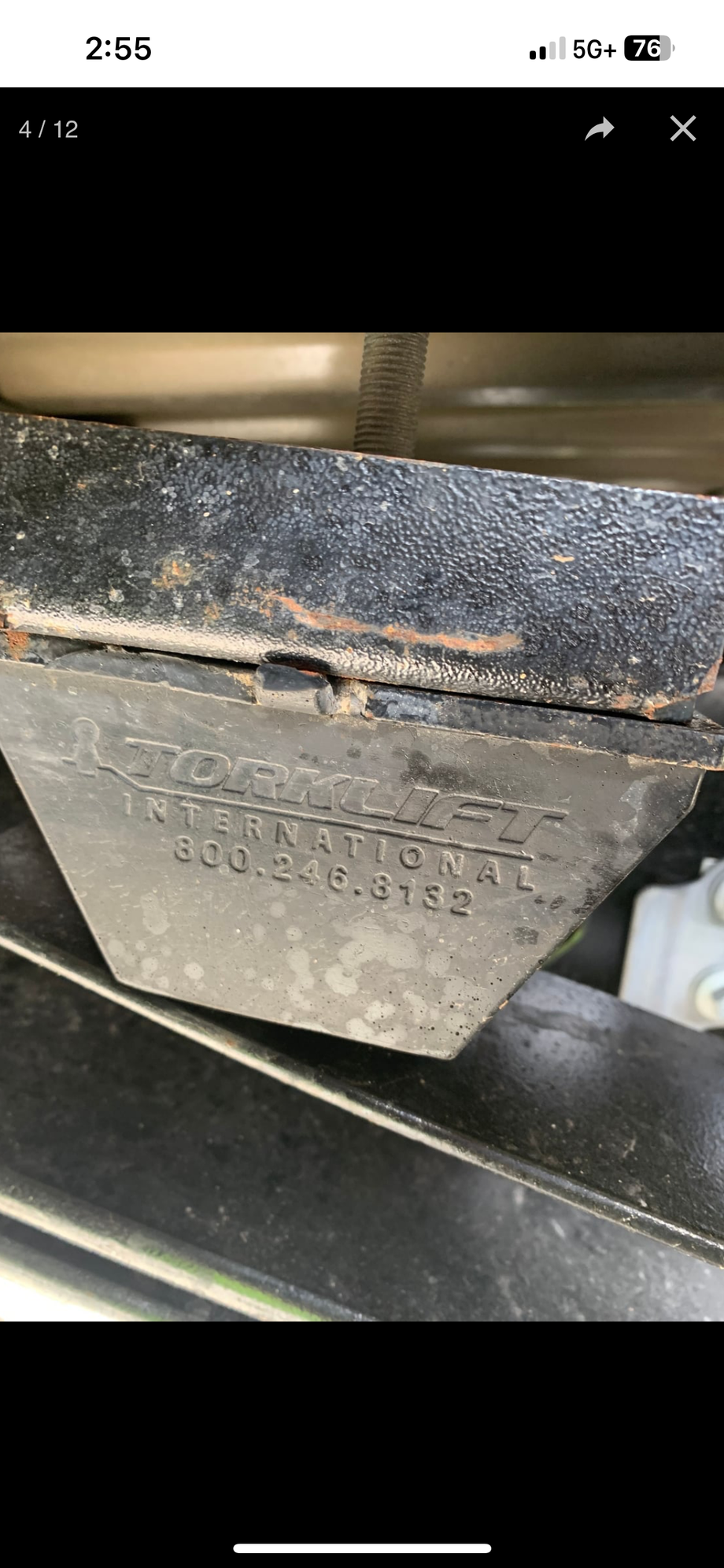

I used the torklift

I used the torklift
seem to see too many of this brand/style getting torn up and falling apart
the SuperSways seem to be more durable. Both have the same concept though.

Here is my Torklift Stableload with no weight on it.
If you want level with a working load on it, you will have to go back to the work truck look with 2 inches more rake in the back.

I have had mine on 1.5 years now and mine are always in contact with the overload as my truck camper doesn't come off the truck. I actually bought mine used so I have no idea how old they are but they are working perfectly so far.
And since you stated they are commonly failing i googled and only found one report of them failing.
