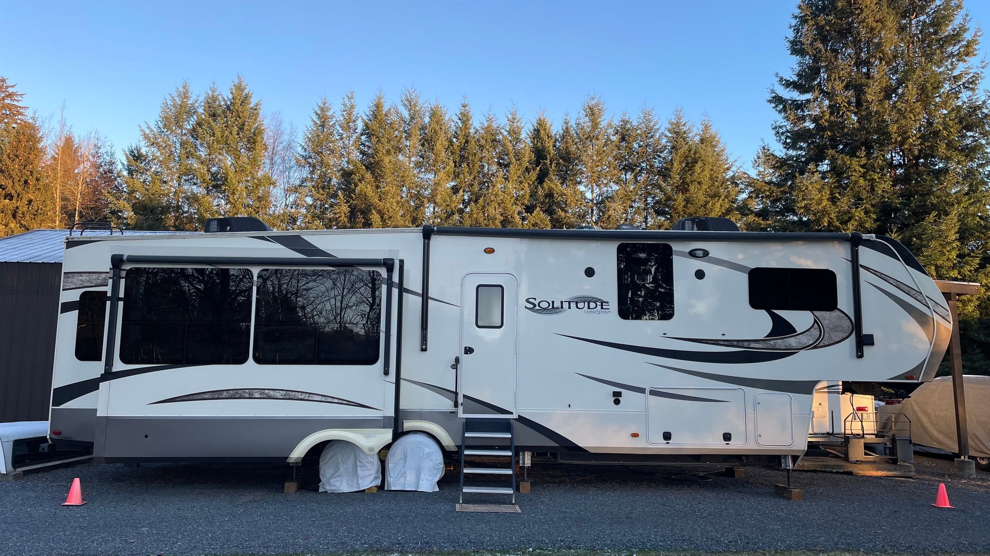

Purchased this 2019 Grand Design Solitude 377MBS 5th wheel, and would like to track the work performed on it here on this forum, gathering opinions, experience and advice from all of you, and contributing from my experiences with this rig as well.
Basic specs on this trailer include:
-Build date: April 2018, sold as a 2019 model
From factory load sheet:
UVW:14,464lbs, GTWR: 16,800lbs, empty pin weight: 3150lbs
-P235/80R16 LRG Tires
-7000lb Dexter axles
-Lippert Level Up hydraulic leveling/main slides
-Lippert Schwintek bedroom slide
-Equa-Flex equalizer and wetbolts
Options/maintenance items installed as purchased:
-5.5kW Cummins Onan generator/Southwire Surge Guard ATS 40140
-40# LPG tanks
-3000W Magnum Energy Hybrid Inverter/charger MSH3012M
-4 225aH-6V NPP AGM batteries
-Kodiak disc brakes/Titan Brakerite actuator
-P235/80R16 LRG Triangle TRT01 Tires, date code 1621, spare is a Westlake, date code 5017
-Splendide WFL1300XD washer and DV6400X dryer
-Upgraded king mattress
-Winegard Connect 2.0 4G LTE and WIFI Extender WF2-435
-RVLock keyless entry
Purchased from a private party on December 15, 2023 for $45,000.

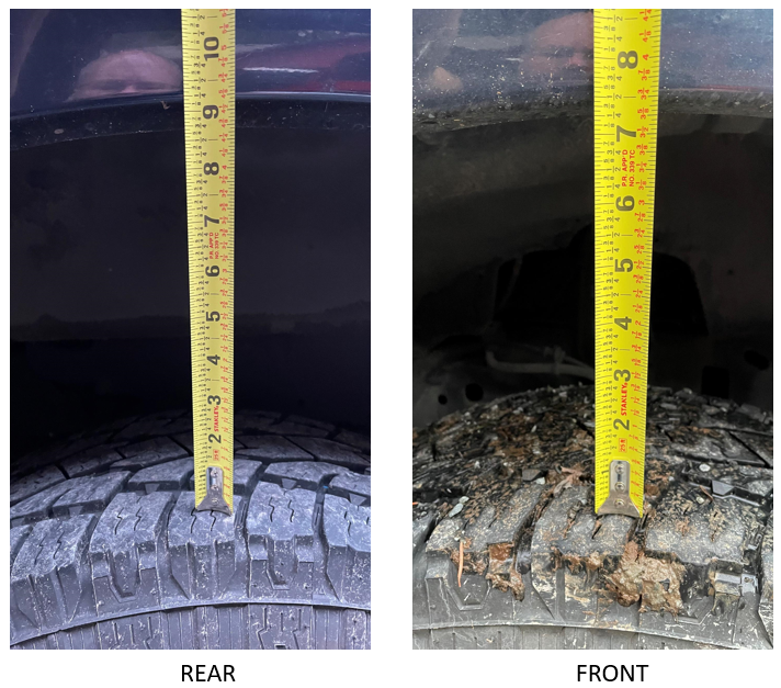

Understood. Log has been started. The original Westlakes were replaced by the previous owner about a year ago, with a Chinese brand. These Triangle TRT01's seem to have a good reputation from my limited research. I will see if I can run them until I move to the 17.5" wheels/tires at some point. In the meantime, will keep them fully inflated to 110psi and check them often.
Checking distances between top of truck tires to fender, with the trailer hooked up, I get 7.5" on the front, and 9" on the rear. 5th wheel is empty, so we have some room for additional loading from a ride height standpoint.
