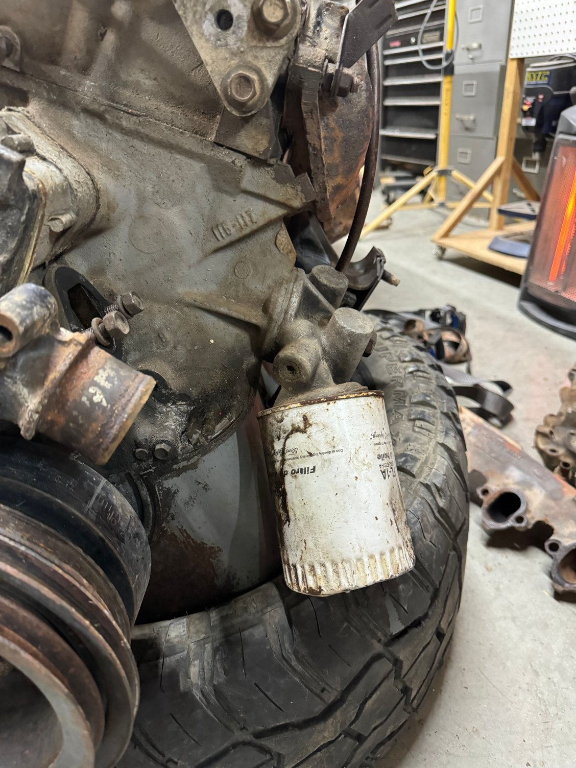

Hello, I have recently purchased a 1979 f350 super cab and am in the process of fixing it up. I found a decent deal on a 460 that came out of a 1979 e350 with low miles. I've also read that the motor mounts are different between the two of these, so what would need to take place to mount this engine and keep all of my f350 accessories. The 460 came out of an rv and the guy claimed it had 18k miles on it. It also has a different location for the dipstick, is there a way to remove the old one and put mine in from my f350 460. Also wondering if I can take off the weird oil filter thing coming out of the block? I'm pretty new to all of this but I'm trying to learn.
-Duncan
This is the weird oil filter thing I'm talking about. Or would it be better to leave it, only thing is I'm not sure if there's enough clearance?

On the oil filter adapter, again look at both motors. From what I remember a 100 years ago on a van I had the adapter bolts on to the block with a bolt thru the center IIRC.
If you unbolt it you then need to swap the threaded nipple from your 460 to the E460 motor so the filter has something to screw on to.
You may be able to loosen the adapter and turn it so the filter clears but note there are 2 gaskets, 1 under the bolt and the other adapter to block that may need to be replaced.

Assuming the supercab already has a 460 everything can be swapped over. Strip the RV engine down to the long block, then swap everything from your engine over. The engine mounts that bolt to the block will be different between a RV chassis and a pickup, so either use your old ones or get new ones for your year/make/model truck. If your current engine doesn't use that oil filter adapter, you can remove it, and use whatever is on the old engine. Also, since it's from an RV chassis, the exhaust manifolds might be different and the oil pan is probably different so you'll probably need to use your old ones. Just take your time, takes lots of pictures and keep everything you take apart well organized. Go buy a couple boxes of cheap zip lock bags and some small notepads so you can label and store all the small parts/hardware, get a wax or paint pen so you can label larger parts, and get a roll of good quality masking tape so you can wrap hoses/wiring to label them.

X2 on what Speedfreak78 said. I did the same swap last year on my F350. It will bolt right in if you use the truck engine motor mounts. As for the oil filter adapter...I removed the RV version and found the right size threaded nipple on Amazon for like 10 bucks. Screws right into the block and then you'll be able to thread on an FL-1A. The RV engine also has the dipstick in the pan (for trucks, rear sump) versus thru the block (car version, front sump)

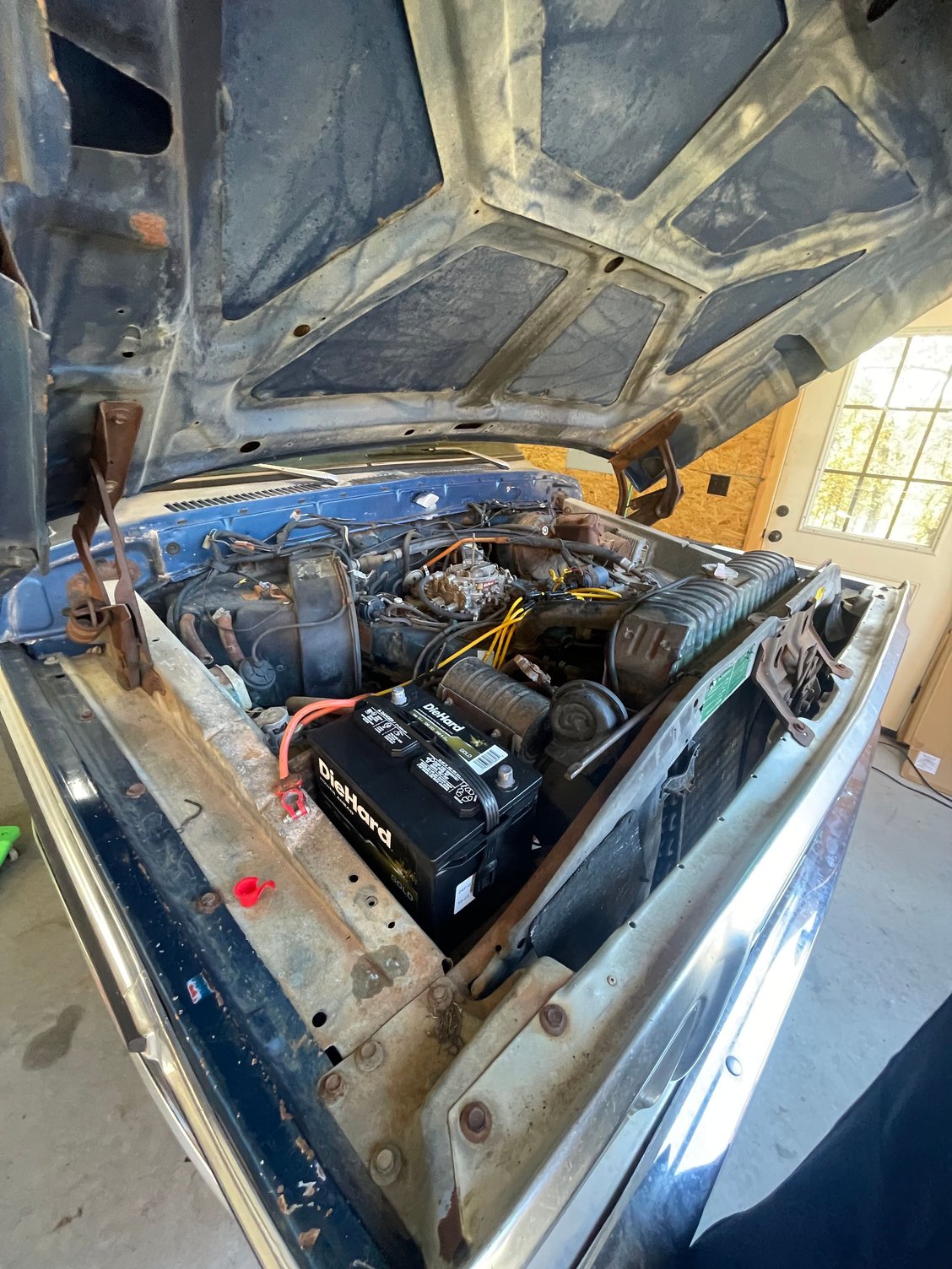

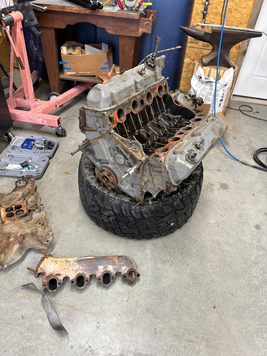

Here are some pictures of the new engine and the current one, I apologize for how bad of a picture the third one is of the old engine.

I would tear it down and have the block, dissembled heads, and intake hot tanked and start from there even if machine shop work is not in the budget based on what I see.
The by-pass of emissions with those "hillbilly" block-off plates are a reason to internally inspect he motor.
