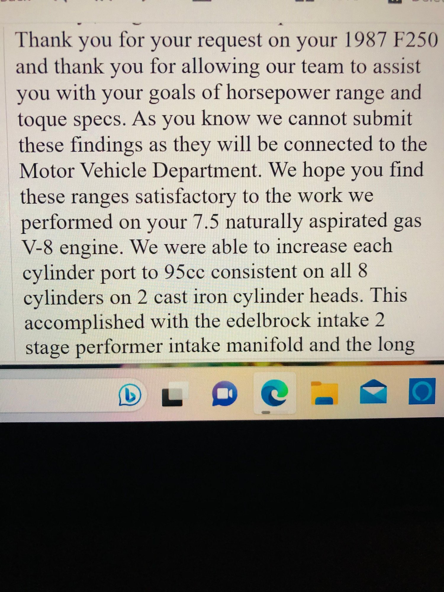

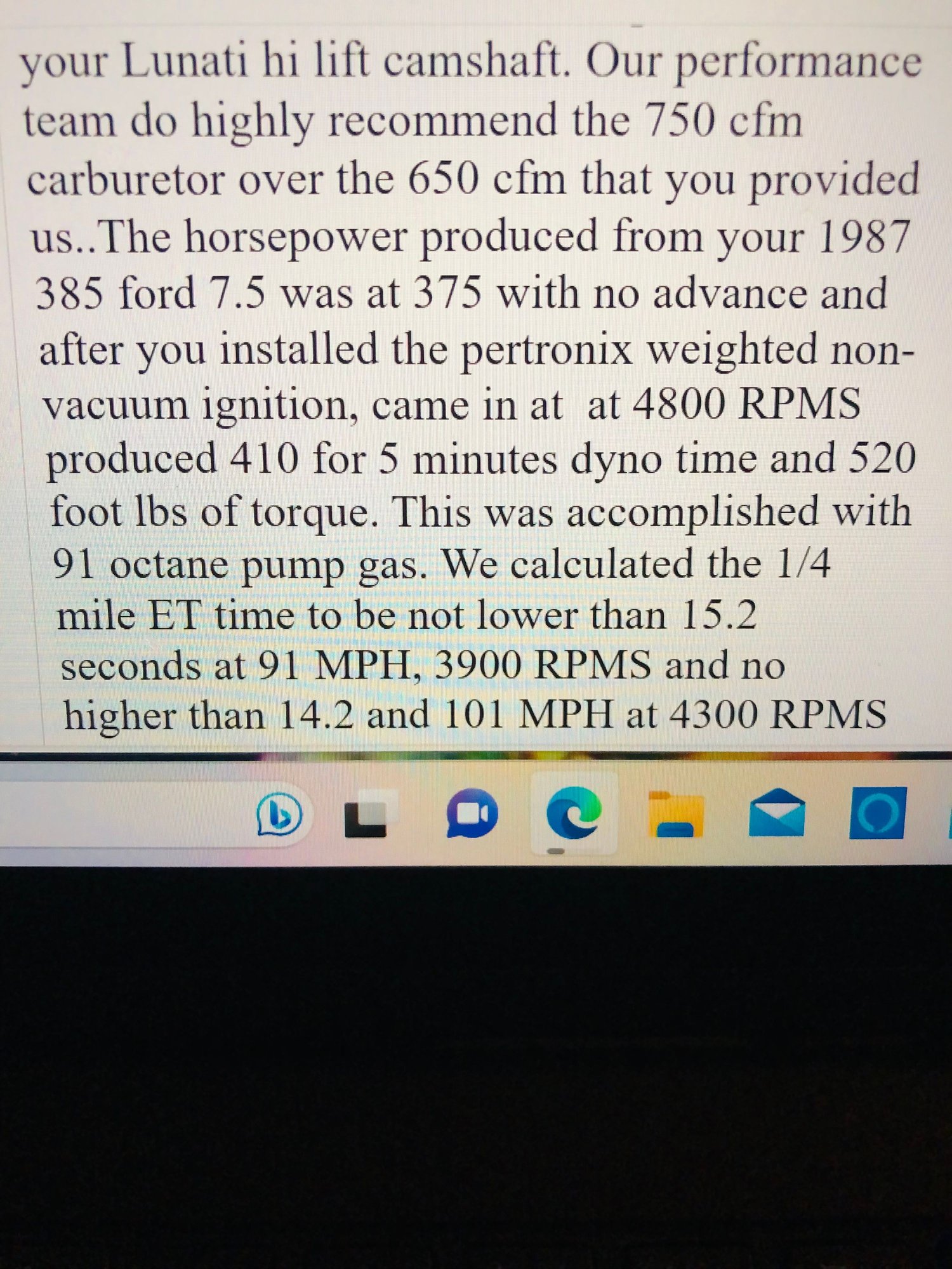

Tech Geeks.... I'm curious what are the pros/ cons on using a 650 cfm carb when the engine tuners recommended the 750 cfm?
Here's tuners comments:

CID x max RPM / 3456 ... 460 x 5000 / 3456 = 666cfm
What is done to the engine to make that HP? No accessories? 410hp is basically gross rating...I would run the 650 and install/borrow a vac gauge to check vacuum restriction at WOT. I would assume the place should have this data on hand if they have the ability to dyno the built engine. If you have restriction, then yep would probably need to step up in size. Also, depends what you consider max RPM for the thing since the HP peak is 4800rpm.

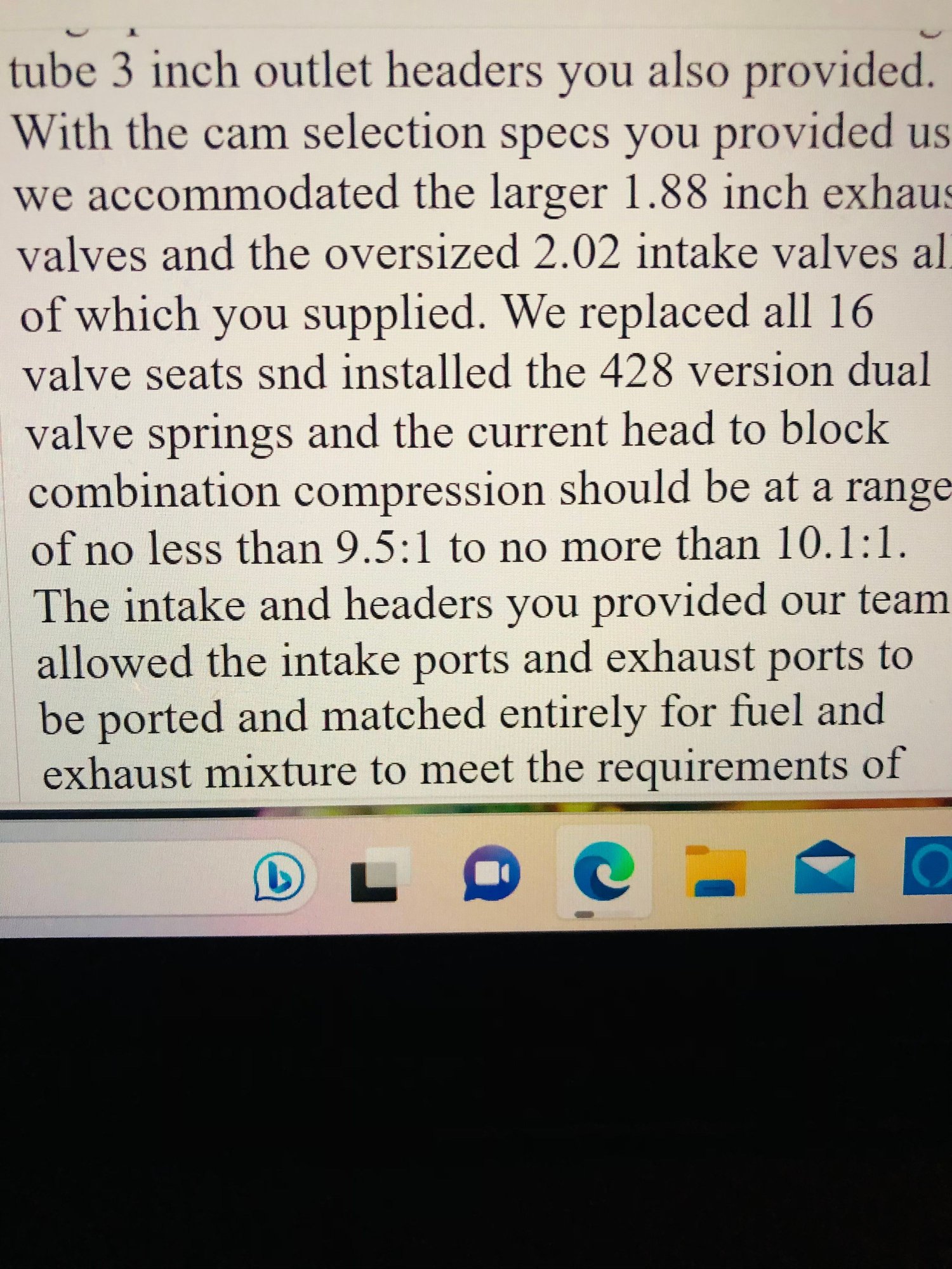

Good points thanks.... I'm not a tech so when you ask "What was done to the engine?" Do the attached build sheets not answer that? What am I missing? Thank you
Old Dec 22, 2023 | 12:37 PM
Hit Man X's Avatar
Hit Man X
Joined: Sep 2002
Posts: 9,540
Likes: 2,031
From: North Texas
Just appears like mild cam, Edelbrock intake, cleaned up OE heads, fresh pistons, and headers?
