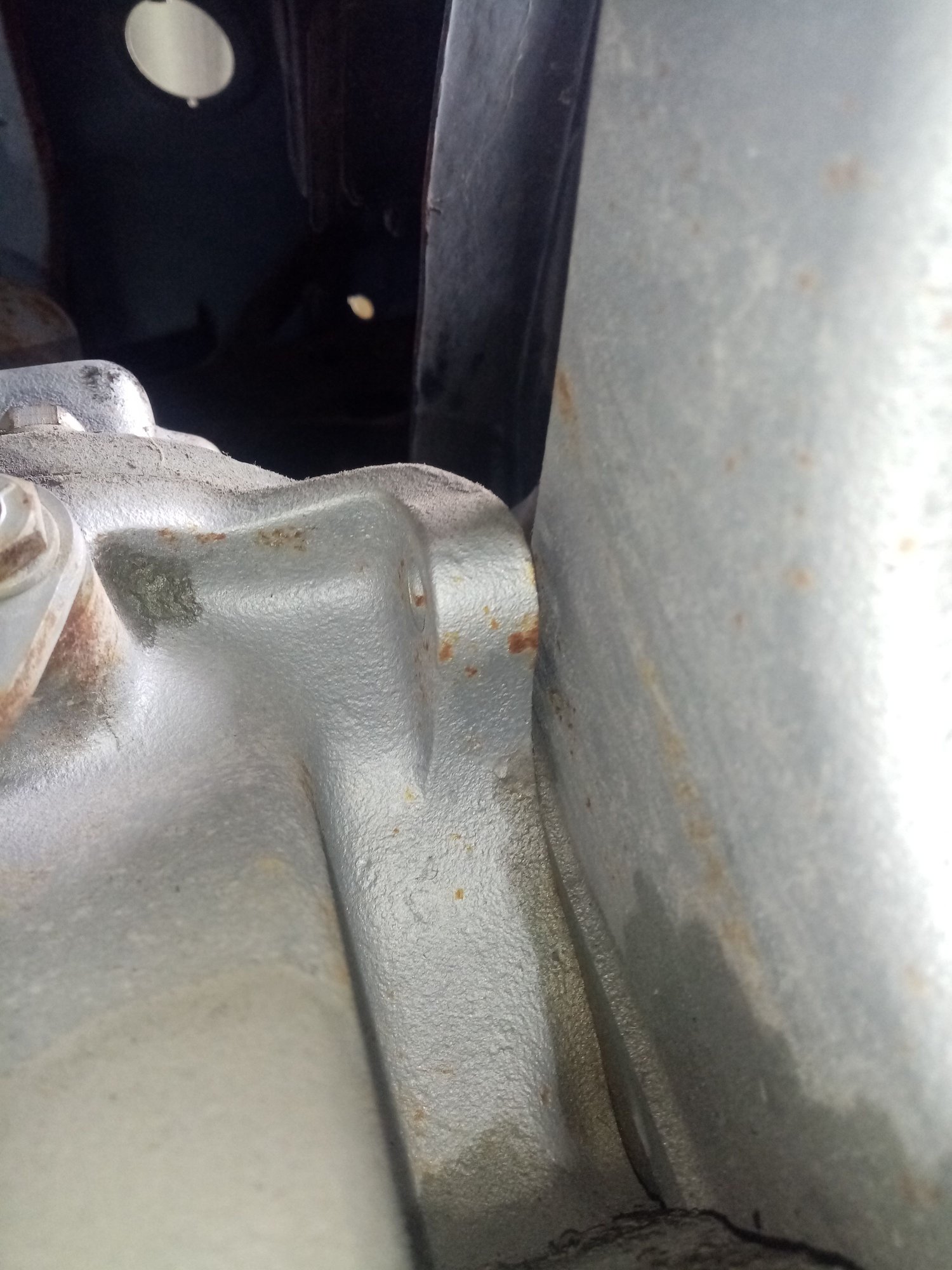

Gearbox transmission
I finally unlocked the secret of my gearbox!!!
The data indicates a 3 speed gearbox (transmission A) but as it is a military vehicle, it had to be replaced by a specific gearbox which was used a lot by the military and which would be the GM SM420 with 4 speeds!
If anyone knows and can confirm me with the photos, in all the photos on this site correspond completely to mine SM420

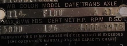

Yes, that looks like an SM420 to me as well. The date code on it reads September 28, 1962 so I'd suspect that replaced the original 3 speed at some point after it reached Germany. If Ford had done it at the factory, I'd expect a blank transmission code rather than the A. Do you have the original steering column for this truck?

And here's what's on the data

Yes, your steering column is set up for 3 speed with those two shift arms sticking out and the nub on the steering bowl - so I'm sure that's how it left the Ford factory. The SM420 is an interesting swap but makes sense given its military history.

Yes, never know who changed out the gearbox. The A1 rear axle is a 3.73 locking rear - good that it's locking, bad that ratio is fairly tall. In Germany - after a couple of good long winters and getting stuck everywhere they go - comparing a 3.03 first gear ratio of 2.99 to an SM420 of 7.05 it might have been an easy decision to change that out and make the truck gearing much lower. The motor pool guys wouldn't have had internet, computers, cell phones, probably no televisions to speak of and radio stations that broadcast in English were probably not super common. They would have likely jumped at the chance to swap it out and may have ordered it. If they got the drum parking brake on the rear of it working, it may have proven handy to use in conjunction with the standard parking brake when they were loaded and stopping on snowy/icy ramps. Cool that it bolts up to the back of a 223 bellhousing or they've done something special there.

I looked a little more at the subject and everything had to be modified because the gearbox fixings are not used, nor those of the original bell housing and we find, inside the bell housing, these screws added for fixing
