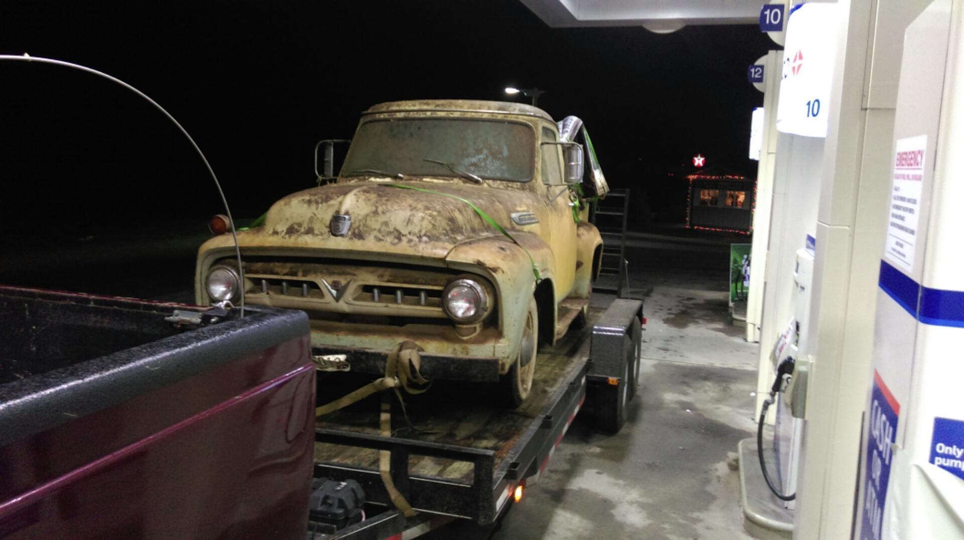

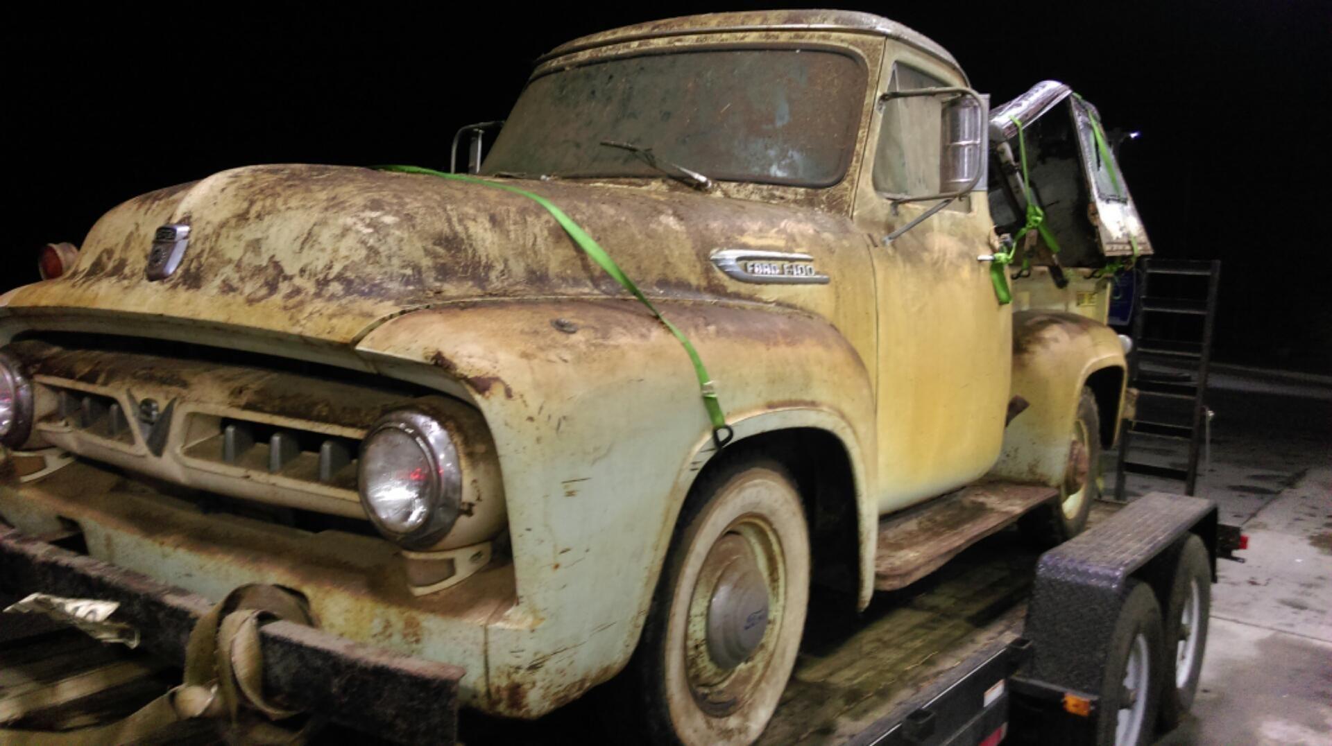

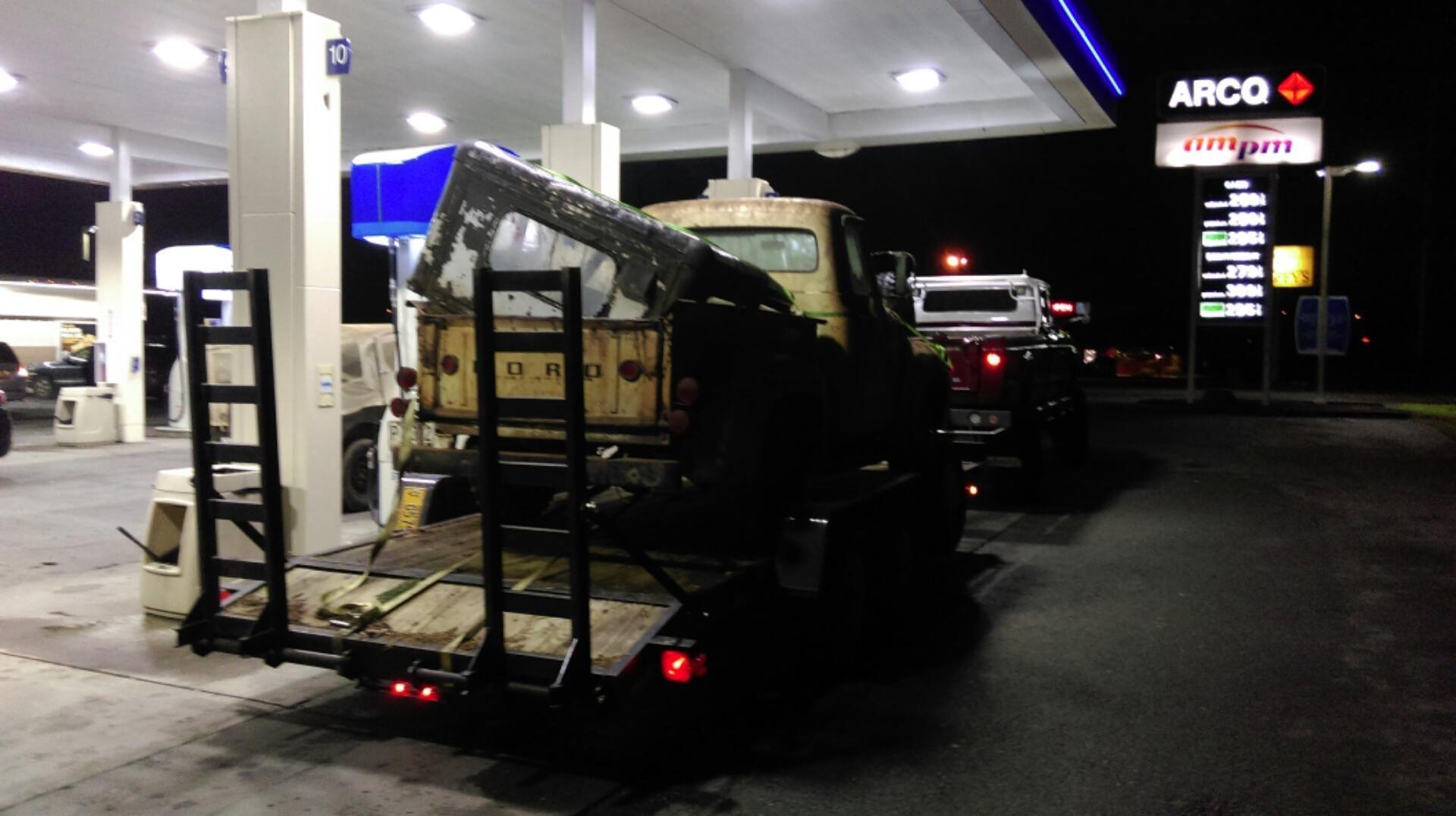

I had to go get it before I could get pictures. Now the real work begins!

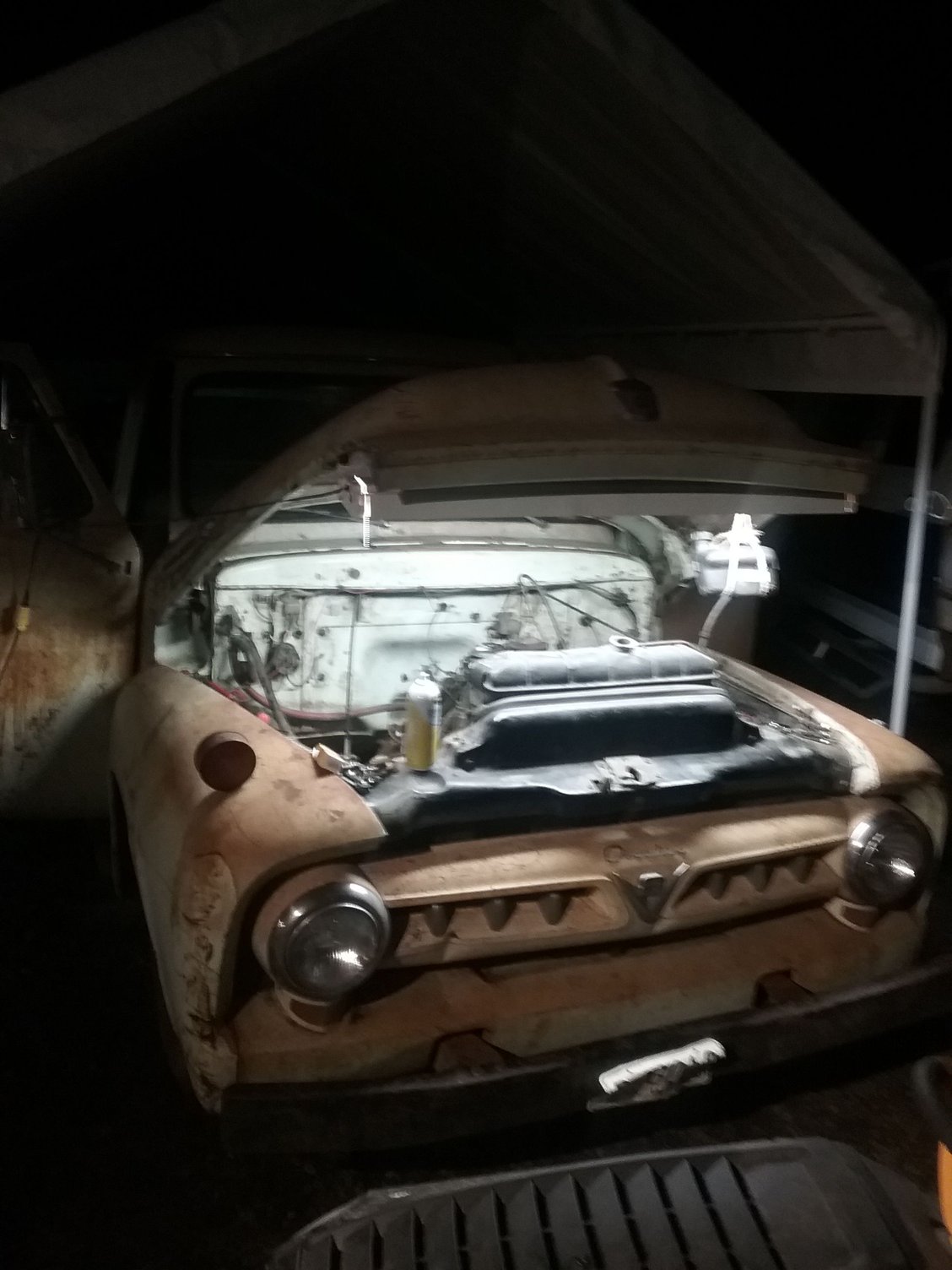

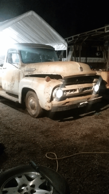

I will do my best. I put Marvel Mystery Oil down all the cylinders and let it sit for a day. We then hooked it up to a truck and got the motor to free up. Next step will be to get a 6 volt battery and put fuel to it and see what happens!

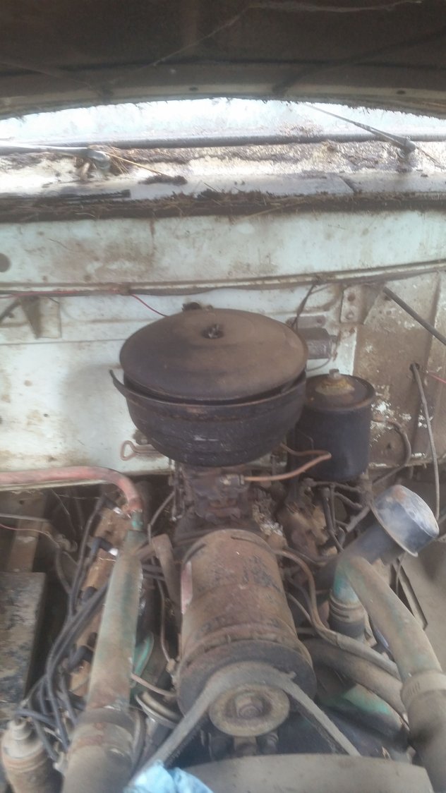

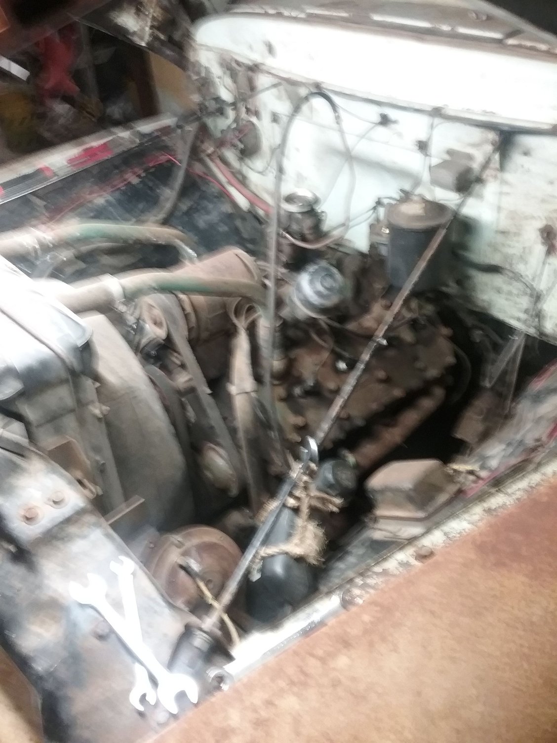

A few days later......!
I got the motor freed up atfer a soak with Marvel Mystery Oil. Next I had to free up the water pumps and generator. Now onto replacing the bad points. Reinstalled the plugs that came in it after hitting them with a wire wheel. Oh and the battery was toast...of course. Once all that was done and it had been cranked around to get oil back up into the motor we cleaned out the float bowels and put fresh gas to it. With a little cranking and some help from some starter fluid it happened. AFTER 50 YEARS IN A BARN THE FLATHEAD RUNS. Now hit the start button and it fires right up. It even sounds AWSOME! Now to make it move and stop!
