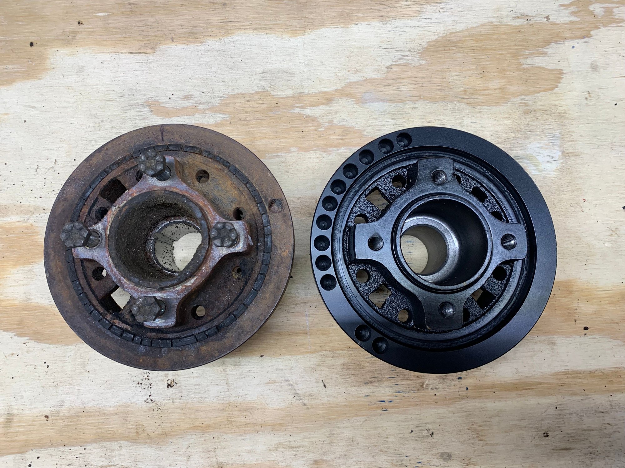

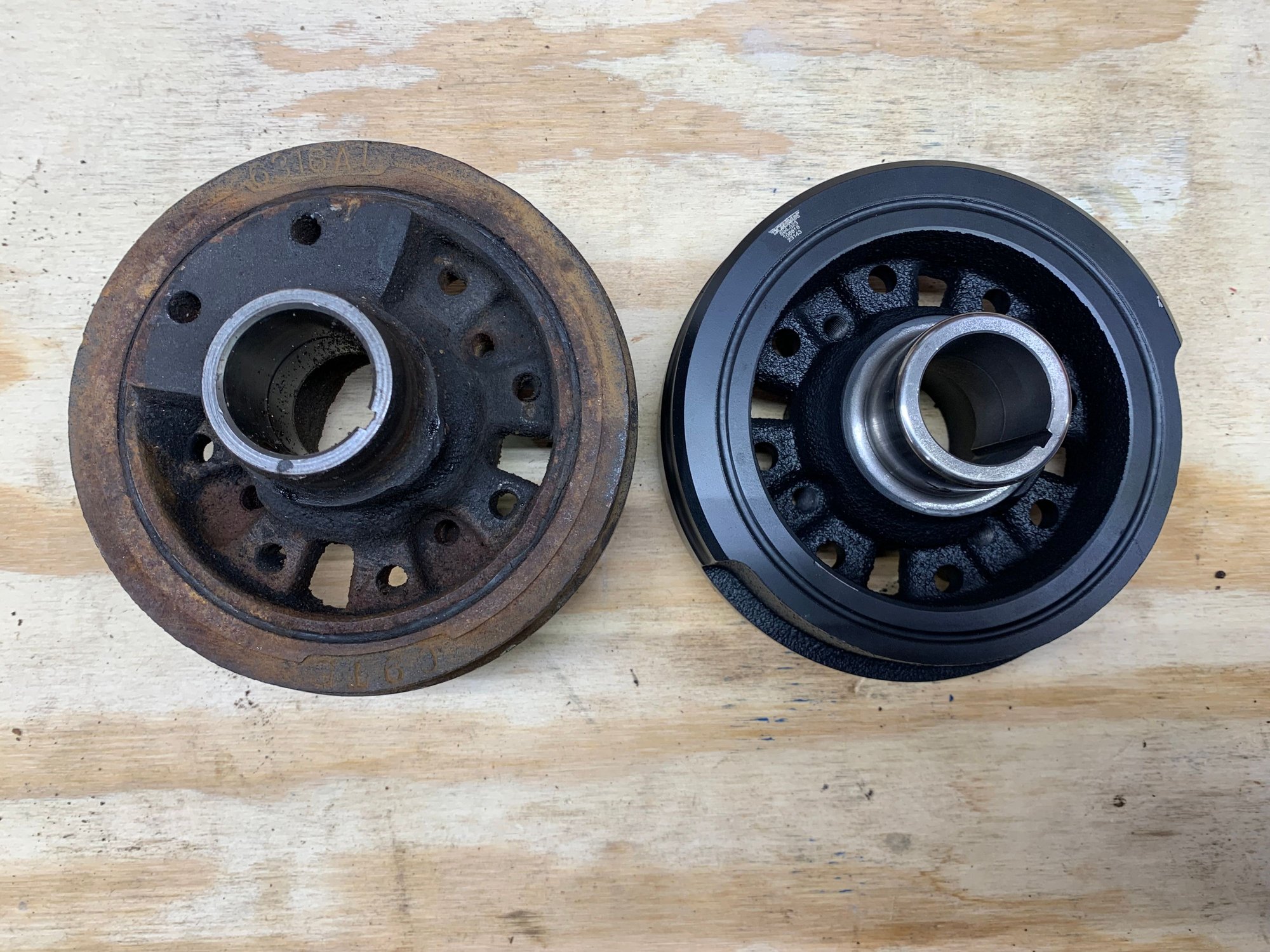

I have a 1970 F100 with 302 and C4. Everything is original on the truck. I want to replace the Harmonic Balancer as the rubber looks old and the belt pulley is wobbly when engine is running.
I have the old Balancer out and I bought a new one from NAPA (NOE 6005226) which is really a Dorman 594-023. The new one looks different from the old, but supposedly is the right one.
From what I understand all the Balancers are 28oz imbalance up to 1981. The new one looks thicker and feels like it's a bit heavier. They are both 4 bolt. Can someone tell me if the new one is the right one (they tell me it is also a 28oz).
I attached pics of the old and new.
BOT view
TOP view
Side View. The newer one looks thicker
Side view. Timing marks seem to line up correctly.

If you look at the first picture where the weight is on the old & new other than the size, old larger in 1 area, new spread out but same place I would say they are the same.

The two styles are interchangeable. The older style from your 70 has the imbalance weight in the inner hub while the later style replacement has it on the outer ring. It still performs the same.
