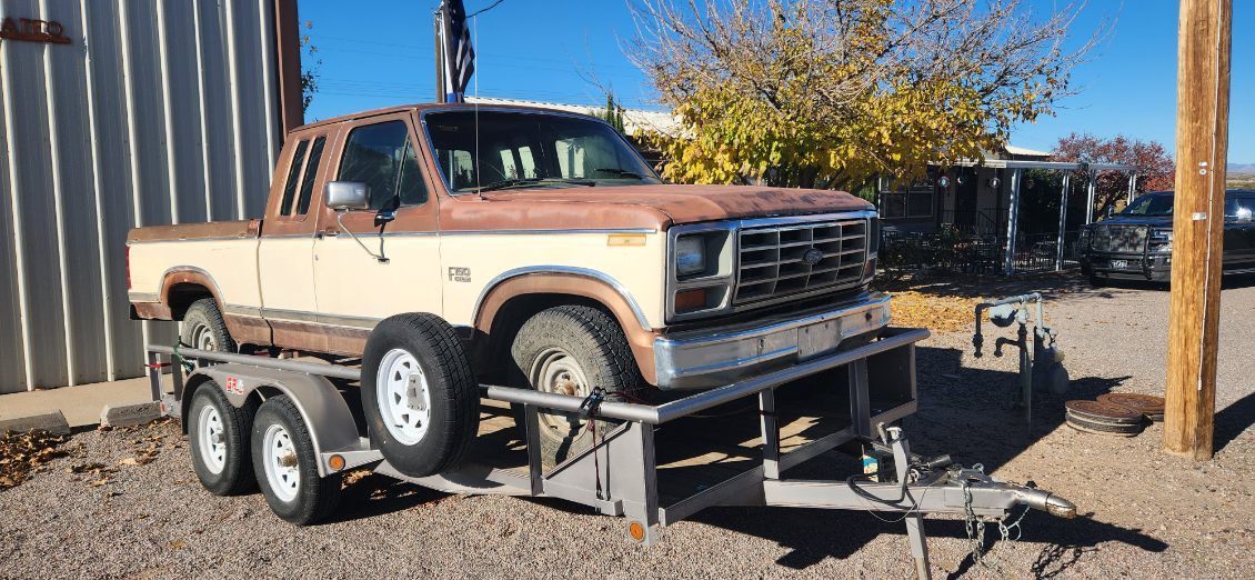

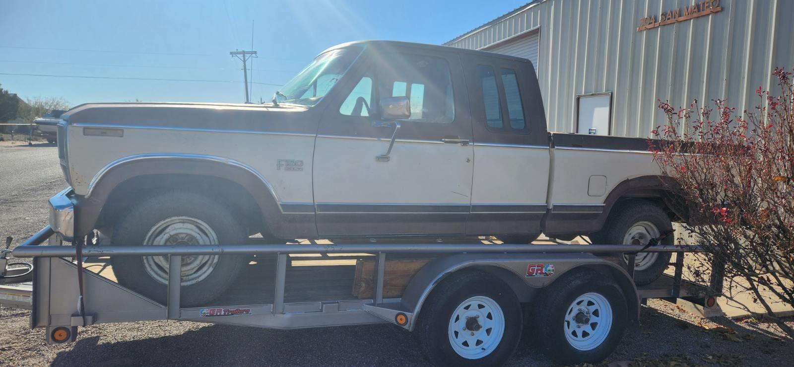

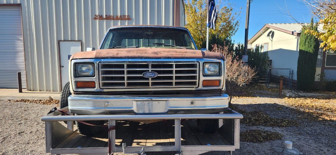

This came off a ranch in the area used to gather firewood, driver, it will need a new seat, the 40 years work have taken a toll. The rest is in pretty good shape for a 40 year old rig.

Ist thing I would do is try to get in there and put paint or oil inside the rear cab corners. I think those extended cab trucks like to rot worse than the regular cabs do. Looks like you have got a good one with no or little rust. You can also check the seam that goes from the roof gutter above the door to the rear window. The caulk in the body seam likes to crack, and this is what rots out the cab corners. That is, when it rains which you probably don't get much where you are at?

I had an old Bronco that had the roof seam needed attention, I'll check the cab corners for rust and add some oil. I'm thinking there should be a bunch of these in wrecking yards for parts. Tailgate handles missing to start.

Another problem area is the third brake light. That seal is probably non-existent if it hasn't been replaced. That's what rotted out my cab corners.

Very nice. What motor and trans?

5.8 automatic, I have had a 300six 4speed loved it for climbing walls.
