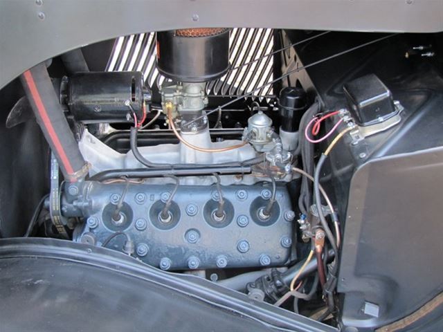

my first car was a 50 crest liner, we dropped a merc crank into the 8ba making 255 inches, that shot i posted is a 34 Woodie , with a 37 21 stud ford replacement engine, 34 truck iron heads , as the early 8's used alloy heads ,the cast iron were less prone to electrolysis like the alloy heads were

Now that is going to be a fun project. I doubt there of more than 10% of the originals still left. If rust didn't get them, rot did. I would not be opposed to putting a nicely built 8BA, or CM, in the 35. Back it with a Tremec 5 speed and it would be a fun ride.
