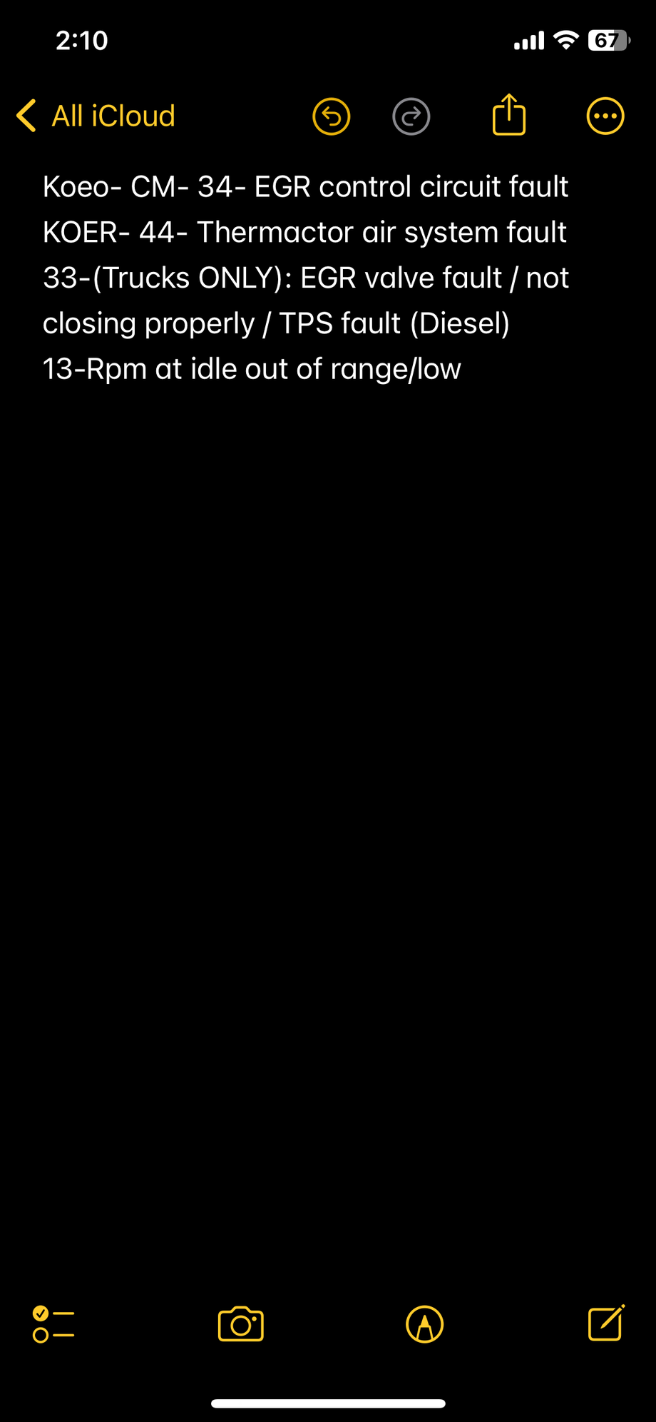

What do I do to go about fixing these? I’m not in a rush to fix them so if I have to buy stuff it’ll take time. But I want it to read 11 eventually. I did replace the EVP. And for the 13, and 44 I do have some sort of vacuum leak under the plenum, if brake cleans sprayed under there it’s idle changes. It is running lean by what I’ve been told. The egg passageways are clear, and I have 4.9v to the EVP KOEO. Im not sure what the other codes mean.
