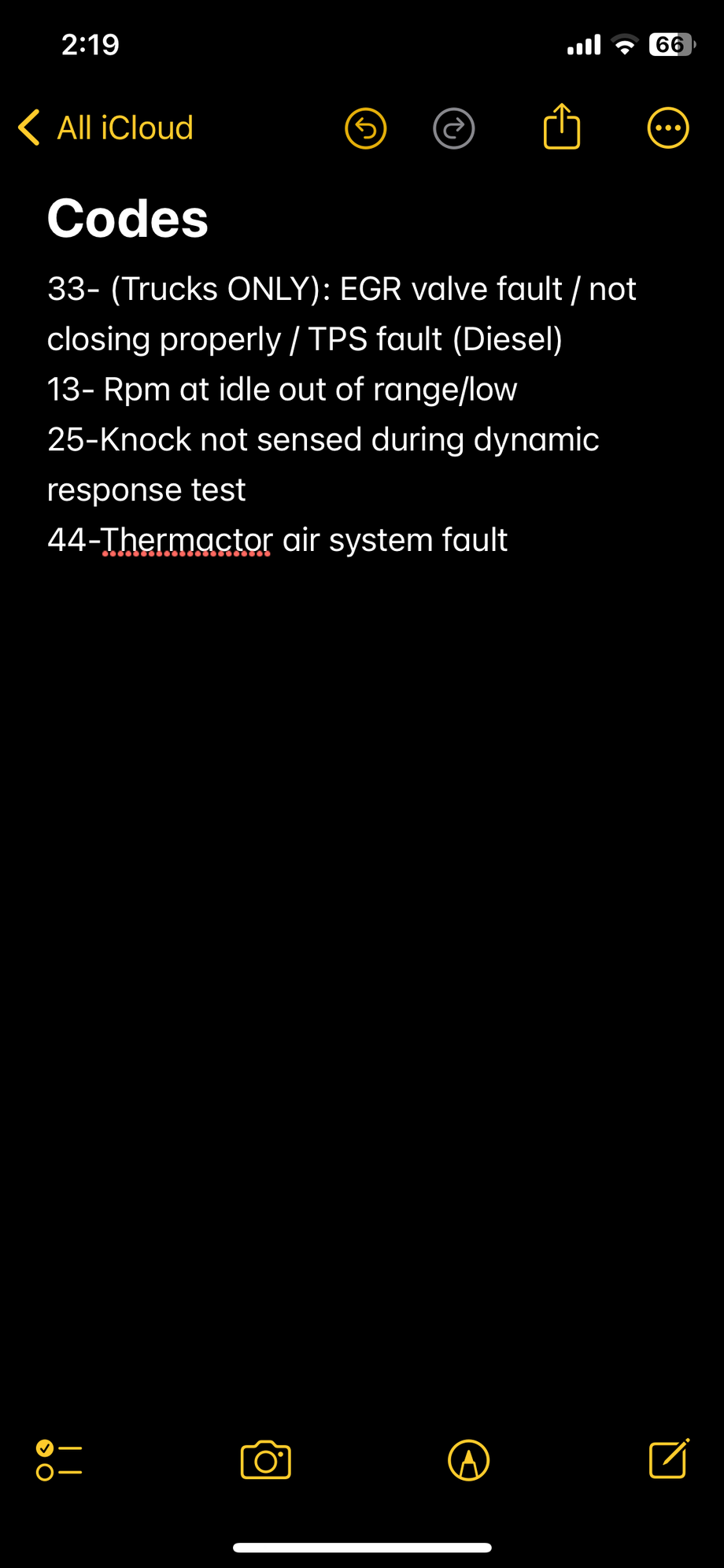

How do I check the egr valve? Something said to check that and if it sticks it will ping under load. I did a KOEO test and there were no current codes but I got code 33 in the continuous memory.

KOEO- 33 continuous memory
Koer-
Making some headway here, egr hasn’t had vacuum. I put the HVAC line on the EGR and it sounds like it has a cam now, and it tries to die.
Starting off, why doesn’t the line to the EGR have vacuum? Second what is the choppy cam like idle with the EGR hooked up saying?
KOEO and KOER- I also have a code 34- EGR control circuit fault with the egr having vacuum

That code will sure do it
Make it run like crap
The processor wants to see EGR flow and relies on the sensor to say it opened and closes
Your code 33 is saying the processor does not see EGR pintle valve movement.
Replace the EVP with a Ford one (after inspecting the valve)
There are pinpoint tests for that code 33 so you can verify the EVP failure or not

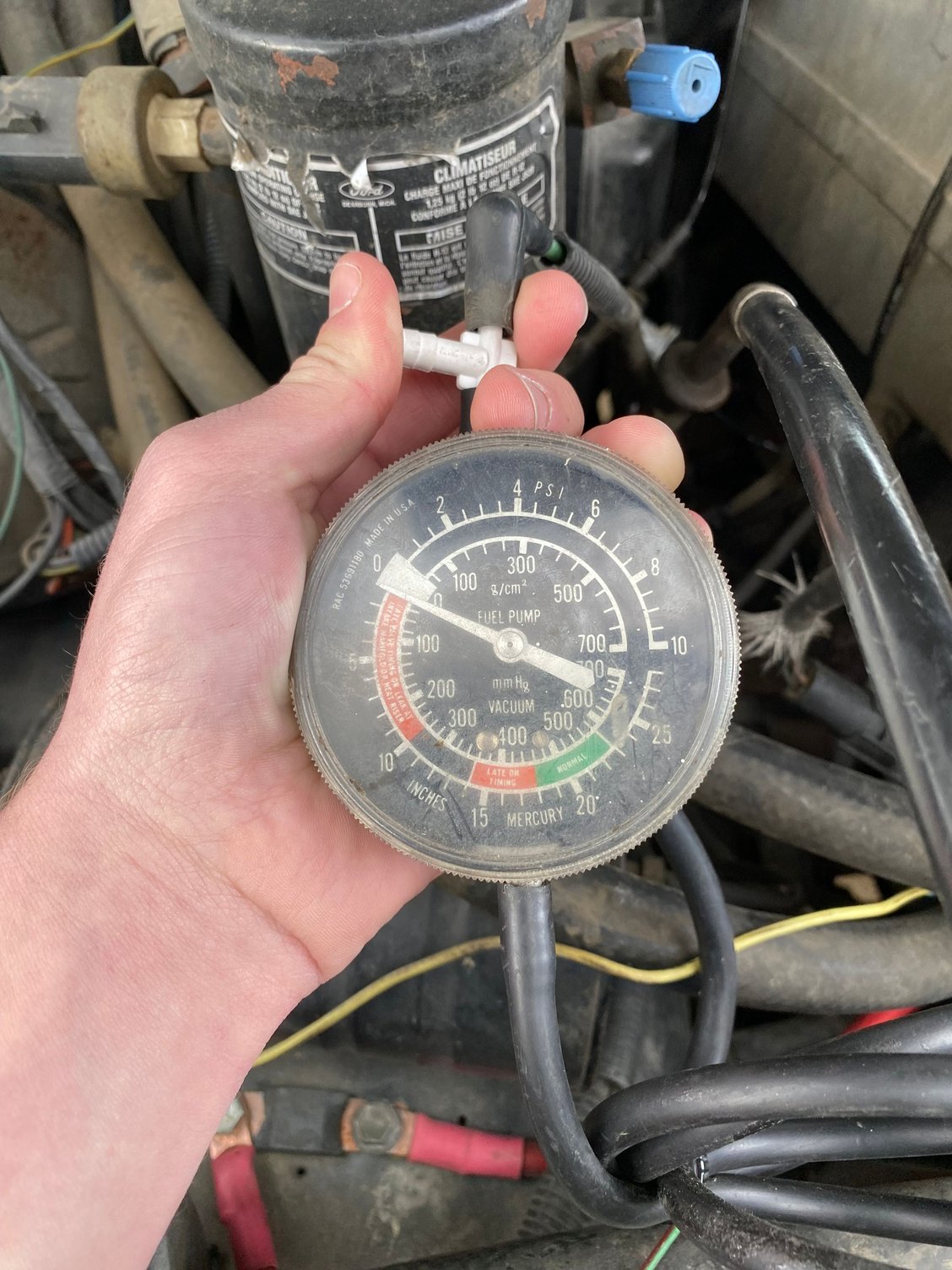

I’m looking up the parts that I could possibly need, the EVP doesn’t look like motor craft makes it anymore I don’t see it I see the other brands. And the EGR valve same thing. And the same thing again with the EGR control switch.
I will get a loaner vacuum pump and see what’s going on with it, but I was just trying to find the parts so when I find one of them is bad I can go ahead and order it without searching.

Egr valve moves. I didn’t take the lines off of the EVR they are stuck. The EVR read 49.50 ohms. The EVP wasn’t reading any ohms no matter what I did. So that’s bad right? The EVP has 4.9v KOEO
How would the EVP cause pinging? Any other tests I need to perform? All I did was apply vacuum to the egr and test the resistance on the sensors. I am going to start it up in a second and check for vacuum to the EGR

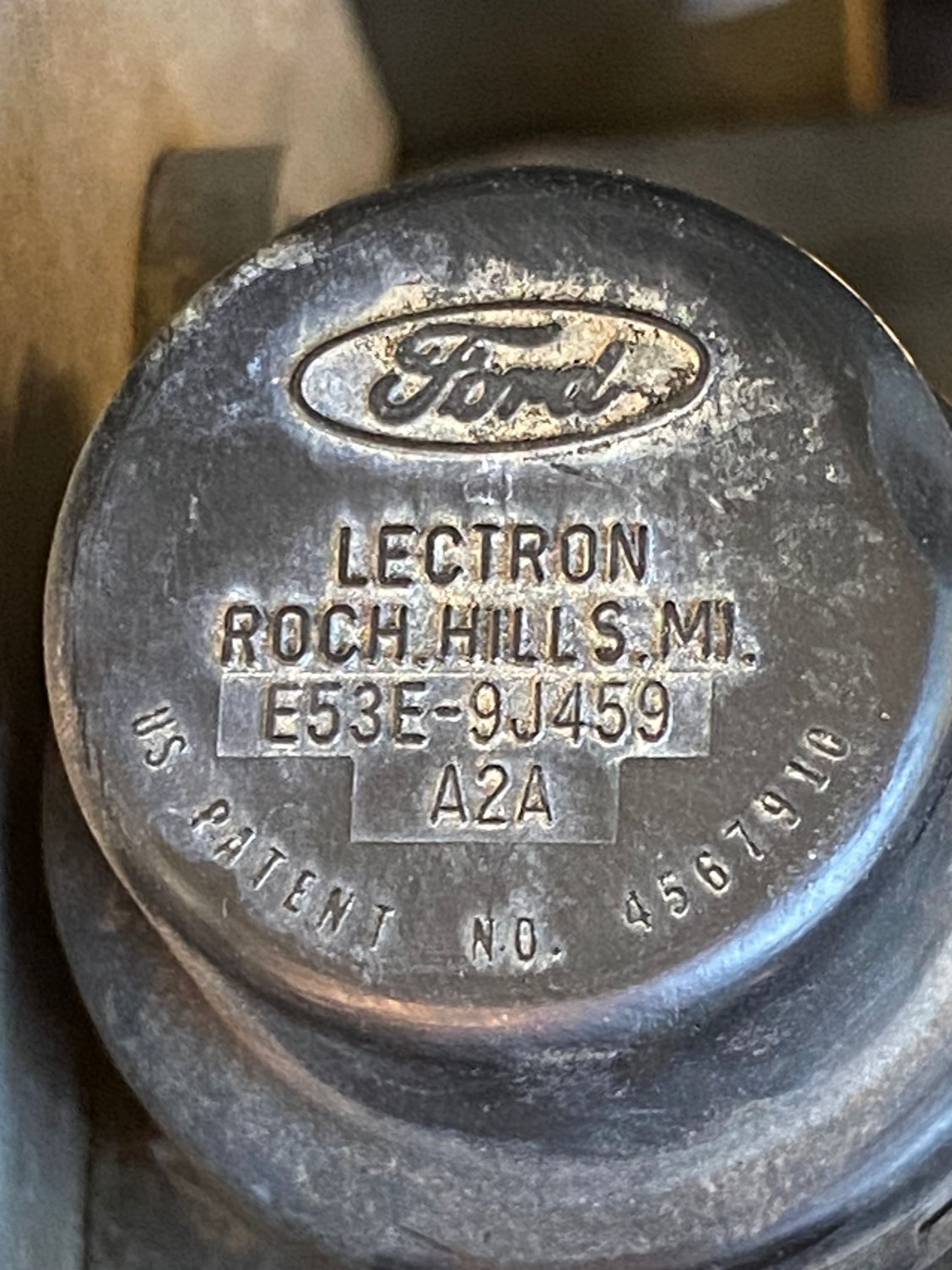

Just drove it, and at temp if I give it throttle the egr won’t get vacuum so I need an EVP and EVR? Is the EVR supposed to give the EGR vacuum at 2-3k rpm in park that’s how I tested it. I didn’t see the tach so it may be a wrong estimate of what rpm I gave it but I gave it a good amount and nothing.
The EVR has 11.04 volts KOEO
If anyone could help me find the motor craft version of these that would be greatly appreciated, I only see the EVR with the last 2 digits being AA
Mine ends in a2a
