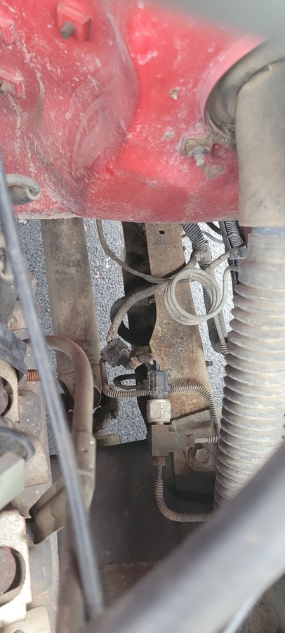

I was able to get a picture of my truck's BPS. Is this the recall harness.

Here is a closer picture.

That looks like the newer Brake Pressure Switch. Hard to tell if that is the recall harness or not. The harness may be an aftermarket version without the blue sticker.
Here is a Standard brand harness and BPS on Amazon:
Amazon Amazon
Looks like the one on your truck.

Yes, that's the first recall harness
There was a second on my 1994 E150 van
One day I was down there and they came running out with a new harness (with 2 fuses this time) in the harness
They replaced mine for me (again) and let me have the old one for parts
