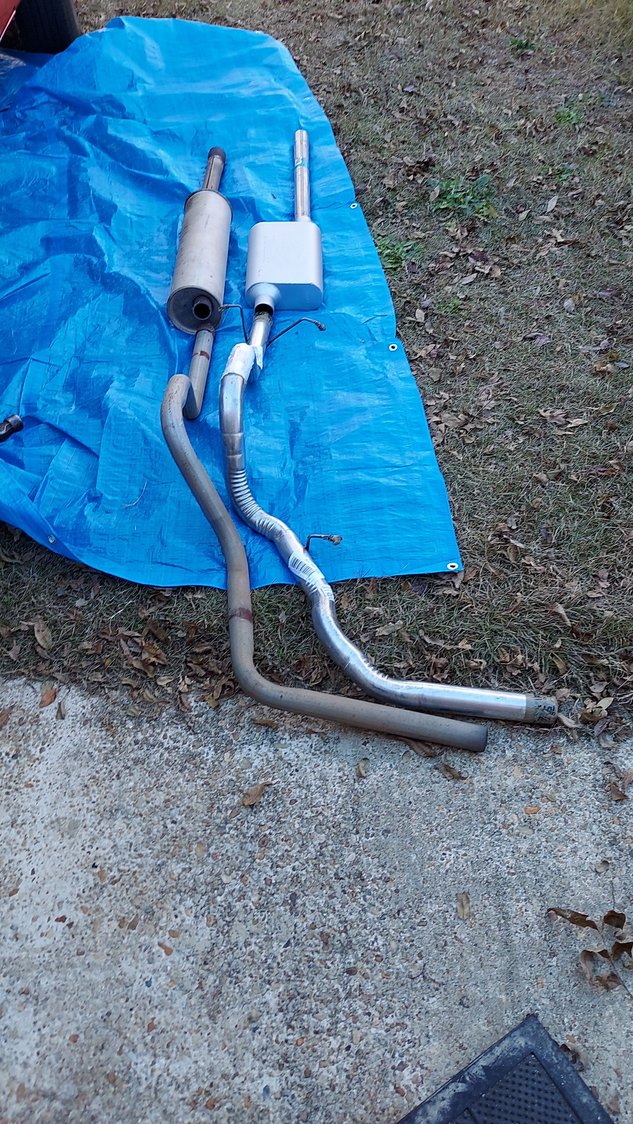

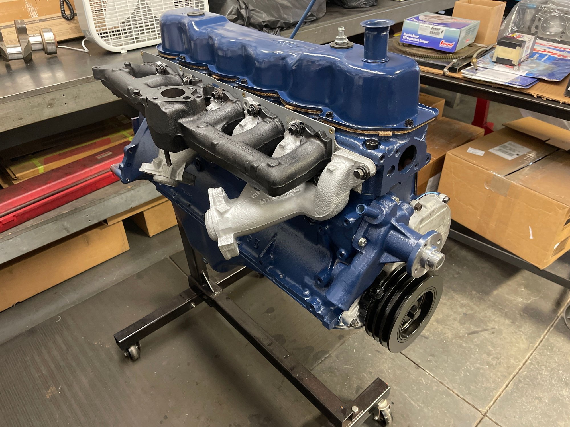

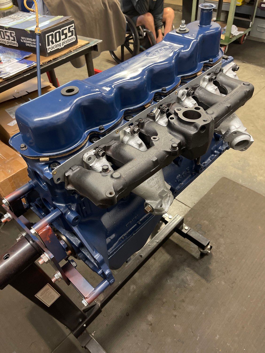

I have a 1983 Ford F150 with a 1987 4.9 L Carb’d engine in it, fully rebuilt and basically new. It is not a fuel injected as the modifications to make the 1983 truck To the fuel injection would have cost a bunch to my understanding. I’m not a big time car guy but have been helping my son redo his truck. He’s 16. So it’s a learning process for us both and I get to teach him the importance of old trucks and engines and stuff what I can.
the old exhaust system was terrible, holes in the muffler, exhaust leak in near engine compartment, nasty looking Cat, now the engine we got luckily from the machine shop as the engine in it was actually a 1968 240 from what I’m told so we got a 300 from the machine shop basically at no cost. I wanted to redo the exhaust since engine is out and it can be done. But I’m on a super super tight budget and cannot afford an expensive cat converter. Now prior to use doing all this engine stuff all the emissions was removed from previous owner. I don’t have any in it. In my state they are not required for smogging purposes. But the cat I think is required, but so dang costly. I’ve read they are bad for increasing back pressure on the engine and costing on fuel milage. I guess I’m trying to find out can I go without a cat? Is there negative affects on the engine without it. I’ve read this truck doesn’t have to have it in my state with antique plates. I’m not for or against them or anything but I’d like to know it I must do it or if I can go without it due to my extreme budget costs. Will it hurt the engine without it? Or be no biggie. I know all the benefits as far as reducing emissions I get all that so don’t get mad at me thinking I’m just trying to eliminate it just cuz. I’m simply trying to figure out if I can be without it for engine purposes only, will it hurt the engine? Hope that helps. The rebuild cost way more than anticipated and I cannot afford a 200-500$ cat right now. Any help would be great thanks yall

You did not say if you are running the stock log EXH manifold and EFI manifolds for a little more power as they flow a little better than the log.
I run the EFI manifolds with a replacement Y pipe. Y pipe came with the cat but I did not use it.
When my muffler went bad, inlet pipe pulled out, I went with a 94 F150 system for a 300 motor as the pipes are a little larger than the 81 pipes.
I also went with a Thrush welded muffler that is an up grade to the 94 system.
I got 2 middle pipes because I removed the cat and the 94 tail pipe.
If you can swing it get the 94 middle pipes, muffler and tail pipe as they are a little larger. It is a bolt in using hangers for your year.
You will need to cut the metal wire hanger from the tail pipe but that is no big deal.
If running the log manifold get the head pipe for it and adapter to hook the smaller head pipe to the larger middle pipe as they should be different sizes.
I like the rumble of the Thrush welded muffler but I dont know if you would get the same sound, no not loud it is deep, as you have the log and I have EFI that are like shorty headers.
Other reason I also went with the 94 besides larger I can hit any parts store and order the full system for replacement.
