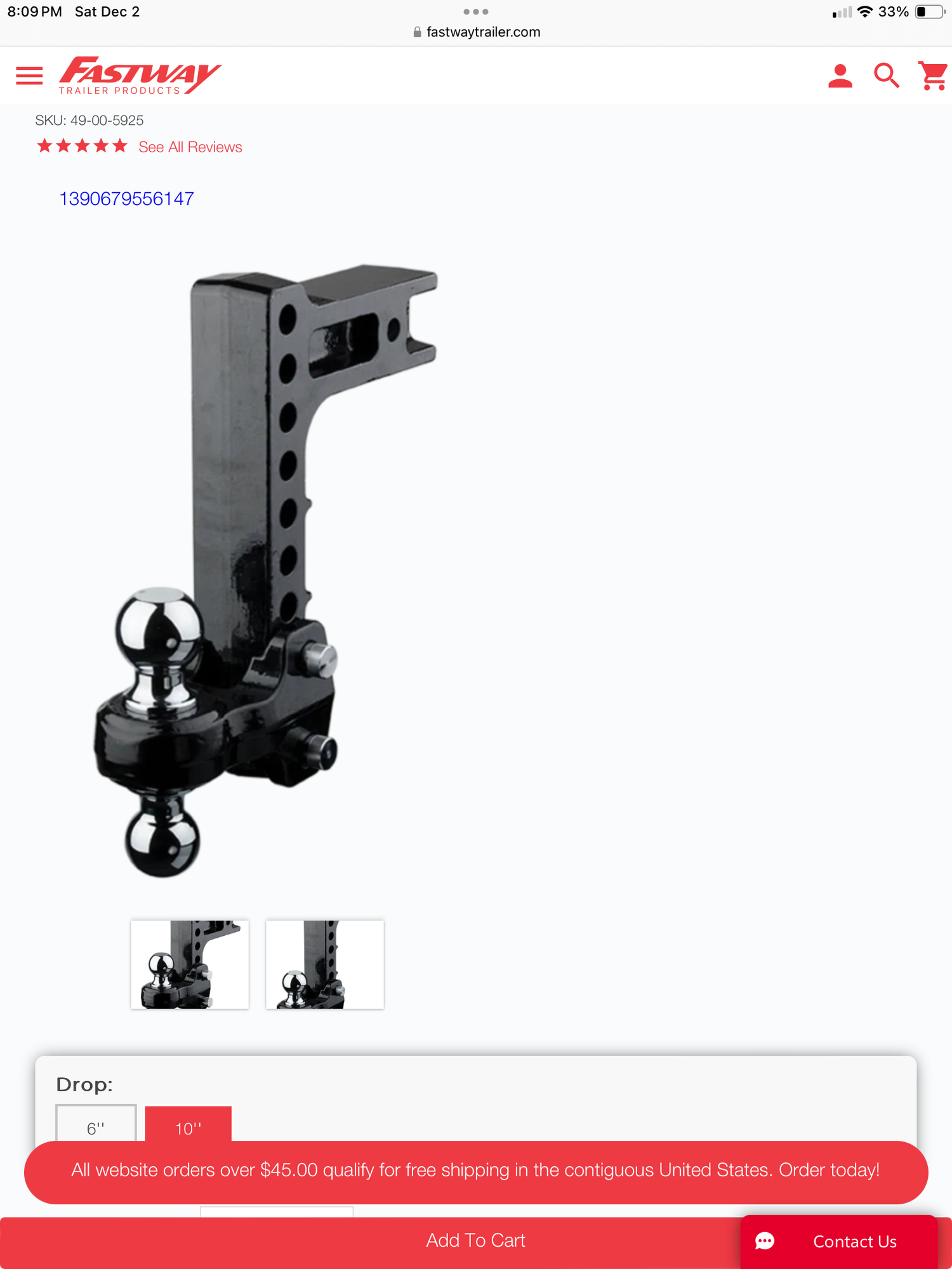

With the new truck having a 2-1/2” receiver, I’m selling all my 2” ball mounts on marketplace and picked up a Fastway HD 10” drop. Delivered yesterday. Thing is a moose! Rated for 20k. One ball mount for any situation I’ll run into, not counting the WDH for our camper. Would not be afraid to mount the strap to it to pull someone out.(Edit: With the ball set at lowest drop (top most) position.)
