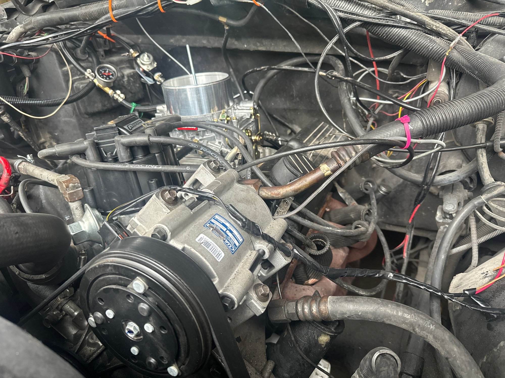

**UPDATE to the update… started running rough again…so I got fed up and bought an edelbrock intake and threw an edelbrock 650 cfm carb on it and it runs better than ever….i took all that EFI junk off the 302 and it loved it…still gotta clean up my engine bay a tad bit….
I know the hat is upside down I need longer hardware to make it work the right way 😂

I see multiple issues, 1st being your plug wires are crossing eachother at angles which could cause cross fire , they need to at least be spaced apart (You can do this with zip ties or plastic guides) where they must cross.
I also see bad hose clamps for heater hose applications
And that HEI gm style distributor, where is the vacuum advance pointed because I think you can restab it in order to place the can at a better spot if yoyu have clearance issues.

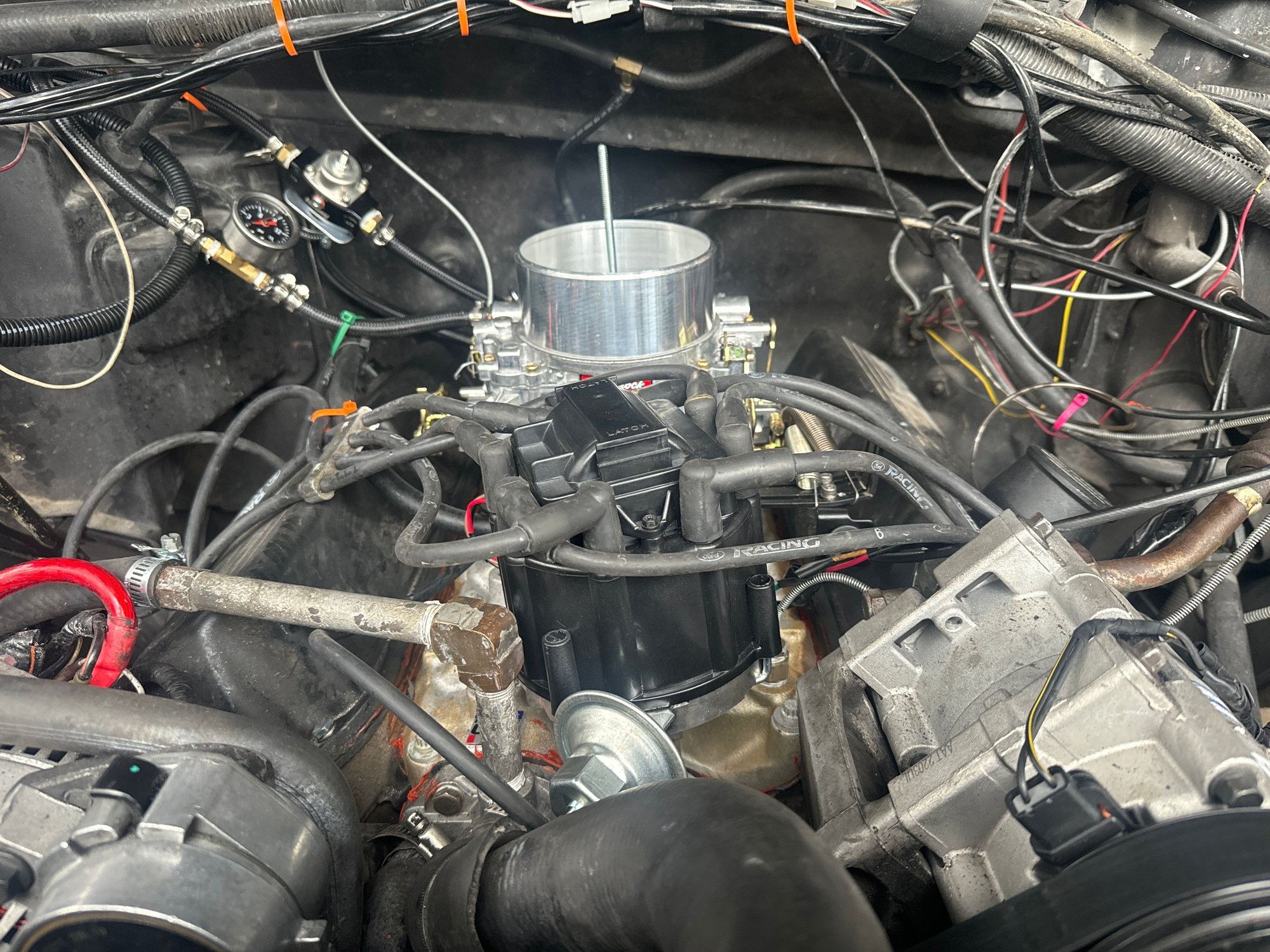

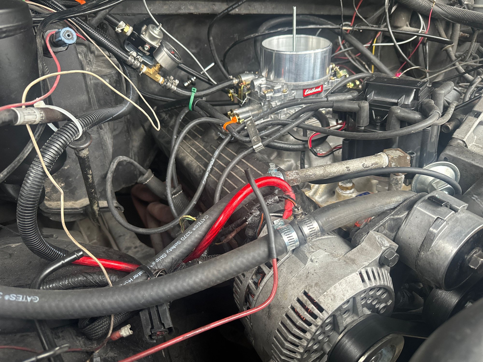

Bette
better picture of my setup I know it’s a mess right now I just got it completed this last weekend. I got new spark plug wires on the way tomorrow…any other suggestions/ideas/help? Im kind of freestyling this but my truck has been running very well since I made the change from EFI to carb

so you see that copper elbow you have on the heater core water outlet there? You should get rid of that. copper in an aluminum/iron system especially touching directly to rusty metal i cant imagine is a good idea for the vehicles cooling system.
