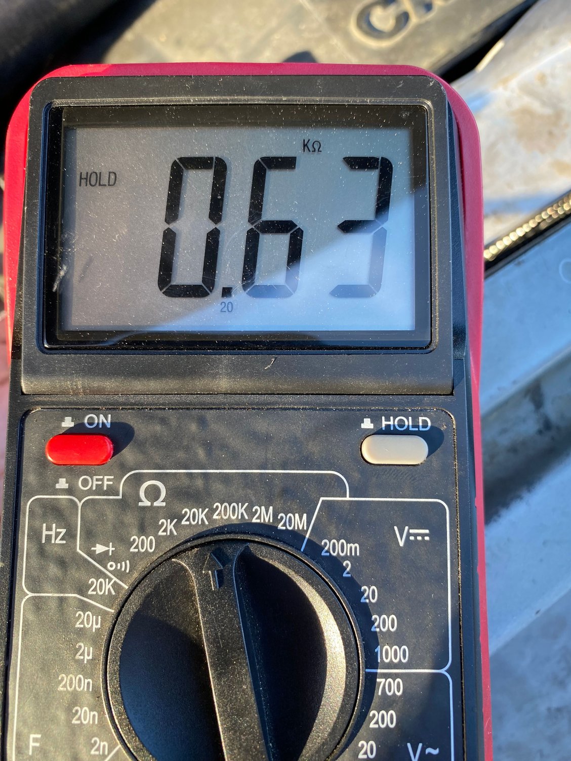

This is the EVP and signal return

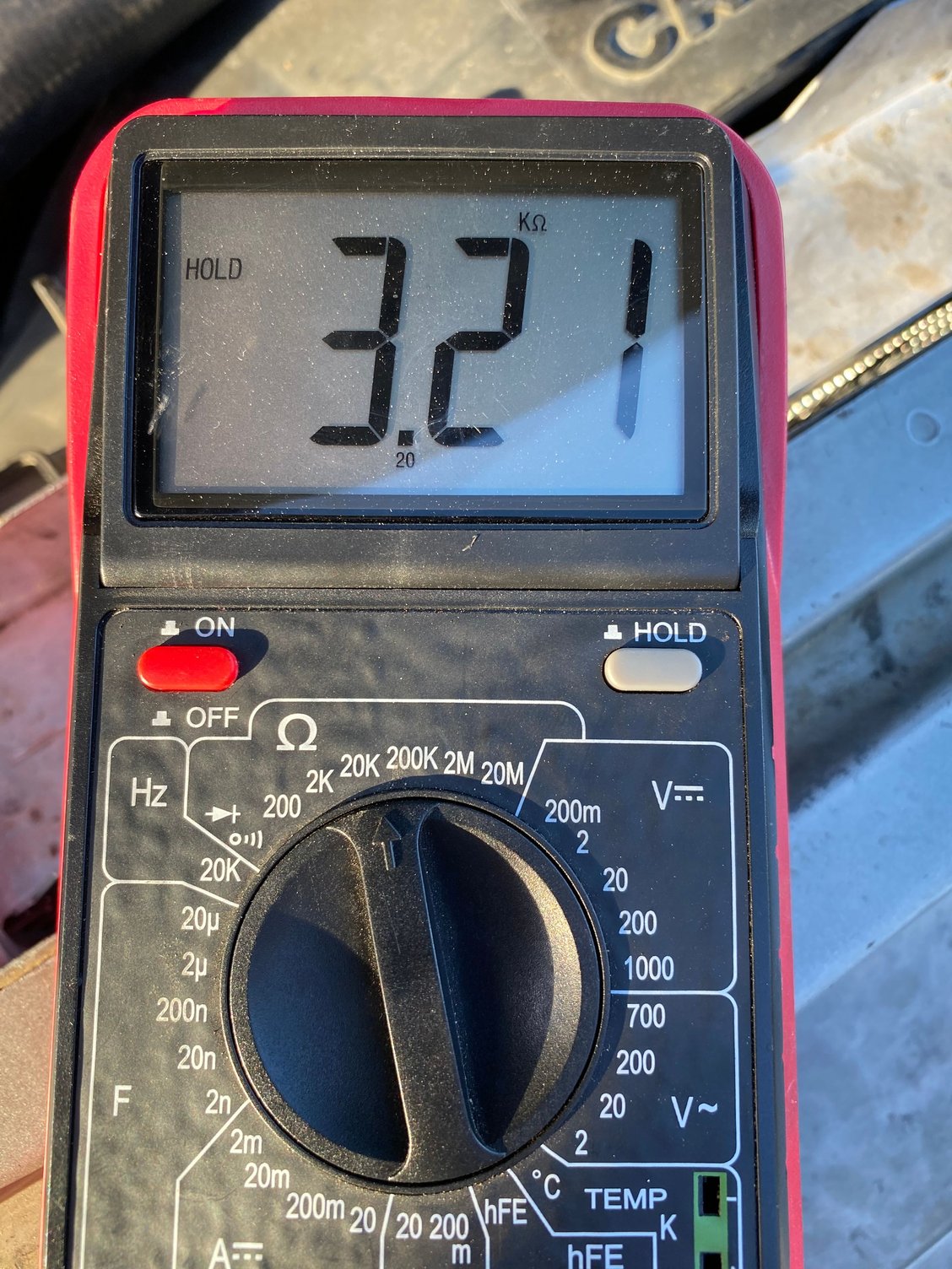

When I set it to 20k this is the EVP and vref reading
The EVP read when I set it to 20k but not 200.
So now I need a EVR since it wouldn’t give the EGR vacuum?

I think you need a EVP sensor because it's dead
The EGR valve will get it's vacuum from the EVR regardless if the EVP sensor works or not
