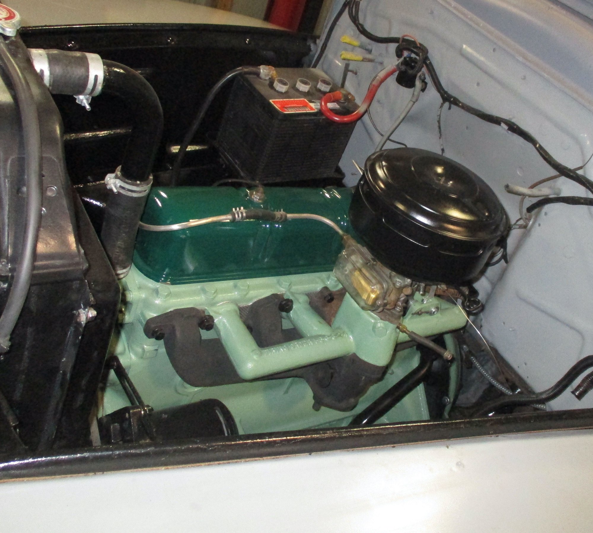

A straight 6 can look cool and does fill out an engine bay just fine too:
I was able to have this engine rebored and completely rebuilt for apparently about what a "control pack" costs for a fancy modern engine. My advice would be to not overlook the option of going back to a stock drivetrain. Just because your truck is missing its engine and transmission doesn't automatically mean you have to go with something newer. A stock drivetrain can get the job done for you--and with some style too--and your truck will be back to the way Henry intended it to be. You may even save some money.
Good Luck.
Jim
P.S. I forgot. I get about 15 mpg--not great but maybe better than some.
