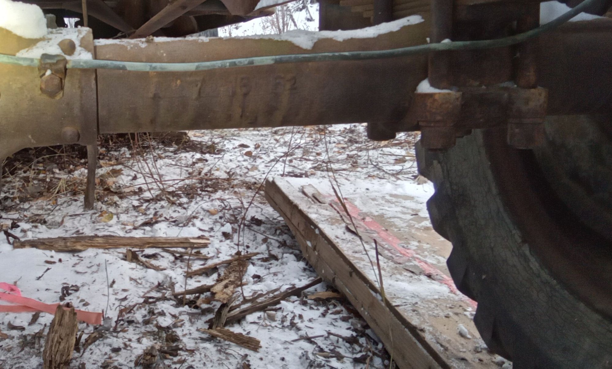

I don't believe it's lifted but here's a picture of the rear springs, is that how they are supposed to be?

Not an F3 expert (or in anything else) but that certainly looks like more spring than stock.

yeah same here but it still needs a 2-3" lift with blocks to look like a mudder.

You have a later axle with the 12" Bendix brakes. The measurement refers to the diameter of the brake shoes, and if you were to pull a drum and measure the brake shoes, you'll find them to be about 12" across. The good news is your brakes will take later 16" rims and you can be rid of your 17" widowmaker rims. The 14" Lockheed backing plate looks like this...
The numbers cast into your axle housing is a casting date code. Probably safe to say it's original to your truck
This is the adjuster hole plug, and the number on it is the part number.
