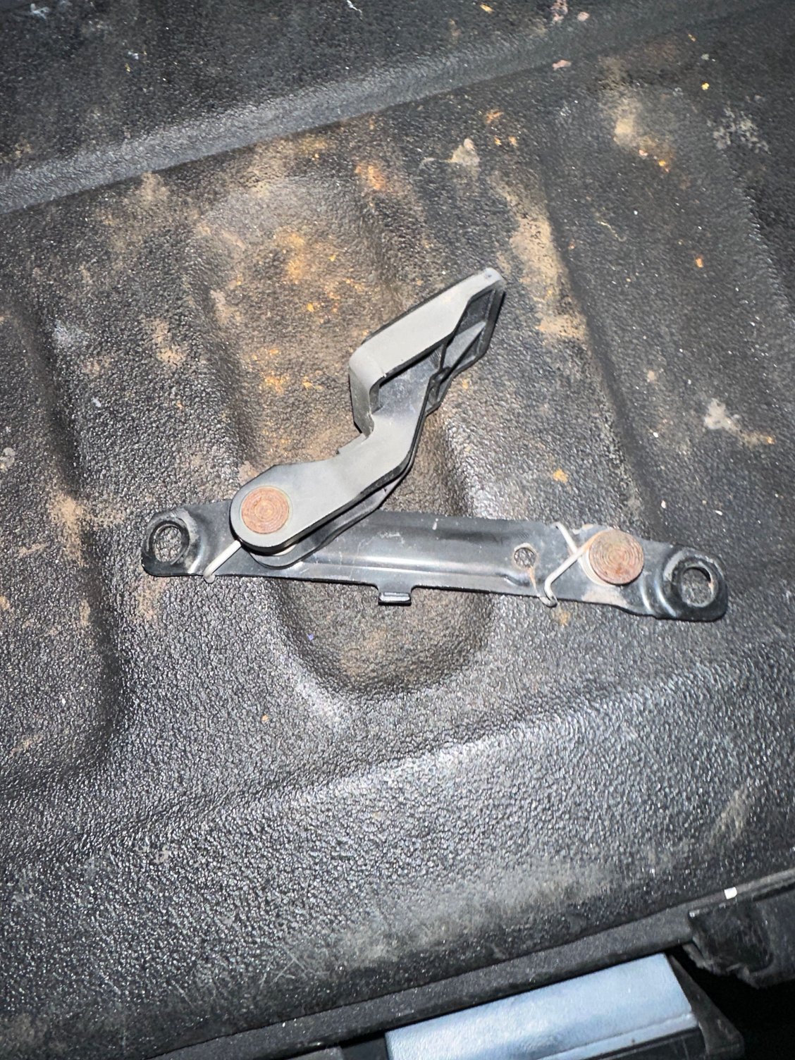

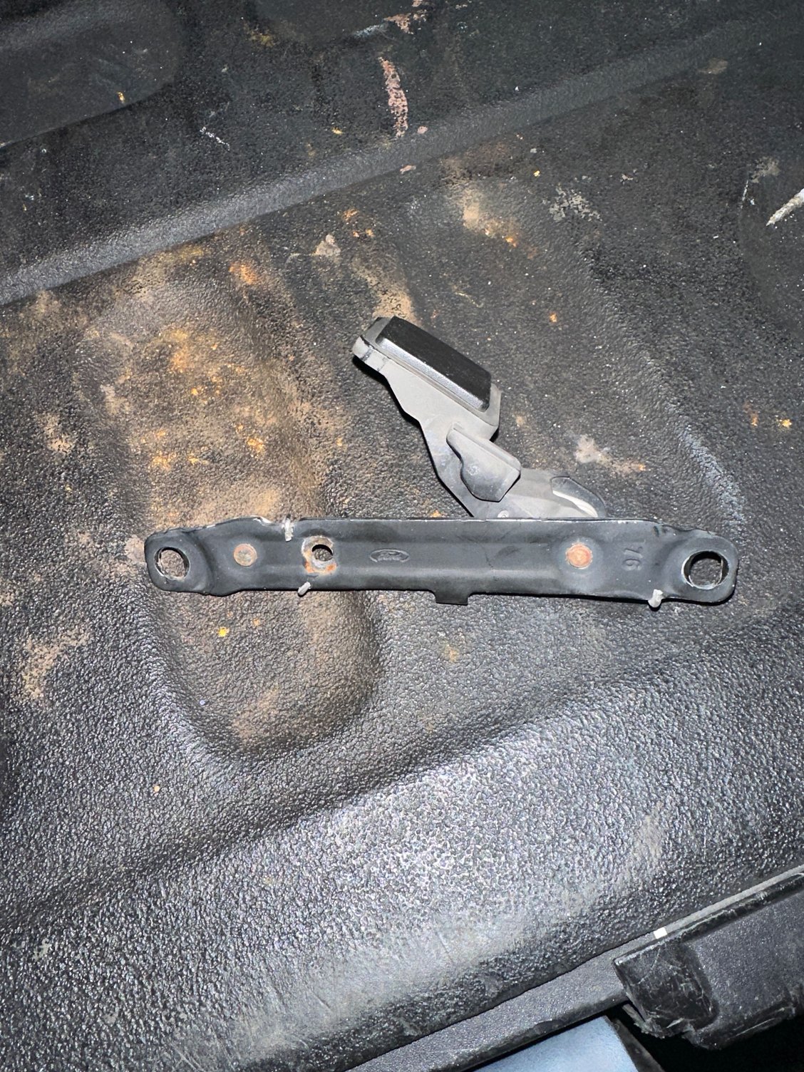

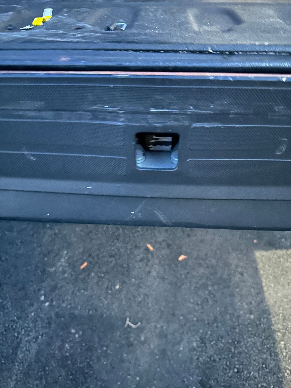

Does anyone know what the part number for the part circled in the diagram? It’s the button to release the step. I bought mine broken I’d like to get it fixed finally. Thank you!

This is the part number i found and successfully used to repair my 2017 F350 tailgate latch.
HC3Z9943170A
