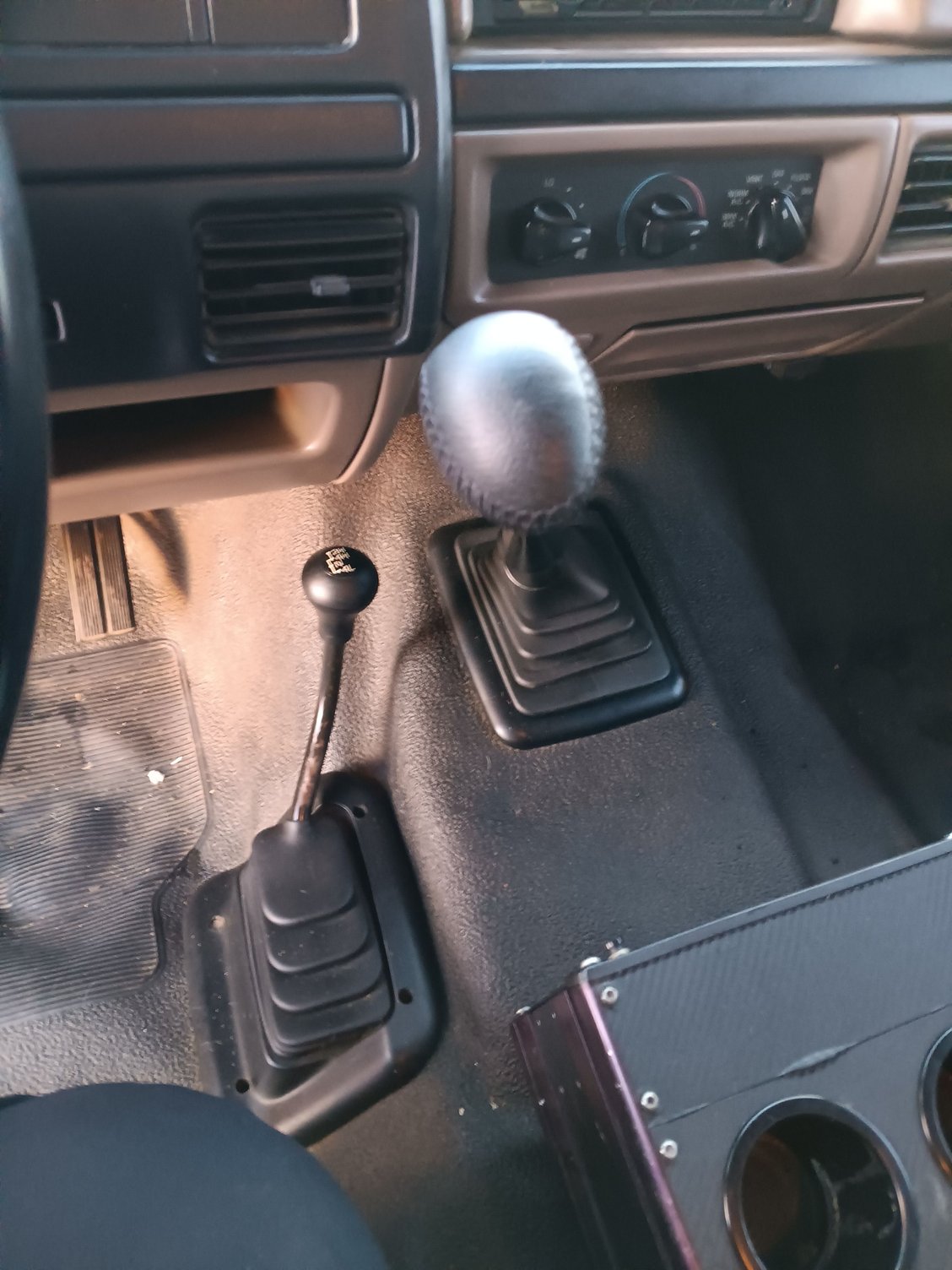

Got a guy coming up from Utah to deliver a 96 xl bronco to me... getting it in a trade deal. Had a 5.0 and zf Trans swapped, but also includes the original transmission, which I believe would be the m5od?
