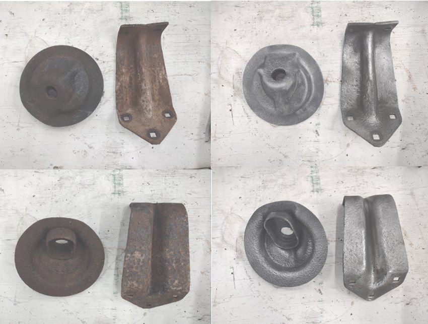

I like using the phosphoric acid based products for removing rust. I've used them on large sheet metal parts that I don't want to blast for fear of warpage. I did the roof on my 1937 Buick Buick and with a little work and patience I got the rust out of the deep pitted surface rust.
Over the years I've used Krudkutter brand, a Rustoleum brand phosphoric based product. It was the lowest cost product I could find. I bought it in the spray bottle and also in a gallon jug. I can no longer find it in the gallon jug what was ounce for ounce cheaper then buying it in the spray bottle. My son is a dairy farmer and uses different chemicals to clean his milking equipment and most contain some kind of acid. One product he uses is Milk Stone Remover and Acid Rinse. The main ingredient is phosphoric acid. It has by percentage, about twice the acid content as the phosphoric based rust removal products but cost less than half of the one offered by places like Eastwood. It does have a bite when using so you should take the proper safety precautions you would use when working with acid.
These are two parts from my Buick that were very badly rusted, very deep heavy rust. I left them soak in the acid for a couple of days and with a little work with a wire wheel on my angle grinder they came out very clean with not rust. They are heavily pitted because they were so badly rusted but the deep pits have no rust.
Old Nov 25, 2023 | 04:42 PM
bobbytnm's Avatar
bobbytnm
Roast em' if you got 'em
Joined: Mar 2005
Posts: 22,013
Likes: 9,953
From: Rio Rancho, NM
Great info Bob!!
I'll try to remember that when I get back to work on the roadster
