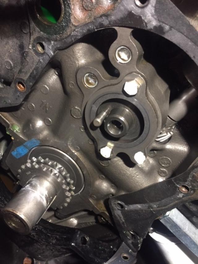

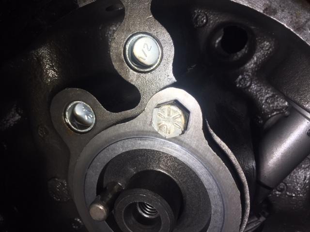

Posts: 1,388
I'm sure leak was from timing cover/crank seal which has a slight grove worn in, see pic. Oil leak was bad though, after cleaning all off and several mins of idle oil was leaking. This leak will have no bearing on oil pressure though?

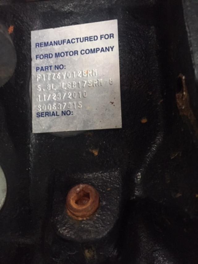

I did try another gauge with same result. After engine idles down pressure drops to zero and begins to make sounds from pass side top of motor which goes away with pressing accelerator. I realized this after installing new exhaust with no more leaks. I drained oil, which looked fine. Motor has a canton oil pan, windage tray and pickup installed which takes additional 2 quarts which would total 8 quarts.
Motor was rebuilt for Ford, see attached pic.
I guess at this point motor needs to be pulled and bearings, pump inspected?
