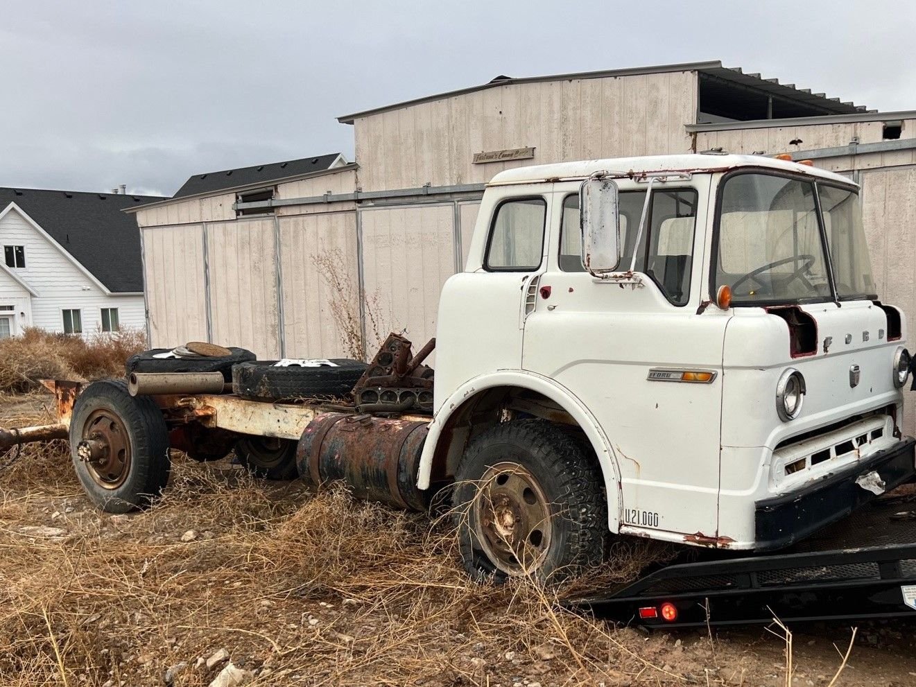

Hey all, just got my hands on what I think is a 1971 C 500. Need some Vin decode help and I am looking for any information anyone has on getting rid of these split rims! Thanks all!

Looks like you have a couple different wheel types. The ones with the split locking ring are safe and serviceable. I can't tell if you have any actual widowmaker two piece. More on that later.
C50 = C500, '70 & '71
C = 330 2V MD FT gas V8. (cast 360 crank with small crank nose, FE 1/4" oil pump drive and distributor, and other FE items)
V = Kentucky Truck Plant
K14983 = 1971 numerical series, September 1970 production
153 = 153 inch wheelbase
J = Rangoon Red
C503 = C500, 19,000 lbs GVWR, '70-'71
4A8
4 = Black Vinyl
A = Ford use
8 = Standard cab without sleeping compartment
A = New Process model 435 four speed transmission
423
42 = Rockwell model D100 Single Speed Rear Axle / 6.20-1 / 13,000 lbs. Rear Axle Capacity
3 = Ford front axle, 6,000 lbs capacity, without power steering
19000 = 19,000 lbs GVWR
164 3800 = 164 Certified Net HP @ 3800 RPM
73 = Salt Lake City District Sales Office
No special order--purchased from dealer inventory.

Just picked up this truck for $200 and I think I want to build a big heavy rat rod style truck. I have a few questions that I have found some halfway answers to, but am turning to all of you for some help. What do I do about those split ring wheels? Has anyone done any engine/trans work to get these things to freeway speeds? Where can I find the missing windshield wiper panels? I think that's it for now. Any help or ideas is always welcome.

You have a couple different wheels there. One is a locking ring type. These are safe and serviceable but require tube-type tires.
It appears your others are widowmaker types. Read up and beware doing anything with them while they are inflated:
https://www.ford-trucks.com/forums/8...l#post19892682
Your 330 FT engine does not lend itself to hot rodding. If you repower, I suggest an automatic overdrive transmission so you can get a decent cruise RPM. A 460/E4OD combo would scoot you down the road. You'll need a controller for the transmission but those can be had.
The wiper panels and all the rest that is missing will be a junkyard search. Nothing for these trucks is reproduced and finding any NOS parts would be a miracle.
There are tons of these still in service, and many fire truck models with much lower mileage, and better condition than yours.
It's bad to pay too much for anything, but you may find out what paying too little nets you.
