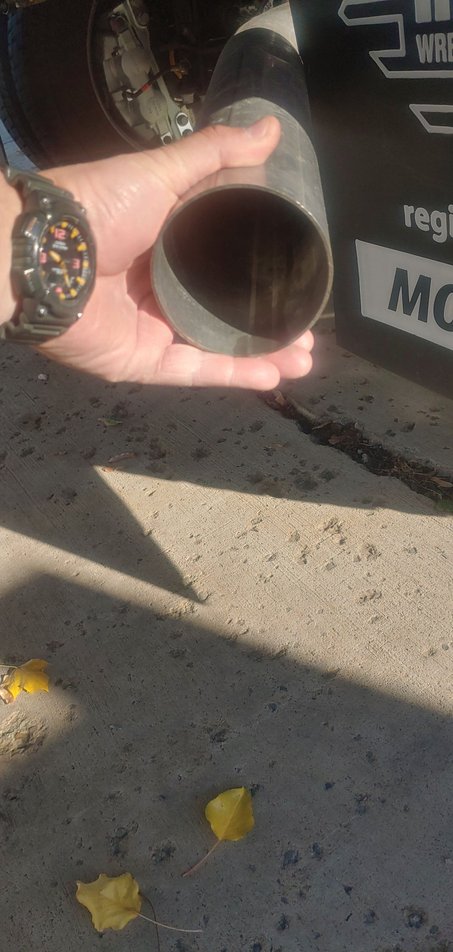

So my buddy just got a 23 F550 cab and chassis, picked it up no more than 2 weeks ago.. It's his collision shop tow truck/flat bed. This is his tailpipe... Very weird.
So different than the 250s, 350s and 450s... I'm assuming the C&Cs have the derated 6.7s. I told him about the increased DEF use. His last truck was 17 F550.
