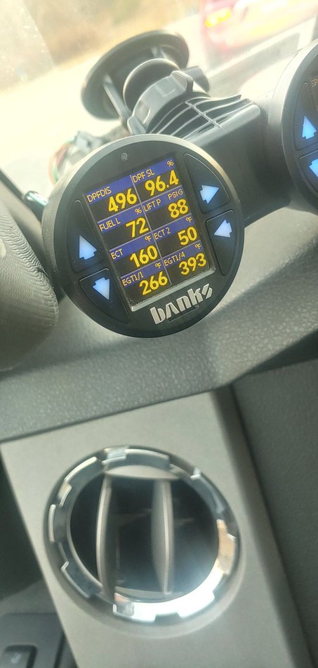

The top left PID is the distance since last regen...
"DPFDIS"

Default is 496 miles between regen IF soot % is below a threshold. It does not list hours idle, but is also factored in. Because of this, I did the forescan switch thing and enabled the auto-regen off check box. Now I regen when the idash says 100% and WHEN I have 30+ miles to drive. Prior to that it would regen at random and usually within a few miles from home or work and never do a complete cleaning. Mine will get down to 4% if I pull off when the regen stops, the residual heat helps burn out the rest.

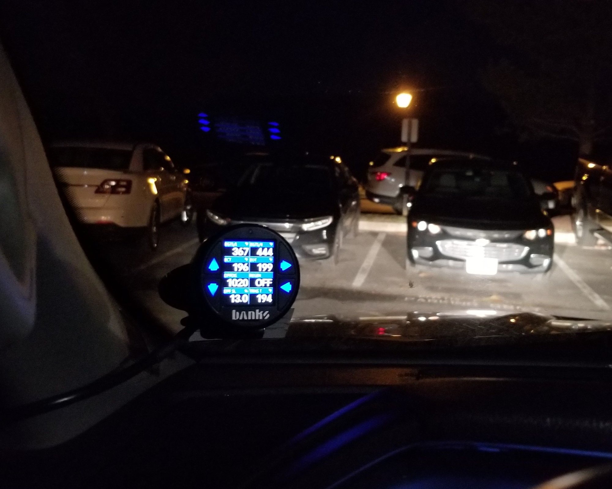

And there was only one unicorn and I sold it. lol.
here is one with 1020 miles between regens.
