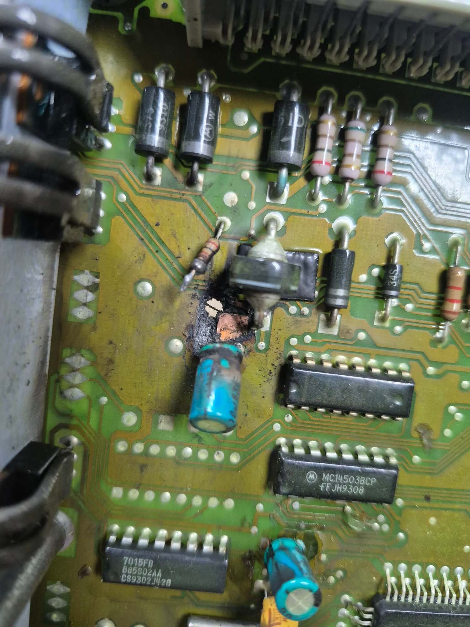

Can you post a picture of the inside of the board please?

hmmm. Truck history: Viacom comms truck in California, so it makes sense a governor would be installed. I personally wouldn't take this thing over 55 mph out of fear, so I wouldn't need the governor to be enabled...
This is what was staring at me when I opened it up after getting it back from CCE. I can get more/other photo if needed.
What is CCE?
pm me, I may have a fix for you.

Originally Posted by andreleplattenier
Car Computer Exchange, CCE, was who I had sent it to originally to see if they could repair it. I hope the fix is not to carb swap it
Did they say they couldn't fix it?? and sent it back?
Looks fixable to me.

They sent "non-repairable, unit has major damage to board from blown caps, cannot repair." So either they couldnt, didnt want to, or didnt want the hassle I figure. I'm still 9 days away from being able to send PM's so if you'd want to wait until then instead of replying back and forth on this thread, I am ok with that. Or I'll gladly keep working through it here.

That's what I thought, over here. However, I don't think that ECM just got tired and burned a hole in its resinboard. I think it's likely that some system it is controlling developed a short or low resistance path (burned solenoid coil?) that took it out. I would not want to spend $$$ on a repaired or replacement ECM and just slap it in there and turn the key, without having tested each current path for low resistance.
Now, if I had a cheap hardware-similar ECM that I could consider disposable, as a test only, maybe a parts swap is reasonable. But OP was quoted $1800 for a replacement ECM, that later turned out to be NLA, and I wouldn't want to risk an $1800 part without doing some circuit checking on the vehicle.
Armed with an ECM-to-vehicle pinout diagram, it might be possible to pin down which circuit was tied to the area of damage in the ECM. I have considerable board-level repair experience -- not with ECMs -- but I have also encountered this situation, where I repair a board and then it burns up the same way when re-installed.
