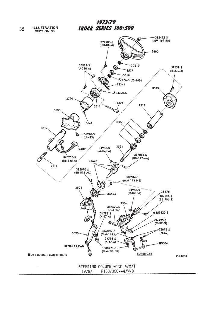

1979 f250 4x4 floor shift-- steering column. My best description is from top (steering wheel) down, there is a steering wheel and nut, then a direction signal switch, then a bearing, then 2 nuts then the steering column tube flange then an additional plastic sleeve that would uptake the spacing where the shift collar would be, ok this sleeve that takes up the area where the shift collar (if column shift and not floor shift) would be, or is. this part appears to net even be in the parts catalogs i have looked at as well as hoe does it attatch? no screws or clips, must be glued maybe. If someone would attatch a parts catalog I would be able to isolate it and determine if it was available and how it attatches. thanks.

Maybe this will help?

thanks. 3790 would be the sleave and then how would it be retained?? Thanks for the breakdown.

looks like 3641 attaches that 78/79 steering column sleeve

ok mine was all broken enough that those screws are no longer present and the tabs are gone. close examination with good light I find that it did attatch with screws. Now, anyone have that part number and where to obtain it?

That piece is probably going to have to come from a "spare parts" column. I have not seen that piece (as a stand alone item) reproduced.

So you need the part # 3790 off a 4wd 79 F150/F250 steering column, for a w/p/s, none tilt, manual trans truck. Correct? I have one parts truck like that, that still has the complete steering column in it.

Yes. The ebay listing appears to be a tilt column part but might interchange- maybe. Yes manual trans, non tilt, power steering. thanks. I will try Donald this week.

I have a parts column (that is a tilt) with the same looking collar and the only difference I see is the hole for the turning signal stalk is a little different for the t/s lever to push and actuate the tile mechanism.
