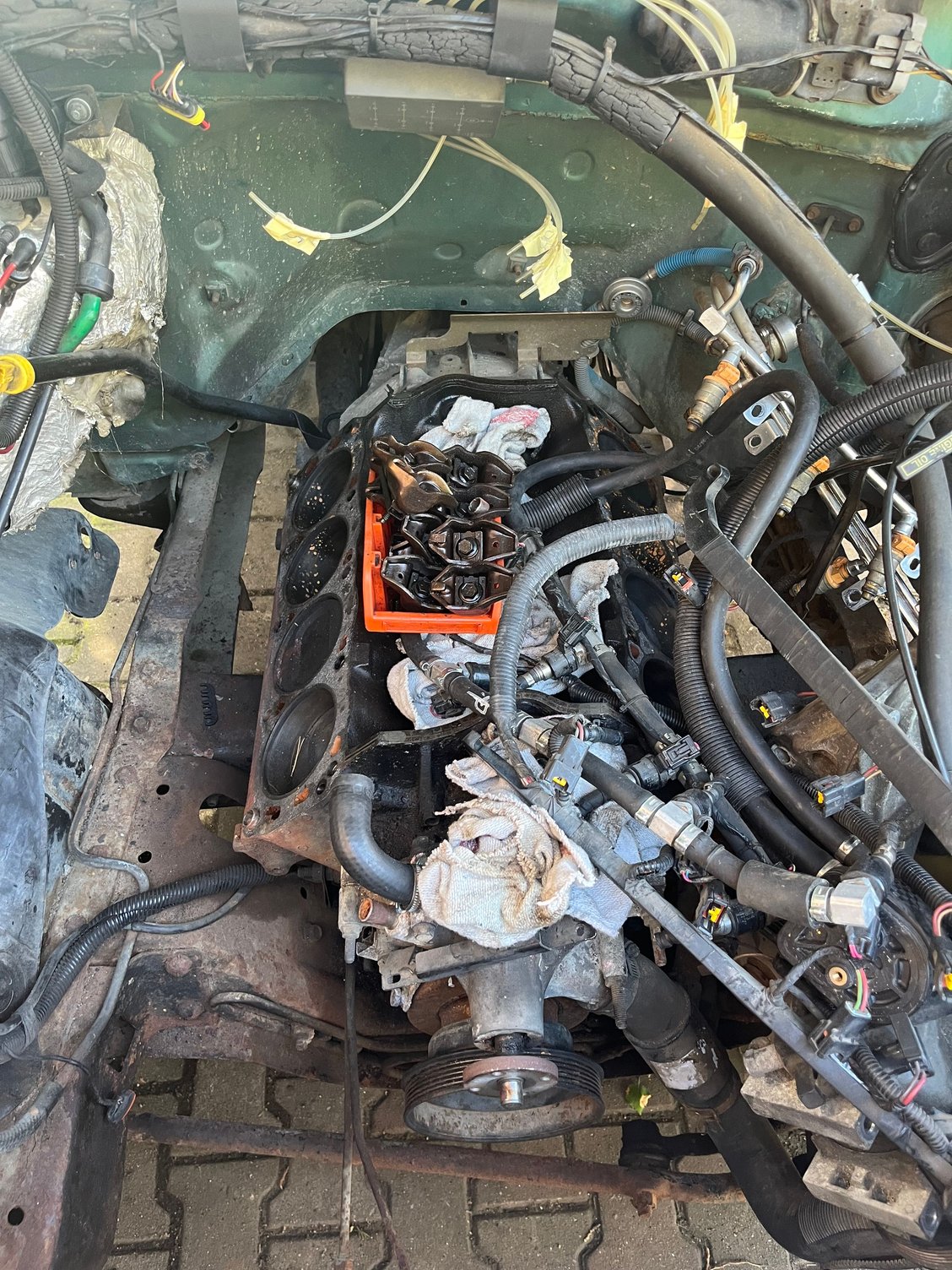

Sooo the car sits on my mechanics yard and is waiting to be finished hopefully tomorrow!
The head gasket was blown just a little bit on the passenger side , fortunately there was no fluid in the motor itself, so „only“ the exhaust fumes entered the cooling canalss and caused the engine to overheat while idling in a very short time.
The engine looks worse than it is, i got the pistons checked and the mechnaic states that there is absolutely no need for new pistons now, so the lower end of the enigine will stay stock for now.
i just got the head back from the shopw, they were completely rebuild (only what was necessary).
the heads are smooth as hell, also the exhaust manifolds and the exhaust ports on the heads were smoothed out.
No leaks, good pressure, absolutely no show of any damage (with 207k miles running for 10 years on both gas and LPG).
Head rebuild for both heads was 450 USD for now, which i am really happy with!
I just decided to change the timing chain, so i bought a timing kit from Melings, a new Waterpump from Gates as the old one isnt the best anymore and a new fan clutch.
The Valve covers will probably be painted Ford Blue
All the manifolds and TB will get cleaned, sanded and than the assembly will be hopefully done by the end of next week.
I really hope that this (not planned) top end rebuild will solve my issues and that i can finally take it for a ride

Long time no update.
I finally managed to get the car back from the mechanic.
The Cylinder heads were rebuilt. The Manifolds were grinded smooth and got a new gasket. The Manifold to pipe connection got fixed, the CATs are good and not stuck.
I also got a new water pump and a new timing kit.
Unfortunately, the above stated things did not fix my problems, not even close. My mechanic is at the end of his knowledge and does not know what to do next.
I now get the following codes:
P0155 - O2 Heater Circuit Bank 2 Sensor 1
P1132 - Lack of HO2S11 Switches - Sensor indicates Rich
P0174 - System too lean Bank 2
P0125 - Insufficient Coolant Temperature for closed loop Fuel Control
P0135 - O2 Sensor Heater Circuit Bank 1 Sensor 1
P0141 - O2 Sensor Heater Circuit Bank 1 Sensor 2
P0385 - Crankshaft Position Sensor B Circuit
I am really really angry and i would like to drive the car off a cliff.
After around 1.5 miles out of the mechanics shop, the car lacked power massively, i first thought maybe now my transmission is slipping... the enginge is shaking badly and as i opened the engine bay there was coolant sprayed over some of the engine bay...
Any suggestions what to do next ?
