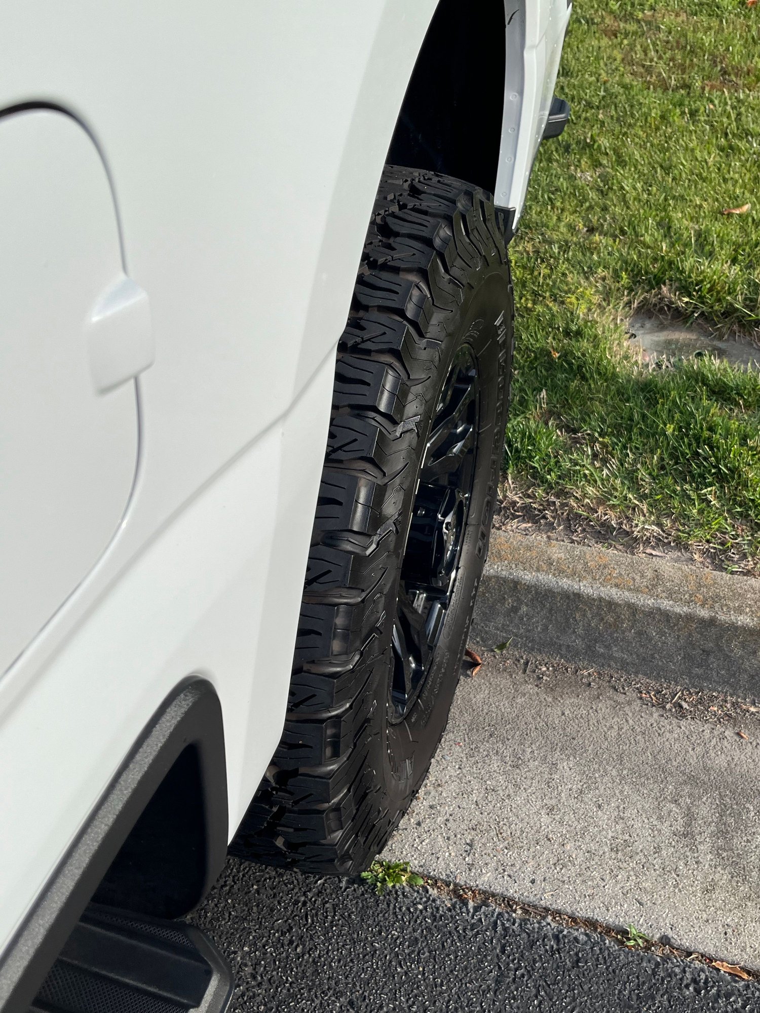

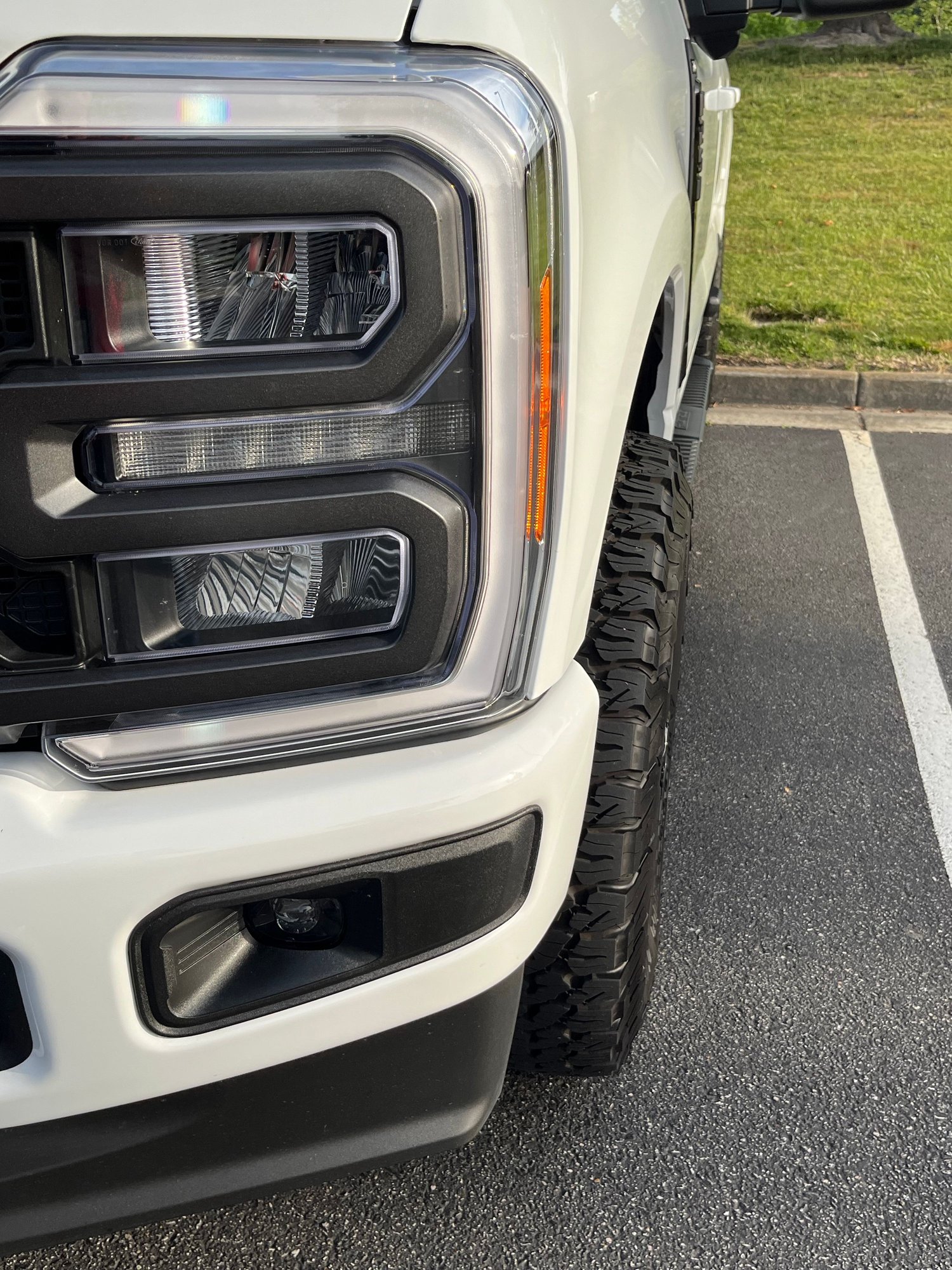

This is +18 offset on a 9” wide wheel with 12.5” wide tires. They are 17x 37 but that shouldn’t matter much or at all as far as stick out.
Factory tremor style flares

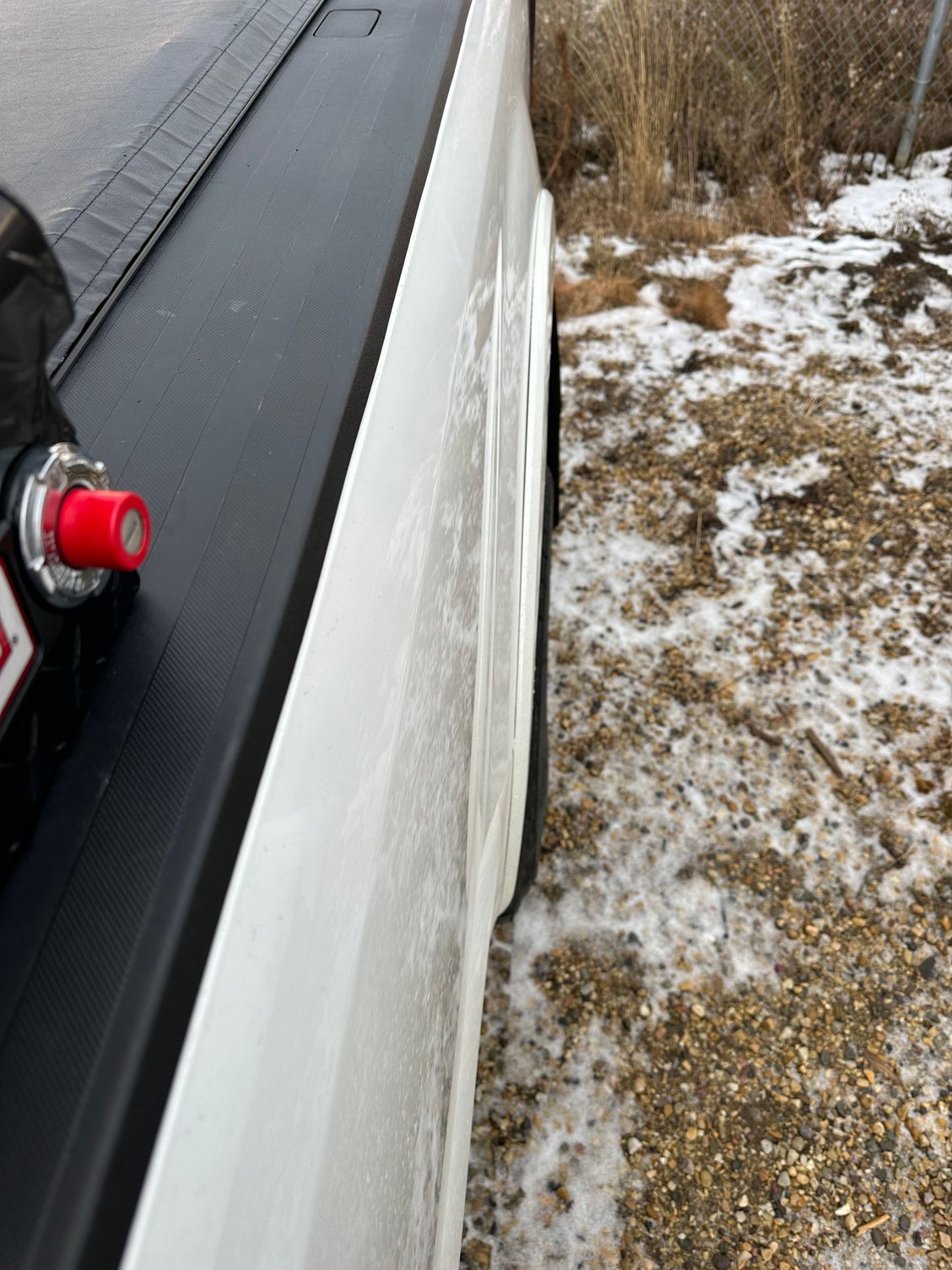

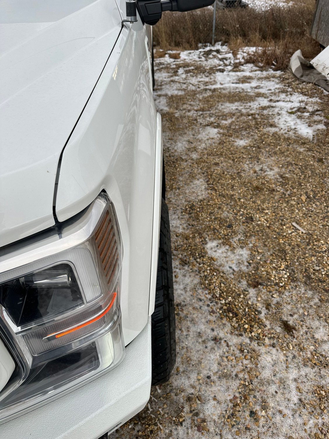

Buddy's F250 Tremor with factory 18x8+40mm Tremor wheels and 285/75-18 tires, truck does have wheel well lip moldings.

The pictures Jay posted are the look I'm after, so it looks like 18 is the magic number.
