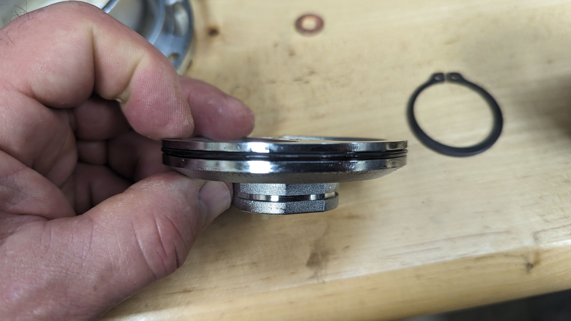

Milemarker 549 Hubs
I recently decided to dump the mostly plastic factory hubs for more robust aftermarket hubs. The two options for my 2017 are either Warn or the Milemarker 549. I hadn't heard much about this model Milemarker hub and had used Warns in the past. I bought both from NAPA so I could compare the build quality and planned to return the lesser product. The Milemarkers were about $100 less expensive. After examining them both, the Milemarker trounced the Warn. The outer face and dial are stainless steel vs pot metal on the Warn. The Milemarkers don't use a cage for the two cogs. Instead they use a set of beefy beveled engagement teeth. If you have a newer Super Duty and are looking for a higher quality set of manual hubs, I can highly recommend the Milemarker 549.

Can you post up a couple of side by side photos

I've already returned the Warns.

Those do look beefy.
thanks for posting
