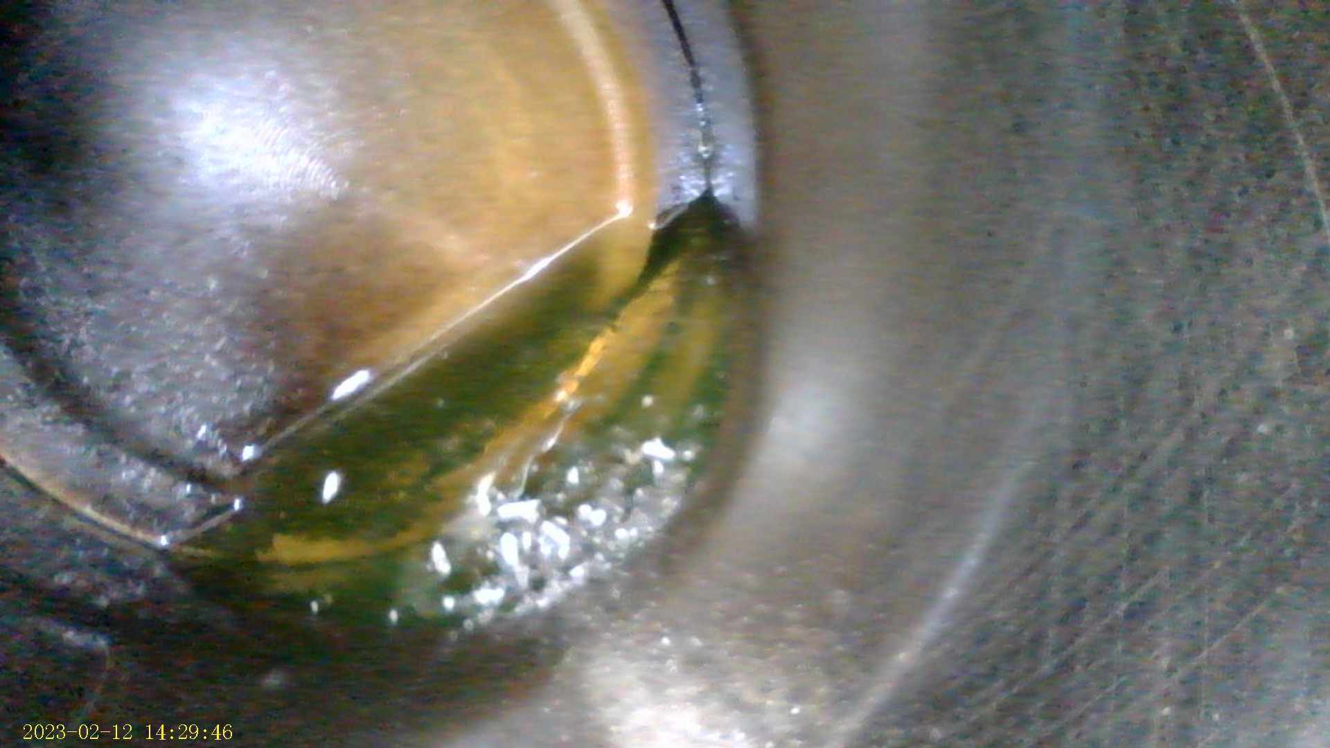

So I have hg
ad codes P0304 and P0316 on my 2004 5.4l 2V. I replace the #4 coil, injector and all new plugs and the code keeps coming back. Truck has a mis when started for like 30-60 second and goes away. I did a compression test on #4 and got 160-170psi. Put the scope down and found most of the piston clean as can be. "see photos" I am now guessing I have a head gasket leaking coolant in to #4. What are your thoughts? Thanks

Yeppers, that sucks as it sure looks like coolant to me. At least you can still see the cross hatch marks from honing.
